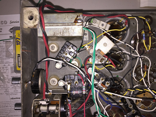

My model 89 came with a replacement on/off switch and no connection for changing bands. I have obtained a replacement switch and need to know where the band switch connections need to be made. As you can see most of this chassis appears unmolested except for the switch.

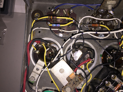

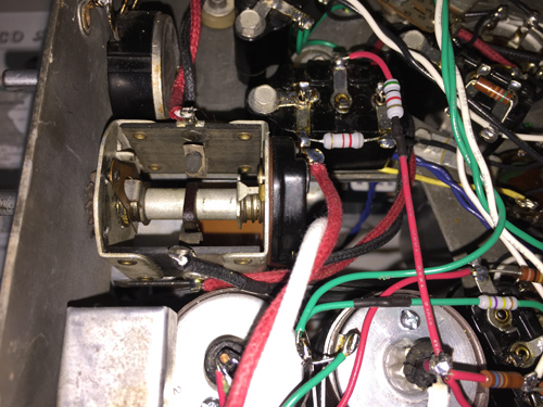

Jim, here are some photos from my 89 that should help.
Dave Thomas
Coatesville, PA
Thank you Dave, those will be very helpful.
