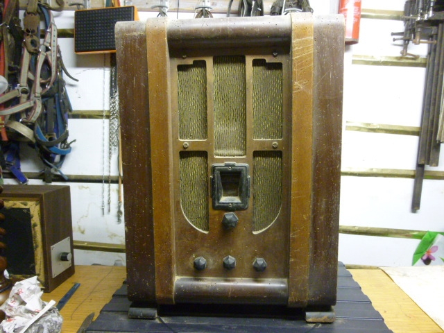

Hello , Sirs , good evening from France Icon_biggrin
One of my friends found this radio st

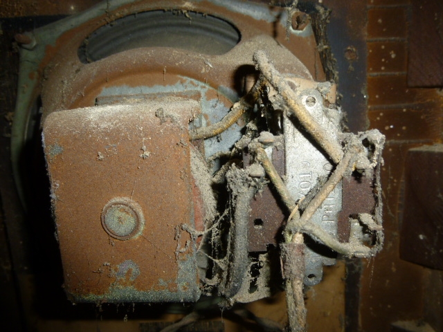

No logo , no inscriptions , but we can read " Philco " on the back of the loud speaker !
Is it really a Philco one or not ?
Thanks in advance for help Icon_biggrin
The knobs are clearly Philco.

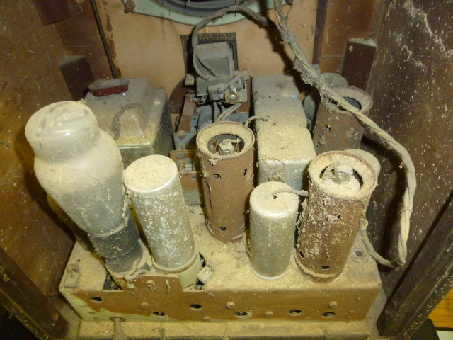

The tube shields are also Philco style.
The rectifier tube is mounted in a weird fashion: it seems to be in a place where usually the second electrolytic cap would reside.
It is nice that the grill cloth is intact - try to preserve it.

But I have not found it on the philco radiomuseum gallery , perhaps I have not seek with enough attention ?
Which year do you estimate it ?

I hope the speaker is OK, plus it seems to have the shadow meter, which I also hope is OK.

About the shadow meter , it seems looking like same or quasi same I have on the chassis of my console .
For the cabinet , this one seems to be a lot worm eaten , as many small holes are visible
So , first after cleaning it a bit , is to process it with a product against those insects , and after plug the numerous holes !
Woodworms in small cabinets like this one are easily destroyed if placed for a day or two in a freezer chest.
I cured a vase that I brought from Haiti, which was infested with one of those. I have a freezer chest, so it went there and that was that.

I just noticed the output transformer says "Philco" on it (kind of hidden by wires). Almost certainly some kind of Philco.

Sure looks like a Philco and if I had to guess at it I'd say a model 60 or 66. That would date it abt 1934 or so. The large tube at the left rear corner has been added. It should be a second electrolytic cap there. The rectifier tube is just in front of it, a #80 tube. A lot of these European set have little documentation here in the states. Cabinets are different looking and chassis are similar sometimes. The 60 and 66 chassis look the same from the top, the easy way to tell them apart is the frequency coverage. 60 only tune up to abt 3mc the 66 abt 12mc or so.

I would guess 1936 or 37.
These knobs were in use from 34 to 46.
If the radio is a relative to 60 or 66, it got the shadowgraph that those didn't have.
Except for the escutcheon, it looks very much like a UK Philco model 265 from 1935.
http://www.philcoradio.com/phorum/showth...?tid=15019
(scroll about 1/3 of the way down the page to see a picture)
And since the black and white picture is a factory illustration, it could very well be that production sets had escutcheons like yours instead of as shown in the illustration.

For Ron : on the illustration , I read " model 264 " baby Grand " , why do you tell 265 ???
It appears the page model is existing in radiomuseum site , but without any photo ... so it was impossible to make relation !
Radiomuseum presents two models , one from UK and one from The States .
I ' ll ask my friend to verify if the tubes set is OK with the page model , except the left tube as, as said Ron , which was at evidence replaced .
