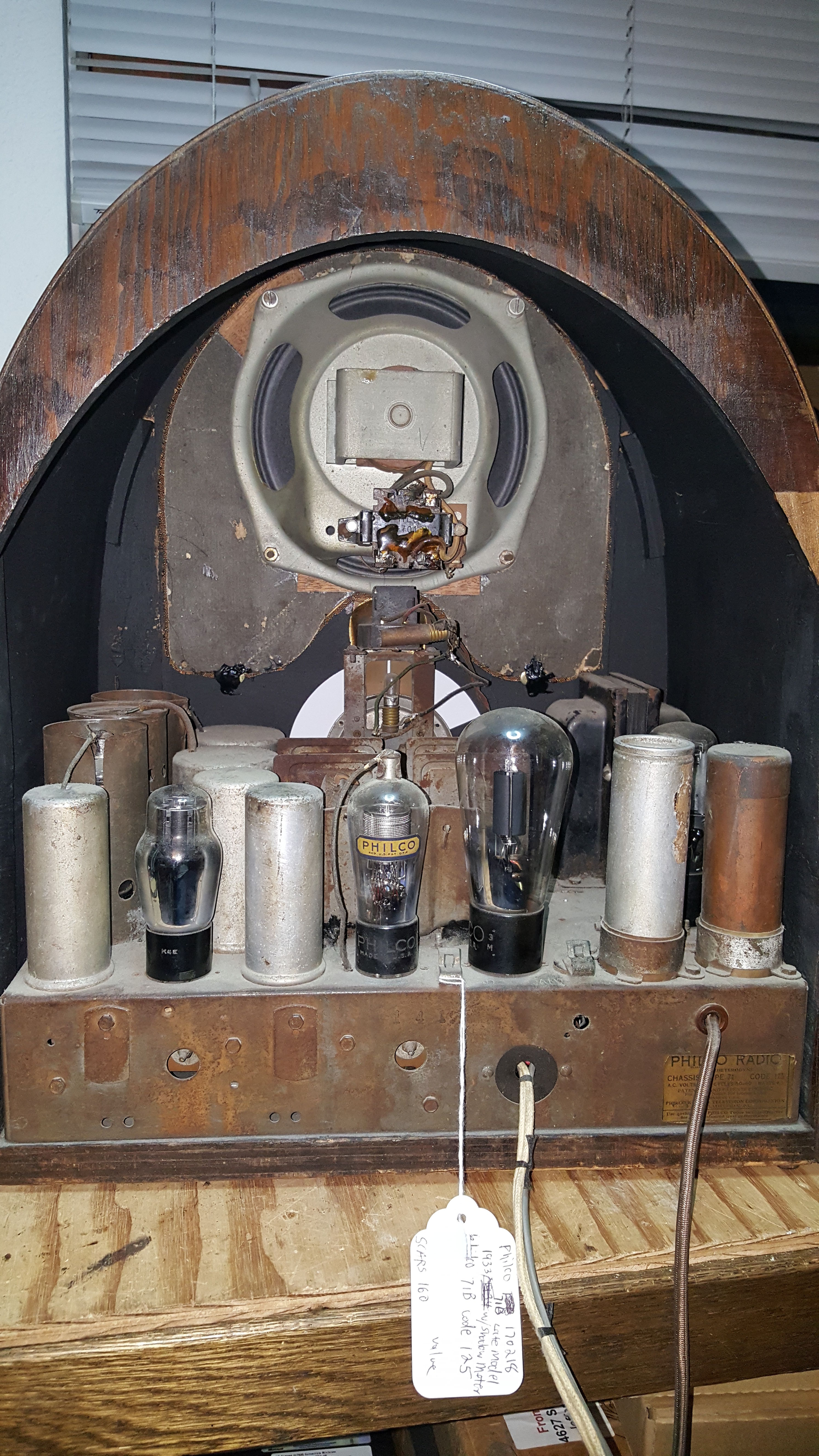

I know this is an old thread (I started it the first time I looked at this radio, which I bought in 2017).
Anyway, I know I've talked about this radio elsewhere, and now I realize it should have been on this thread.  This is the one with the shadow meter that I had to rewind (my first coil rewind, and I'm happy it works!), the rusted out chassis I had to sand, grind, wire brush and paint, and the tuner assembly I had to replace.  (A can of Rustoleum hides a multitude of sin!)
So, I've got it working now, except the audio stage howls, which I suspect is plate to plate interference between the first audio amp (39/44 tube) and power output (42 tube).  I can see the feedback on the grid of the 42 and the plate of the 39/44 but not on the grid of the 39/44, so the RF parts look good.  Placing my hand between the tubes affects the feedback, and sometimes I really have to mess with it to get it to howl, but even when it's not howling, the audio is distorted, and the scope shows very high peaks in the audio, seemingly at higher frequencies.  So, shield, right?
However: This is the newer chassis (Code 125) with individual shields over the RF / IF tubes, and there is no shield around the first audio, and no ring on the chassis where one would go, like you see on the Code 121 chassis.  Makes me think Philco decided not to shield the first audio.  So, what the heck did they do then?
So, I'm wondering how did Philco deal with feedback on the Code 125?  Or was there a different type of shield used that doesn't require the corresponding ring on the chassis?  If there was something different underneath the chassis, I'd like to see that also, since mine was far from original when I started, and all I have for reference is a Code 121 chassis, and my wire dress is like that one.
Here is a picture of the radio as I received it.
If anyone has a picture of an original 71 chassis with the individual shields, especially if it doesn't howl, I'd appreciate it.

You may have a microphonic tube, or a tube socket problem in the audio stage. You may have a bad solder joint somewhere in the audio stage too. Have you checked these things?
Dan, look closely at the rivets on either side of the 39/44, it looks to me like the heads are not all the way down on the chassis. I believe there originally was a shield. Temporarily place a shield over the tube making sure the shield is grounded and the grid wire is inside of the shield.
M R Radios   C M Tubes
The rivets are firm to the chassis, and the grid wire is run through one of the rivets, which is the same as the Code 121, which puts it inside the shield. I see no signs this chassis ever had a shield around that tube, especially since it would take a very deliberate action to remove the ring and reinstall rivets. People who would hack into a radio would not be expected to cover their tracks like that.
By the way, I've tried several different tubes in both positions, and in fact, both of those "balloon" tubes have been pulled to be saved for a more special radio. (The original Balloon 42 howled more than the Ken Rad shoulder tube that lives there now.)
No loose solder joints either. Experimentation indicates the howling is affected by the incoming signal (spikes in audio or loud volume can trigger it), and hand placement around or between the audio tubes.
I believe shielding is the needed solution based on that, but I would like to see how the original Code 125 chassis handled the issue if they eliminated the ring on the chassis side.
If anyone has another Code 125, 225, or similar 71 series chassis with individual shields around the RF tubes, I'd be very interested in seeing how it was done.
The picture you're looking at is how I got the radio, before I worked on it, and the grid wire has been replaced because the insulation frayed around the rivet hole, and I was losing audio altogether. (That problem, at least, is fixed.)
What I don't want is to bodge a shield that wasn't on the original radio, unless they all were known to howl without the shield around the 39/44 after Philco removed the original shield. What I do want is to discover if Philco used some different type of shield around that tube, or some other solution and see if I can find one just like it so my radio is more authentic.
I'm sure I could stick a non-correct Goat shield around my now ST type 39/44 and solve the problem, but that's not what I'm after. I really want to know how these Code 125s originally worked without howling.
