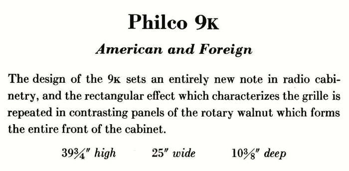

For the exterior, is there a preferred type of Howard Restor-A-Finish?  I'm not sure what type of wood veneer this unit has.  Any ideas what works best?  Walnut?  Oak?

For Howards I use the walnut color - most of Philco's cabinets are Walnut. In the case of your radio we can look to the original 1938 Philco Sales Catalog description for a model that used the same cabinet to be sure - 38-9K (it's not totally clear why your has a 37-611 chassis in it - sometimes Philco mixed and matched beyond what their catalog listed).
