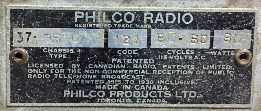

I just bought a couple antique radios from my brother-in-law. The radio that I am currently working on is a Philco 37-3640. Don’t look for it. It is a Canadian model.
The receiver  is made in Toronto and is in fact a 37-640, well documented on yout site. I have  the original schematic of the 37-3640 and all available information for the 37-640.

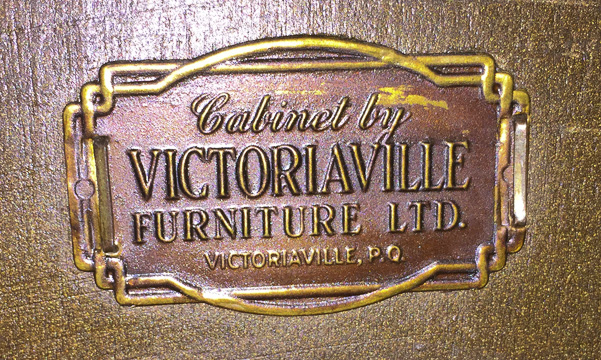

The cabinet is made by Victoriaville Furniture, Victoriaville, Quebec, Canada.  No picture on the net exactly matches this cabinet so, I will share some whem I will found how to do it  ;-)
[Image: https://1drv.ms/i/s!AqDzjKUOhlam2wbYZMxTyBMexU8W]

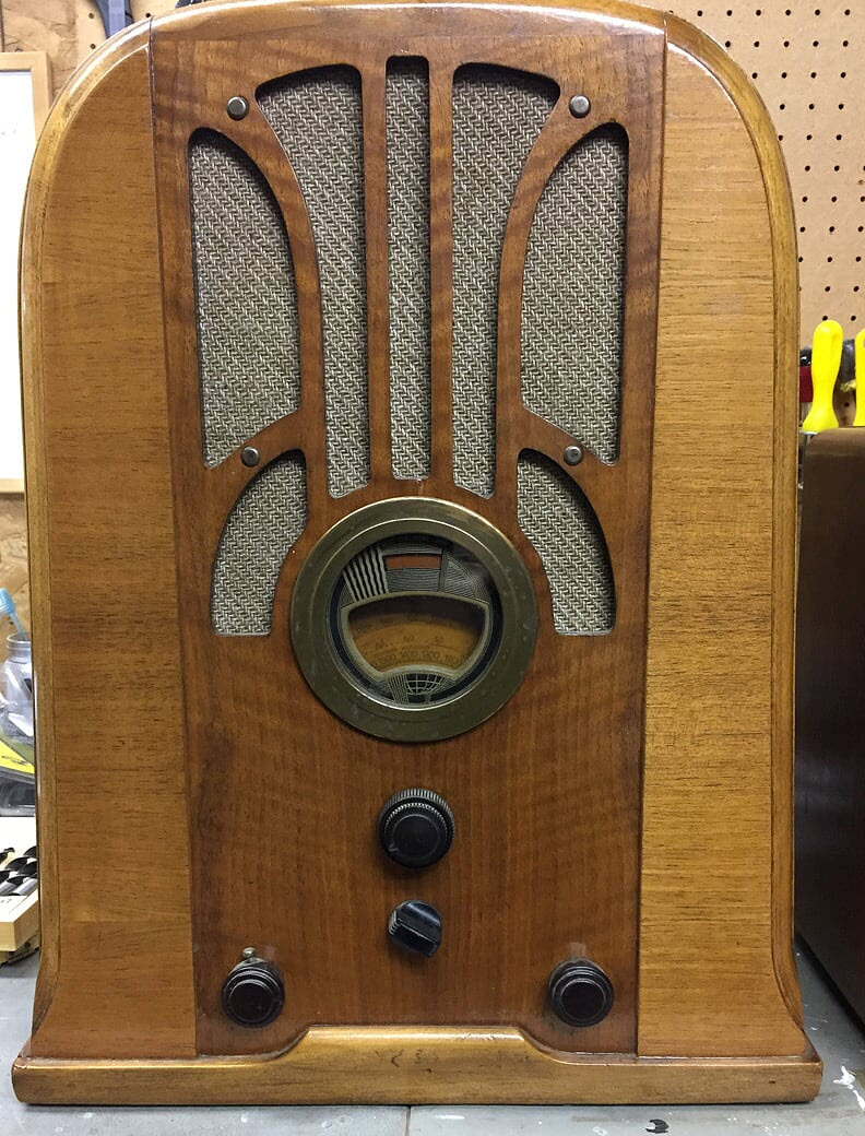

Edit: Image added by admin

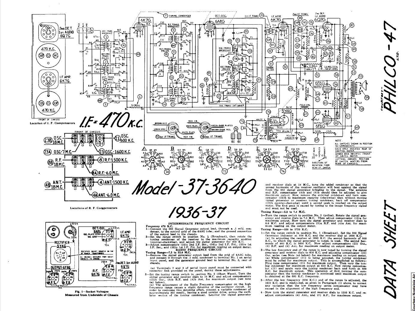

For those who might be able to answer your questions...here's the link to the 37-640 schematic.
Thanks to the moderator to have added my picture.
See the schematic of the 37-3640 below. A re-organized version of the 37-640.

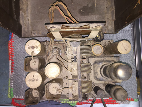

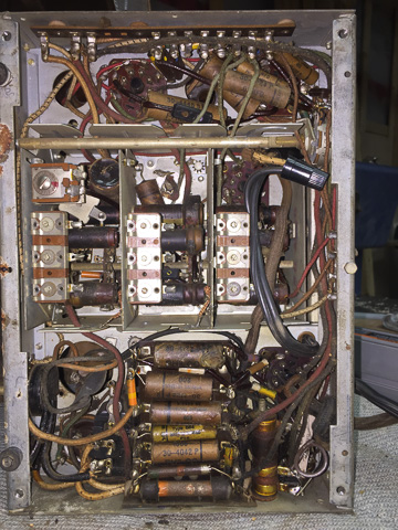

And a few more pictures of the receiver.
Cabinet plates
Receiver

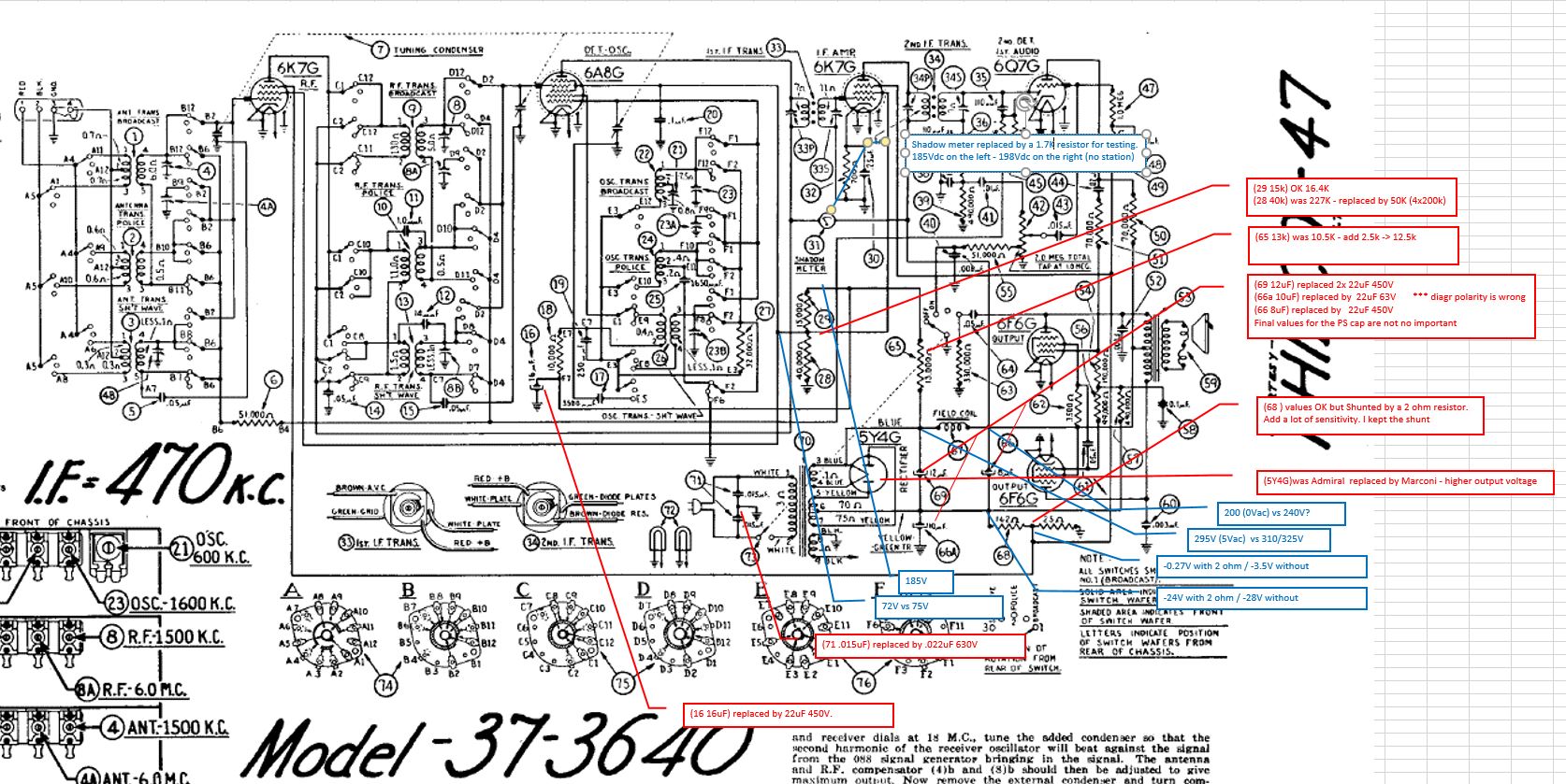

I am closing this projet for now. Below is what I did, for reference. Hoping can that help someone - also valid for a 37-640 I guess.
I did minimal restore and checks 1) was my first introduction in radio restauration 2) I don't want to risk breaking something as fragile as the dial disk 4) the design and assembly of this radio is quite complex 3) replacing all caps and resistors would let's me feel that is no more the same old radio...
Finally, the radio works and perform quite good as is. Not a lot of humm, and I get a lot more radio stations than before. Will see in the future. I have a RCA M46 and M46A to practice - simplet in their design and assembly.
Will rather improve the antenna for now.
You may want to consider replacing #61,44,52,60,64,20, and 14. These are in the HV path and if leaky can cause excessive HV current. 41 and 43 are a good idea they can effect the tonal quality or cause noise.
Thanks a lot for your suggestions. Most seem quite easy to replace. I will certainly work this when I will do another restoration pass.
