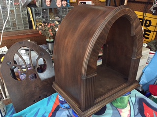

I carefully followed the extensive thread between John F and Eddie Brimmer regarding John's Philco Baby Grand refinish project. I read and re-read it, and finally mustered the courage to take a stab at doing my own 90. I got to grain filling, using Pore O Pac Medium Brown Walnut just as Eddie recommended. My cabinet is very much darker at this stage than John's was. In fact it closely resembles the reproduction cabinet made by Steve Davis. I am torn because I highly admire Steve's work, but don't understand why my cabinet looks so much different than John's. I sprayed 2 coat of gloss clear and haven't moved on to toning yet. I'm wondering what to do going forward. I planned to use perfect brown for the majority of the cabinet, with extra dark walnut for the base molding. I'm afraid that starting out so dark, I'll just have a mess on my hand. Maybe a light coat of toner to incorporate some reddish hue, then finish coats??

I'm going to start sanding today. Do I need to apply sanding sealer diring this process? The cabinet currently has 2 coats of clear on it from which has cured for 3 days.
I compared my cabinet to the photo on Steve Davis's repro page and the tone is nearly identical except for the finished trim, and possibly the fancy wood arch. It may not require too much to get to where I'd like it to be.
Fingers are crossed
That looks real good. Make sure you even out that color on the arch.
