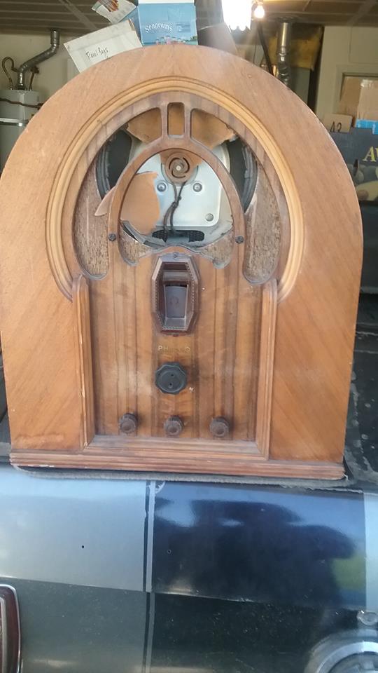

So here finally is the 16b ive been talking about, paid $25 for it and decided to open it up and poke around.

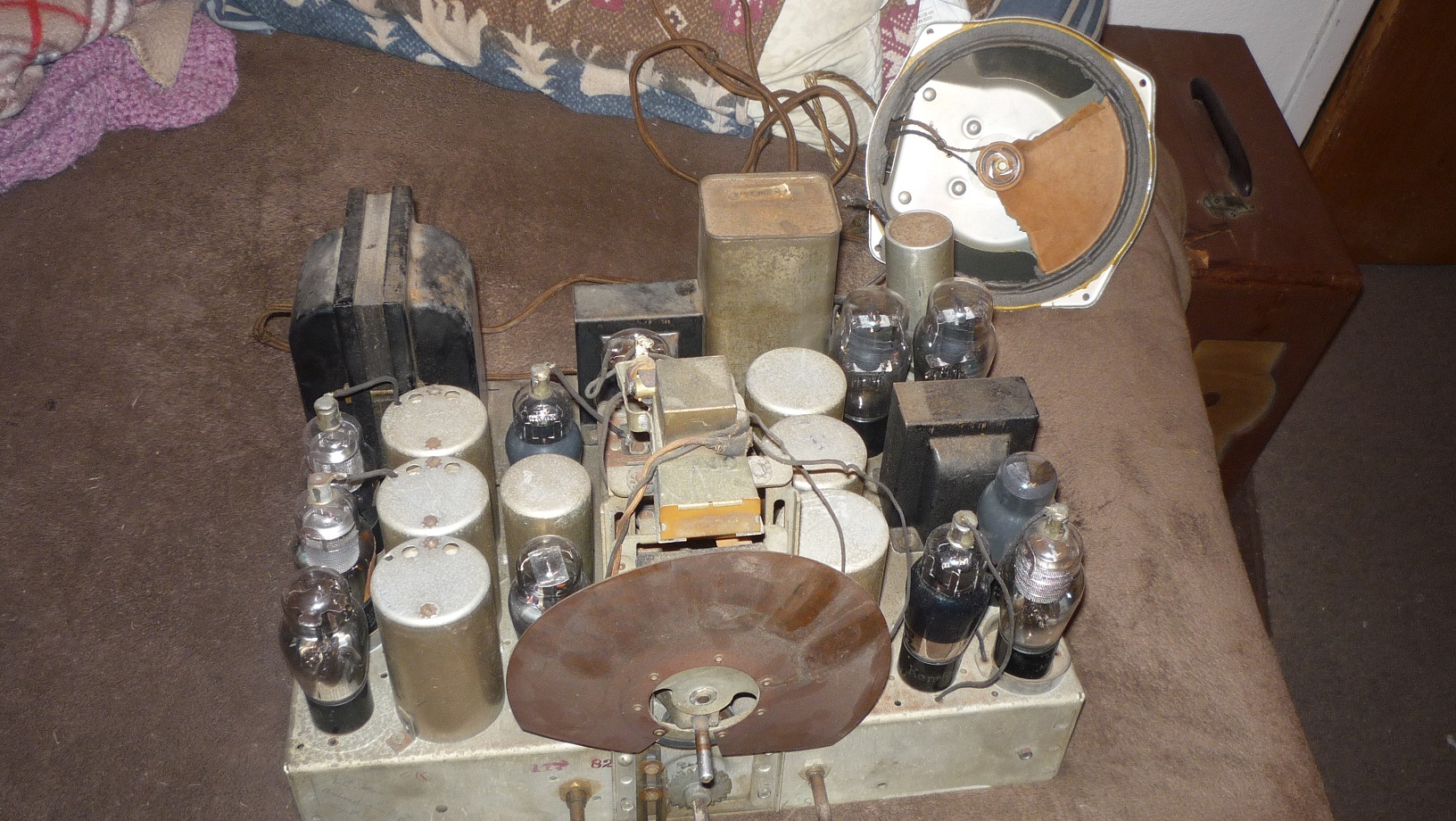

Looks like its been previously molested a bit.  Its the 121 chassis, hard wired speaker, 80 rectifier and the shields are missing....

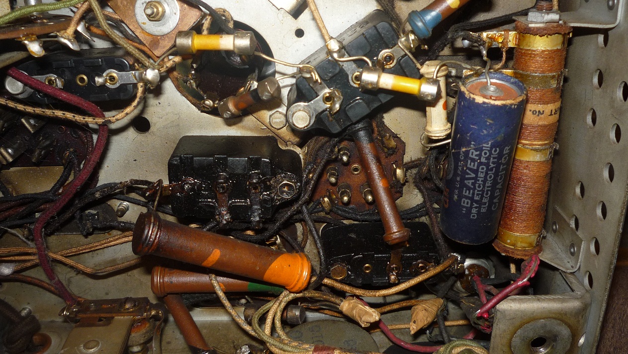

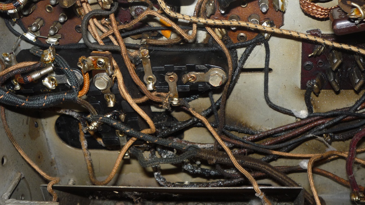

Upon further inspection i can see why the previous owner removed the plug. Looks like it was previously ran and overheated...  Power trans looks a bit waxy, A dime size drop of wax was on the cabinet bottom, and caps 86 and 68 look like they didnt appreciate the experience... Not smelling any burnt windings from the power trans...
At this point i figured i had nothing to lose, so i pulled the #80 rectifier, added some safety fuses, and......Gave her some juice.. The bulbs light, and the tube heaters all lit up as well.... Decided to press my luck, Inserted the 80 tube for a few seconds  long enough to hear a hum from whats left of the speaker and shut it down without incident....(smoke, fire, etc..)
And thats as far as i go with power applied from here on till re-capped... Icon_biggrin

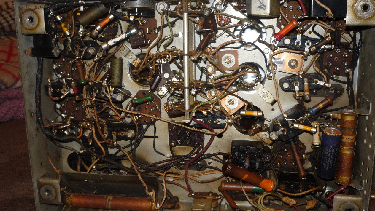

Clean chassis, not messed with too much except that electrolytic cap which is typical of most radios to have.
The piece of cloth-covered cord that is inside the chassis (from the power switch to the AC filter caps) is shielded, don't discard it.
Wires having wax/tar deposits on them is also popular thing, not bad in itself.
In mine many smaller resistors were not too far gone, so I kept them.
Nice find for $25,  I could be so lucky.  Looks pretty much original,  a nice restore project.  10 tubes!

5Z3 rectifier is lurking behind the tuning cap in front of the filter choke.
16B is a 11-tuber.
(09-21-2017, 04:34 PM)morzh Wrote:  5Z3 rectifier is lurking behind the tuning cap in front of the filter choke.
16B is a 11-tuber.
I was not doubting you..  I looked it up after you pointed that out.  The radio museum has a good picture of the top of the radio.  That is a boat load of tubes,  I guess I did not realize the tombstone radios had quite that many.
73's  Bob
And this one is not even a tombstone Icon_smile
16B is probably the best table-top they made. 11 tubes ain't there for nothing. I think, from the full size tabletops, the 16 (in all incarnations) is the most sought after radios. Judging by what it goes for.

<1.. With your prior knowledge of these radios and have seen the pics of the boiled bakelite blocks and the waxy transformer lines, do you think the transformer will be okay? (it functions as posted earlier)
Once you replace the caps inside the bakelite blocks your good to go. The pt showing a little wax is common nothing to get worked up about. When new there ran warm and with aging caps to load in down this can cause it to run hotter.

Ive restored a few radios prior to this one, and was thinking of orange drops for replacing the paper/wax caps and the bakelite innards with... However, i may need help with a list for #values that will require subs due to lack of exact replacement number values..
