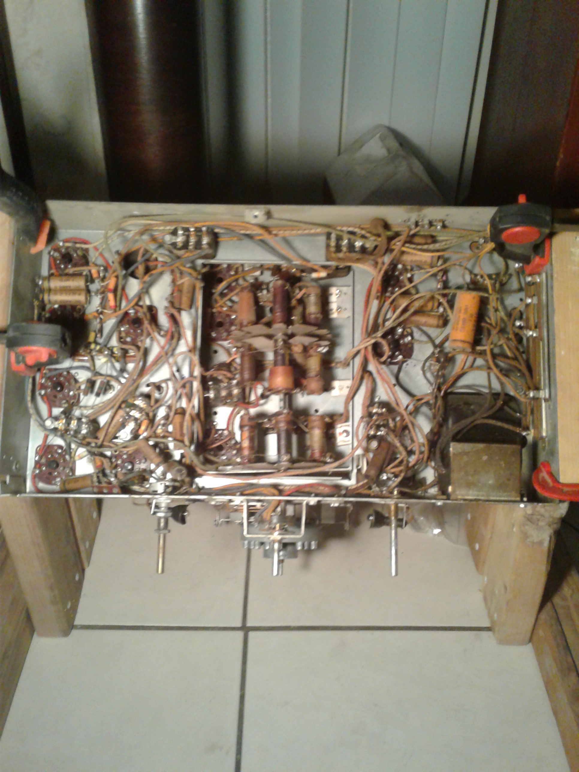

       The underbelly of the beast...
What is that silver rectangular box with the wires coming out of it in the lower right hand corner? It reminds me of an old bathtub cap, but I know it's not. Can't seem to locate it on the schematics... Icon_think  I pulled the cover off somewhat, and it kind of does look like an electrolytic, but i'm not sure I want to mess with it...
Just checked the mail... No electrical work on the chassis again this weekend   Icon_evil Icon_thumbdown
It just might be a capacitor(s) in a tin can akin to those used in 20, 70 or 90 radios. Extremely easy to restuff.
Like Mike said probably some bypass caps inside. Trace the wire back to what they are connected to and check them on the diagram to find
their values.
