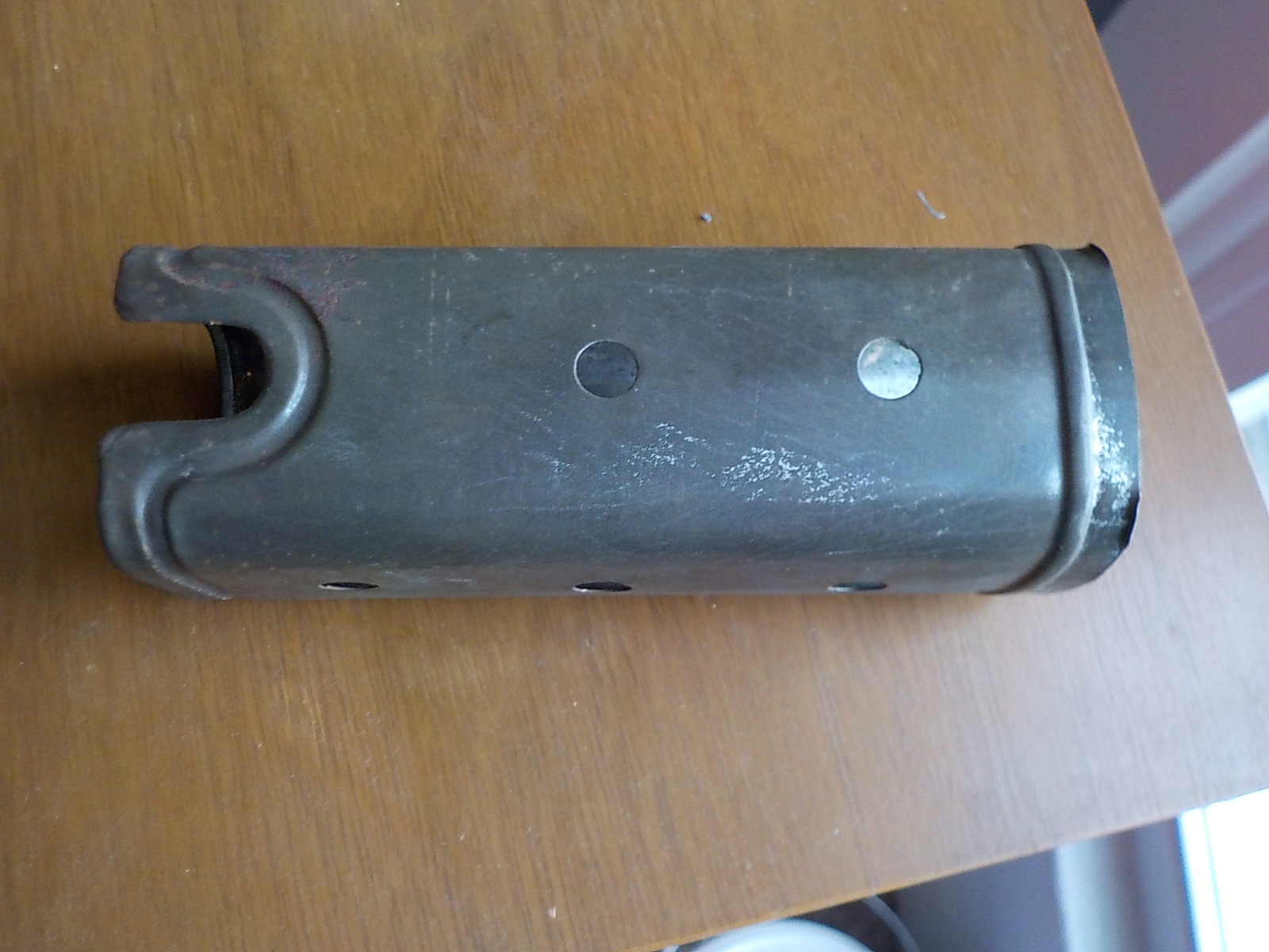

I'm not sure if this is the right place to post this but, what color were these tube shields originally?
Sometimes they look like they were painted green, sometimes brown, and sometimes it just looks like a patina.  Icon_crazy
These are from a 37-610. Thanks in advance.

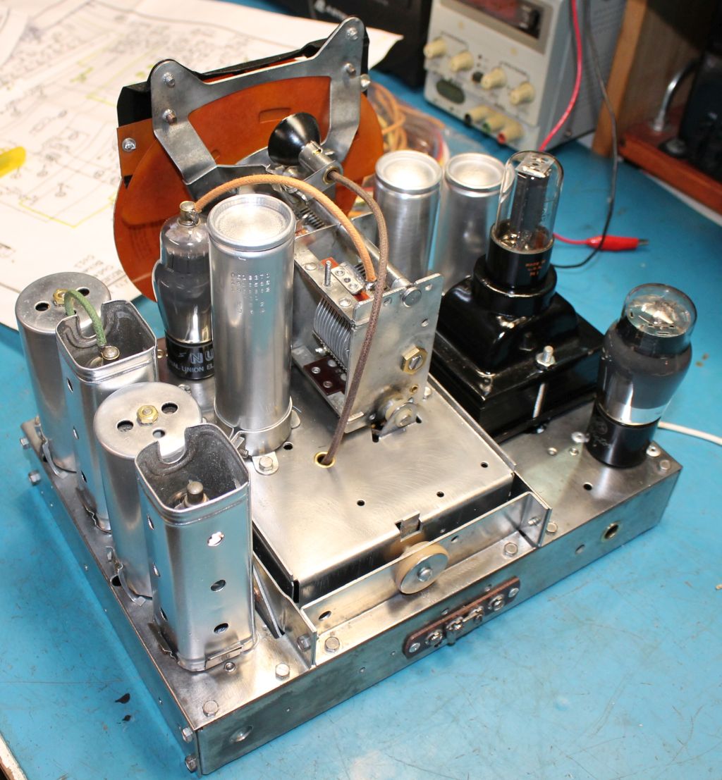

The tube shields on a 37-610 that I recently restored were unpainted. I simply polished them up and sprayed them with gloss poly.
It looks like they were plated, could be tin, like a regular tin can.
Really nice job! Icon_thumbup

These shields were originally tin plated. The tin came off over the decades on most of these shields.

Whatever you do with refinishing the shields make sure you wash them good first, tube shields seem to build up a layer of black dust on the inside, and sometimes the outside, not to mention oxidation, and sometimes rust.
I had kinda wondered that myself. Found some paint I think may be close. Kind of a brownish color to me.
Tim
The (few) shields that stil have good tin plating are very shiny, almost as if they were chrome or nickel plated. Not brown.
Yeah, I would not paint them - unless you polish them up and put on a clear coat, maybe semi gloss.

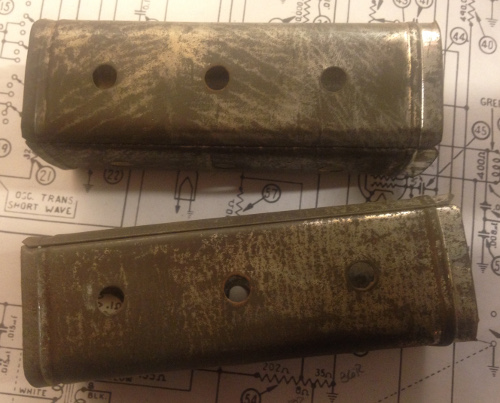

If I understand correctly, these shields turn this color with age? They are shinny inside, but the outside sure looks like some kind of thin paint and just a touch of rust in some spots. Be better to clean and clear coat? Wire brush or steel wool? These are from the 610 (my forever project).
