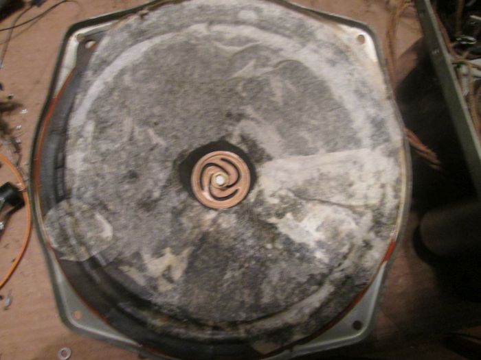

Ever use too much bathroom tissue??
Spkr from a model 66 that's on the bench. Stiff as a board!
Icon_eek huh
mike (morzh)  this is family friendly phorum.   restrain yourself Icon_cool
Icon_lol
I have patched with coffee filter and glue but never as full a covering as that. How does it sound Terry? Any response through the paper?
Sam, what are you talking about? I was not even here.
So Paul,
To answer your question I just got though going over the chassis. And yeah the speaker stinks!
Yes speaker stinks  Icon_lol
Mike no wise comments  Icon_question
Well, might as well comment.
What do you expect of a speaker with tons of toilet paper on it? And who can assure us it is unused?
Doesn't matter it's leaving. Found some modern replacement cones @.79c ea. Just have to order a few.

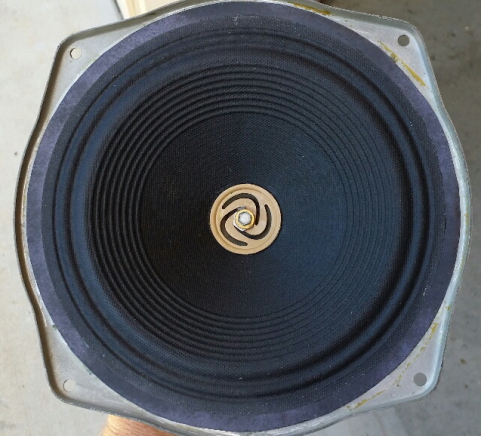

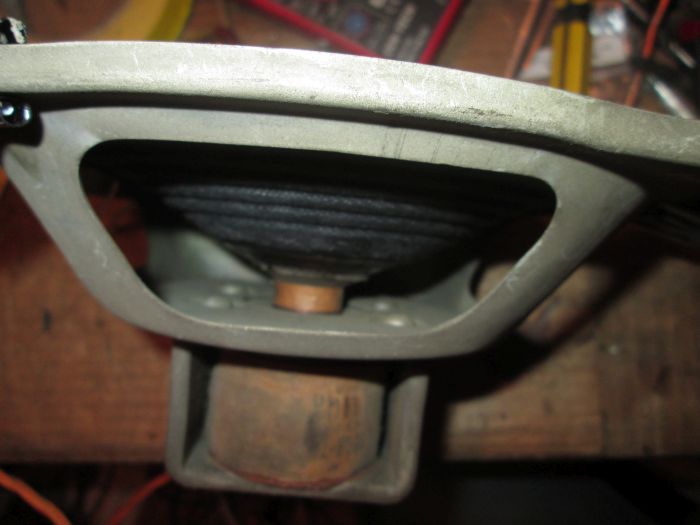

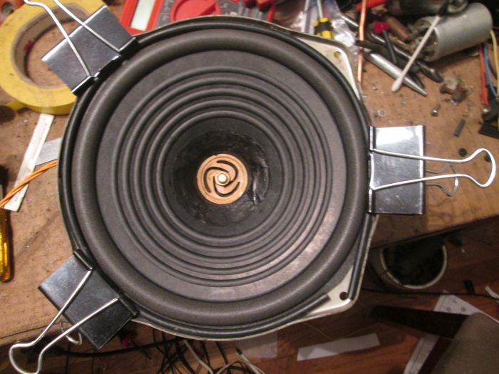

So the cones came in abt a week ago and started to fit it to the K spkr. I found that they aren't a good match as they are too deep and have to cut down the foam to fit the basket. Was hoping the foam would fit w/o a trim, with a trim it makes the glue able surface kinda small. It was necessary to enlarge the vc hole to abt 2 1/2" to get a usable depth. W/o doing this the vc will bottom out. I still have glue the outside edge but it works well it this point.
They make a cone that does not have to be cut down. I bought a bunch of these at about $1 each. They still have to be spaced back so the foam does not rub. But, they do sound better.
Here is another one. This one does need a spacer around the outer edge. These came from a vendor on E-Pay.
