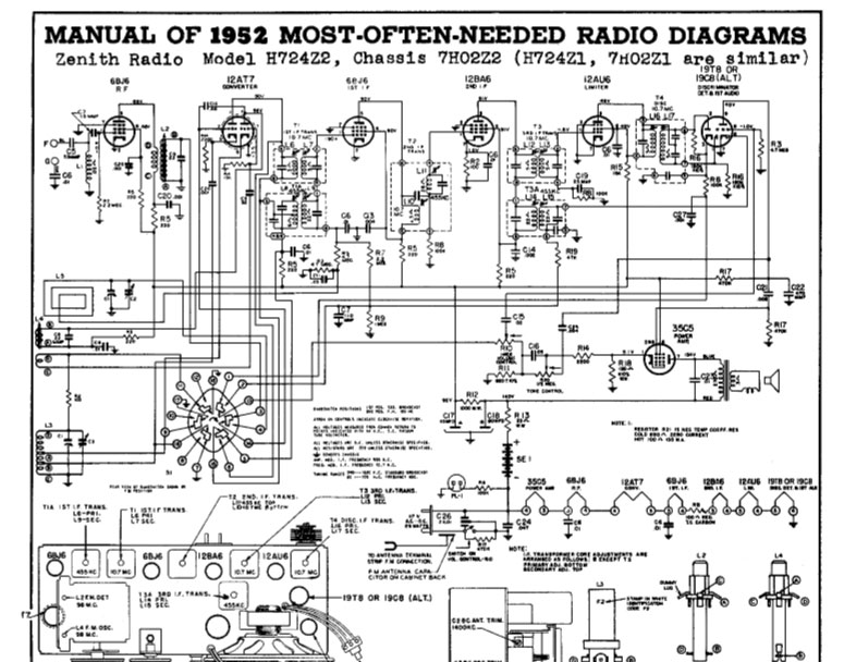

I'm working on a Zenith R723 AM/FM. All caps have been replaced resistors check and Th IF alignment is done. My problem is that when doing the RF alignment, when one part of the dial lines up with the right freq., the rest of the dial is off. If I set adjust it so 103MHz is correct on the dial. then 95 comes in at 92 on the dial. All freq above 103 line up but anything below is off.

L-3 (fm osc coil) has a bit too much inductance. If you can stretch it out bit will lower it's inductance. Once you get the low end close then use the trimmer to set the high end. On a lot of these sets it's tough to get them dead on across the whole band but should be much better than what you've got.
