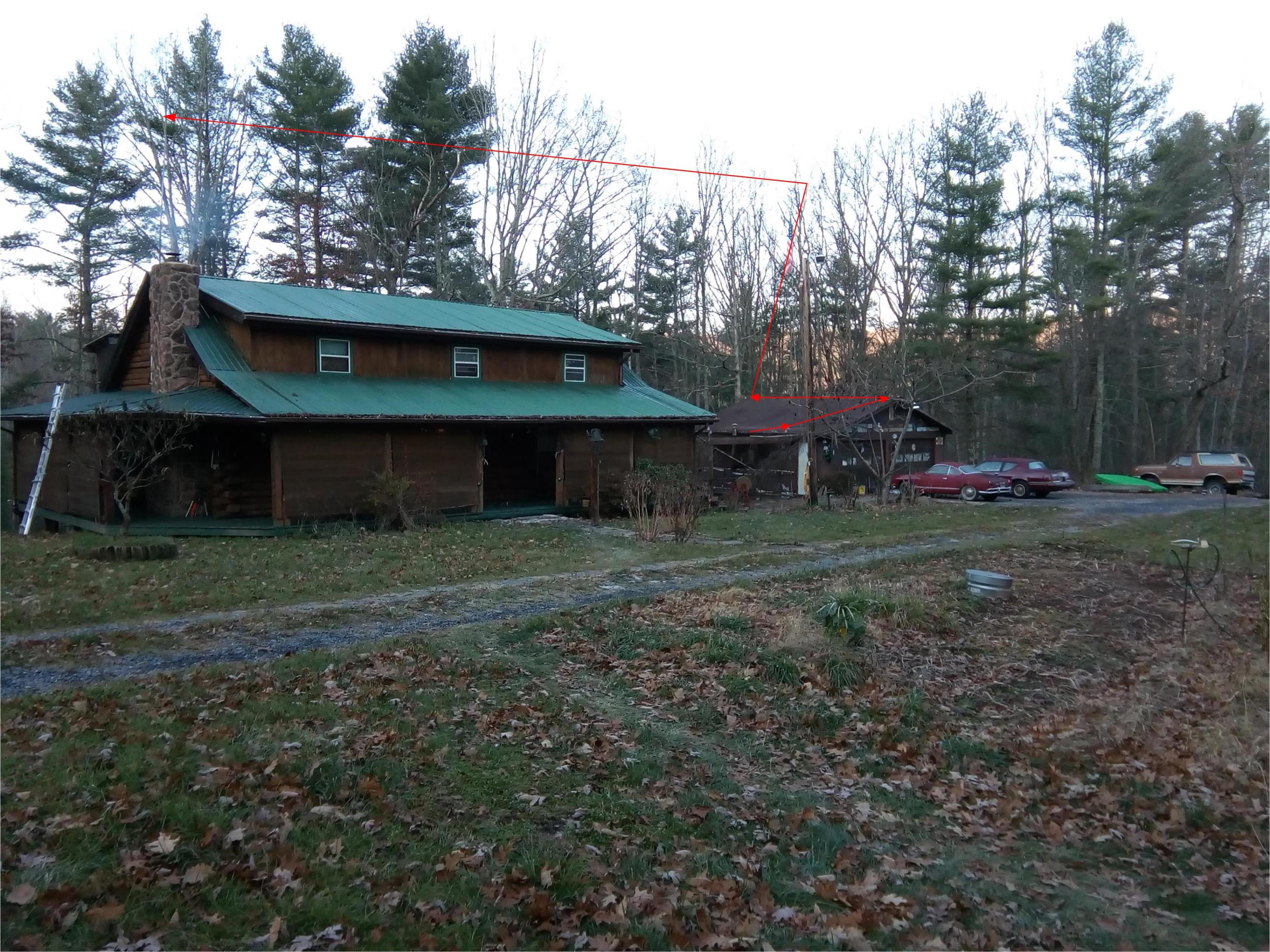

i am going to post a picture of my existing long wire and possibly experient with extending it "into" a beverage.
I will however build a beverage separate,, its real easy to do, however i dont have that impedance matching transformer part,, and i am not sure how important it is for the "experiement" .

pic of my long wire arrangment.
leaves garage window as insulated #10.
Splices to tin coated electric fence wire  which is amost like #18.
around glass insulatiors at each turn out to dead end at chimney
all radios go to this single long wire antenna, 3 total radio sets.
each radio has a tiny 120vac ice cube relay.  the relay dry contacts are wired with the antenna tied to the NO / C contacts.
when a radio is turned on, that particular radio automatically ties itself to the antenna., removes itself when powered down.
Nice setup!
What direction(s) can you run wire, in relation to the places you would want to pick up? Also how long a wire could you run?
I really like the relay activated antenna hookup system you described - very ingenious Icon_smile

I know it might look good but i have often been wondering if placing that horizontal run over top my house is good or bad.
one day someone told me my antenna on my car is assisted in picking up station by which way my car is pointed, meaning my windshield helped refect the signal. same with my metal roof but, i could be helping unwanted interference get on that same wire.
It would be good to avoid runs over the house. A 500ft wire, extended off the left of the picture, terminated before it got to the house with a balun, then coax to the radio is what I might try in that situation.
My listening antennas (longwire and dipole) both have coax runs with baluns at the connection, and this really helps avoid sending noise from the house, down the outside of the coax and onto the antenna. They are nice and quiet, despite neighbors 100-200 or so feet away.
