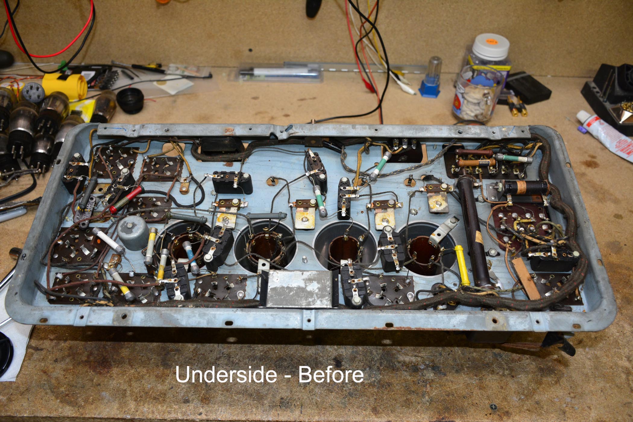

I've begun the process of restoration on a 96 that I picked up.  Not a great radio, but it will be a good experience.  This is the first time I've run across the cap blocks that include the wire wound resistor.  I've been able to extract the resistor intact and reinstall it in the block with the new cap.  Is this wise?  They all measure within a few ohms of spec and install quite easily.  Has anyone had any issues with doing this?
Many of the cloth covered wires are very brittle and I will replace individual wires.  The wires in the harness that runs around the perimeter of the chassis are also very hard.  I hate to disturb that.  If it's not flexed, is it safe to leave it?

I just did the same thing you did in the 91 I'm working on. Reinstalling the resistor should be just fine. Follow the link and you'll see what the guts of one looks like.
Awesome! Thanks.  I was able to unwind the resistor wire from the terminal so I didn't need to get more wire out.  Didn't realize it would have been so simple.  This is a great forum (phorum)!

Most of the dog bone resistors are a bit over spec value. One is open.  I think I will hide a  resistor under the dog bone in parallel to bring the resistors within range. They are small enough that they should not be readily seen hiding behind the original.  With a cursory glance from above, it will all look original.   I really don't want to go the painted plastic tube with a new resistor inside route.   Do these old resistors vary much in resistance with temperature?  I would think it is a slow degradation of value over a great deal of time.  My observation is that they usually increase in resistance. Thus a calculated parallel resistor would bring things into design specs.

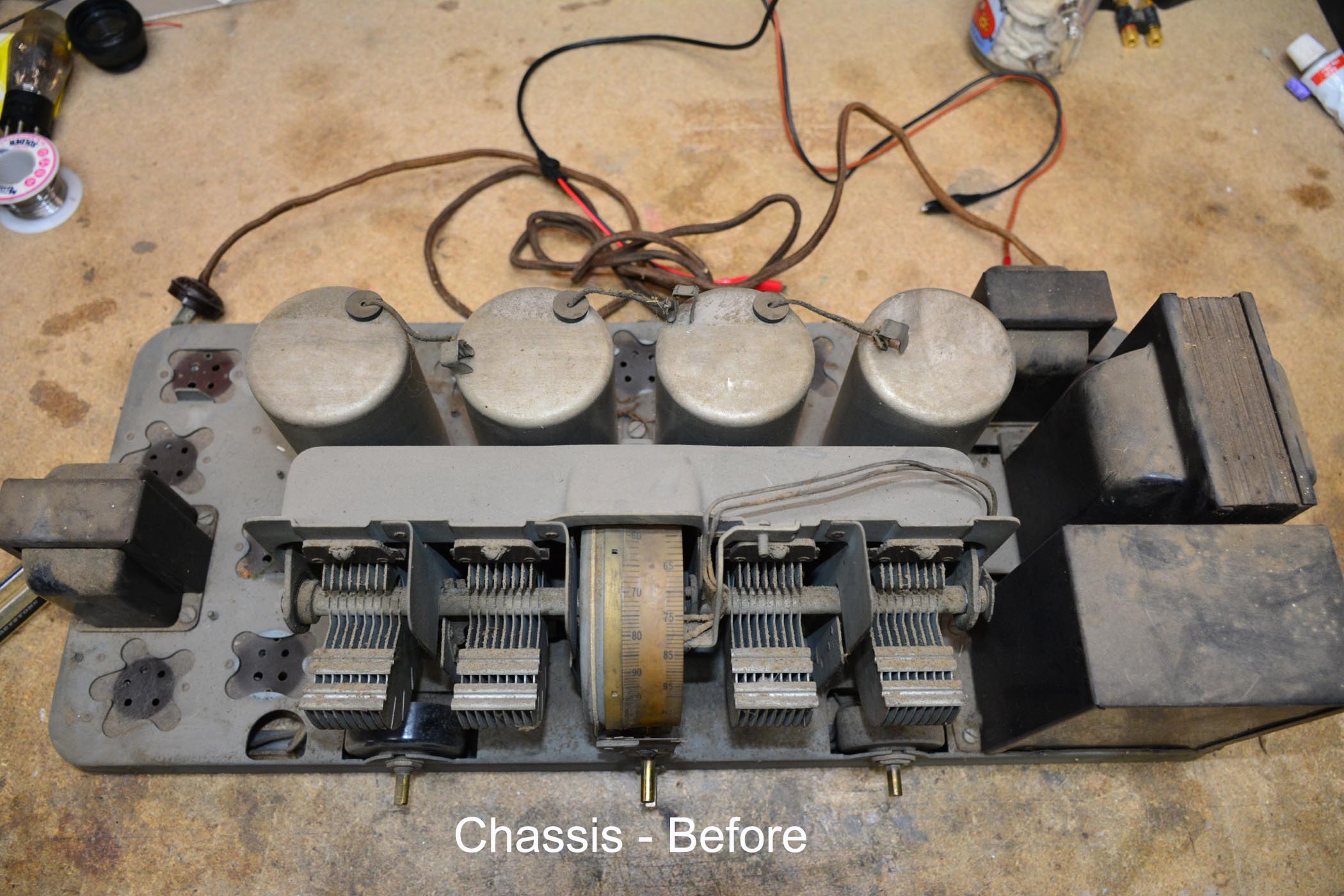

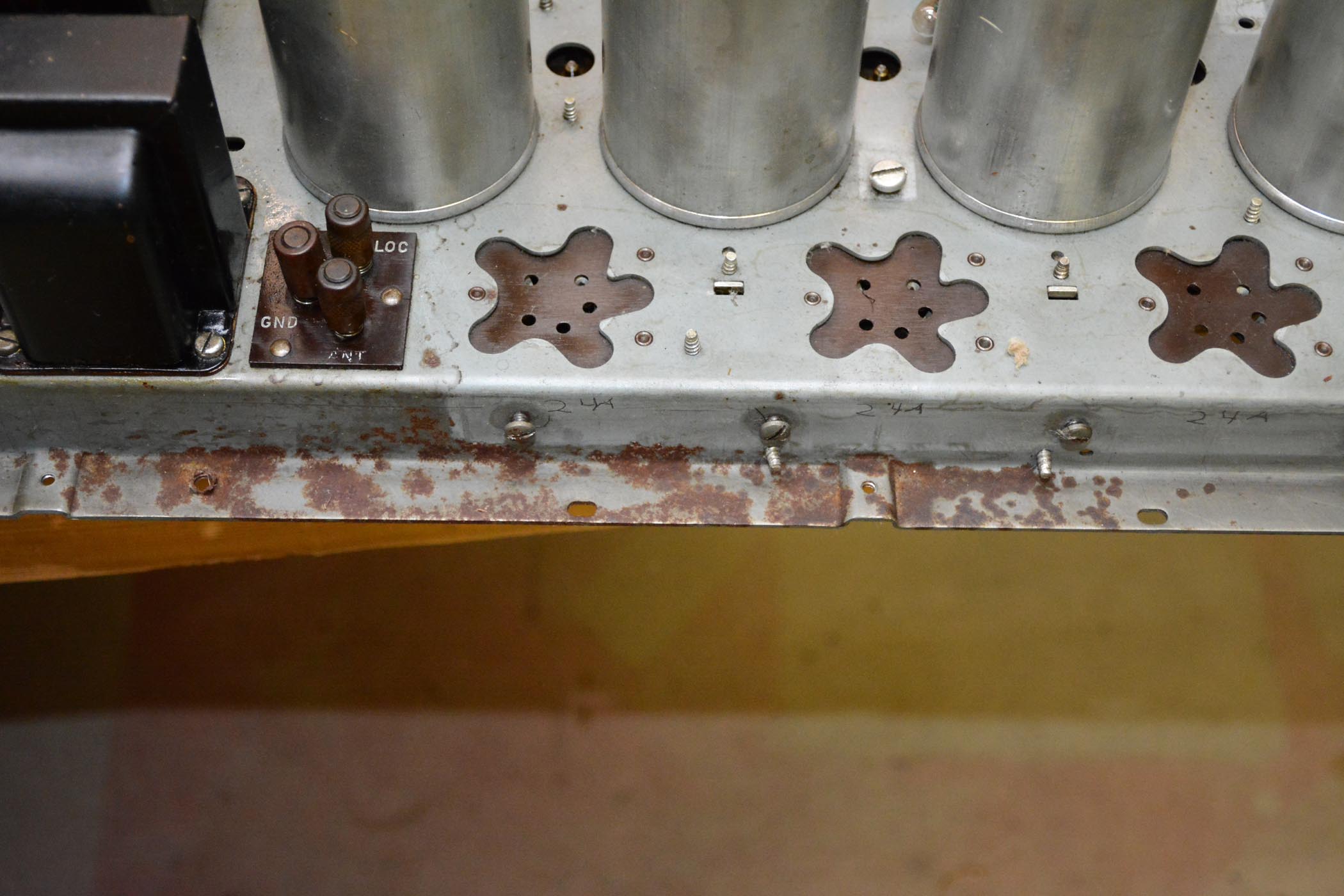

To paint or not to paint.  That is the question. I've seen several restoration videos of people painting the chassis.  Here is a pic of the 96 chassis.  This is the only place there is rust.  Should I paint the entire chassis to protect this area after it is cleaned?  The painted chassis I've seen in the videos look pretty good when done. The RF cans look pretty good and will be much better if I can get them clean.  I would hesitate to paint them.  Thoughts?
In my opinion, if you want it to look a certain way, yes, paint it, but after de-rusting, if kept inside a house with normal humidity, it will not likely rust anymore as the rust typically develops as a result of the radio having been kept in a humid conditions, like humid basements, barns, poorly climat-controlled storage etc.
What Mike said.
Don't paint the coil shields (you called them "RF cans"). They are aluminum. You will be amazed at what some Mother's Mag & Aluminum Polish and elbow grease will do for those coil shields. Icon_thumbup
I'll try it!  I still may paint the chassis to give it a nice look.  The old cadmium (???) plating is so dull, although the naval jelly is cleaning it up a bit.  Painting would give it a more consistent look.

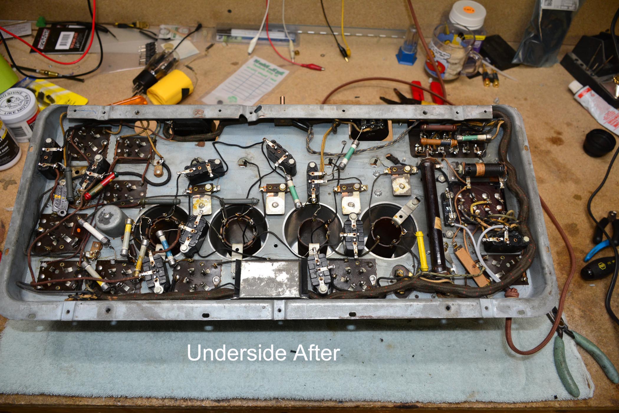

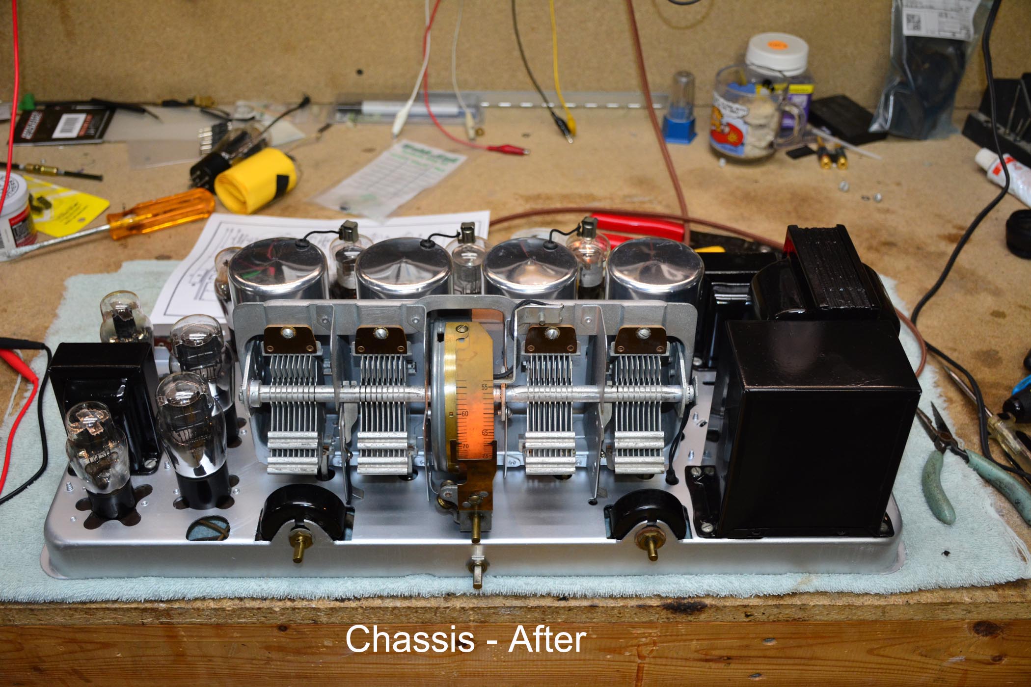

Here's where I  am so far.  Chassis has been powered up w/o the 80 (field coil not yet checked out).  Power transformer voltages checked and tubes light. Chassis painted, all caps replaced and resistors "modified".  I hope the old dog bone resistors are reasonably stable after this amount of time as they are still in circuit. Parallel resistors have been added to bring them within specs. the only question I have is the antenna coil resistor.  it is spec'd at 5k but measures 4K.  How does this affect the antenna circuit performance?

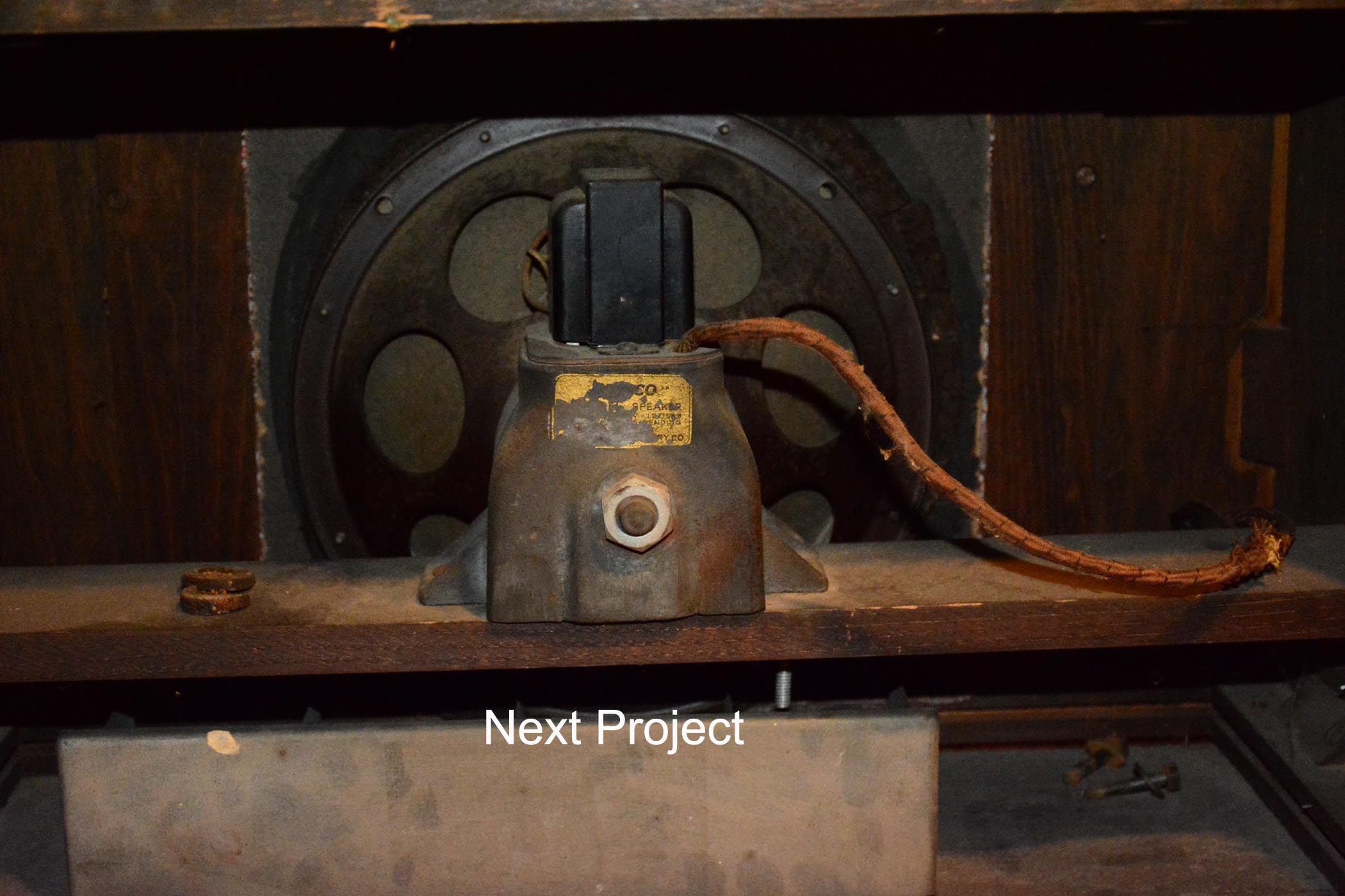

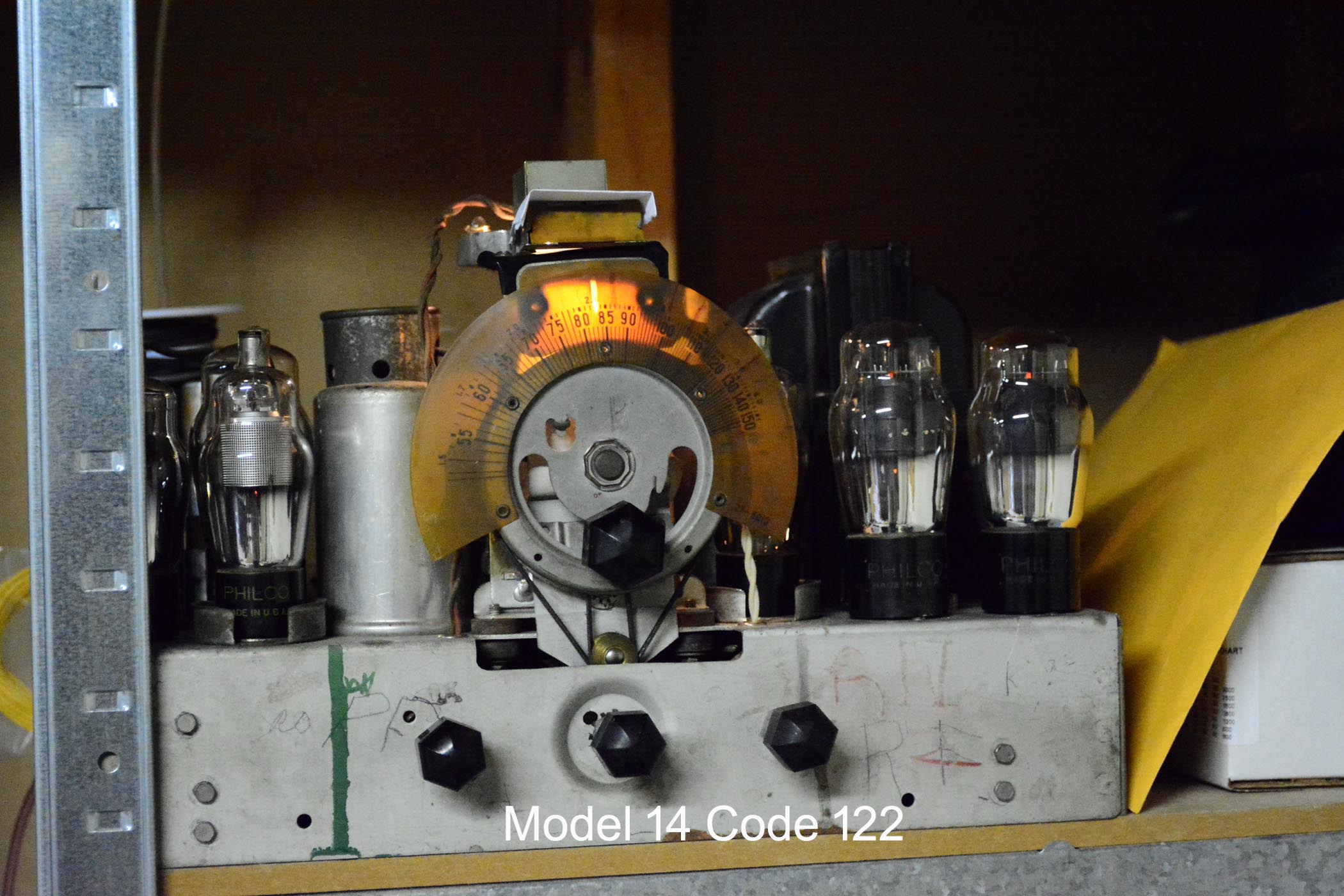

Rats! Open winding on the output transformer. One side of CT measures 3.7K, other side 12K. Deja-vu all over again (model 14). Guess I better get at rewinding the 14 transformer so I can try the universal here.
Field measures ok (3.3K) so I may fire up the radio slowly to verify voltages and basic operation.
