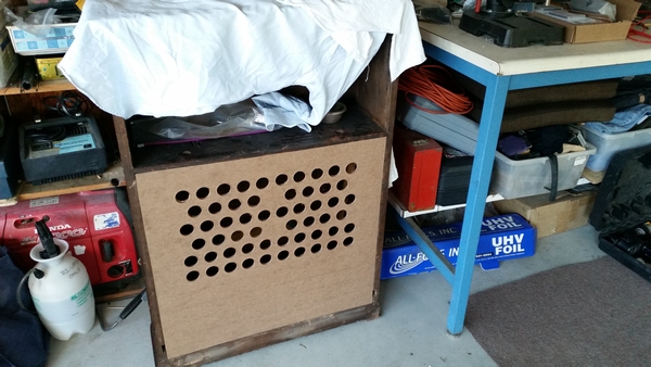

OK. last weekend, I found the speaker felt gasket - a basic "Weather seal" product from the hardware store down the street, glued in place, and I replaced the sound board. Things are looking good. Close inspection revealed a couple of cabinet areas in need of glue, and that was also attended.
I found a suitable piece of hardboard, and this week's fun will be making a new back for the speaker compartment. I'll probably have to invest in a new hole saw - they were serious about those perforations!

A little work today... I cut a piece of board to the right size, and bought the correct size hole saw. Then I tried to make a few practice holes on the scrap material. Sometimes this is really worthwhile. Now I know suitable drill speeds and which direction to cut. Next, to mark out the panel in the appropriate pattern and start making holes. ~100 of them!

More work today (eventually) on the back. Some of my available time was absorbed in repairing a chair for Mrs H, making her happy.
I am now thinking of rebranding this part of the radio "The Philco Effort Absorbing Screen" as it continues to be slow going. Working with a hole saw depletes my drill battery rather quickly, and it is slow going with the hardboard. Slower still, as it is often hard to remove the disc from the centre of the tool. I have now figured out a method to stop that from happening. Not completed today, but I am at least over halfway with the drilling. I might display the radio facing the wall for a while to admire the time-consuming handiwork on this, and the chassis!

Here is the back, part way completed, and resting in the cabinet for reference. The design is based on a picture found on line, and scaled accordingly. Eventually I'll paint it black (matches what I saw in the picture) and add cloth to the inside surface.
