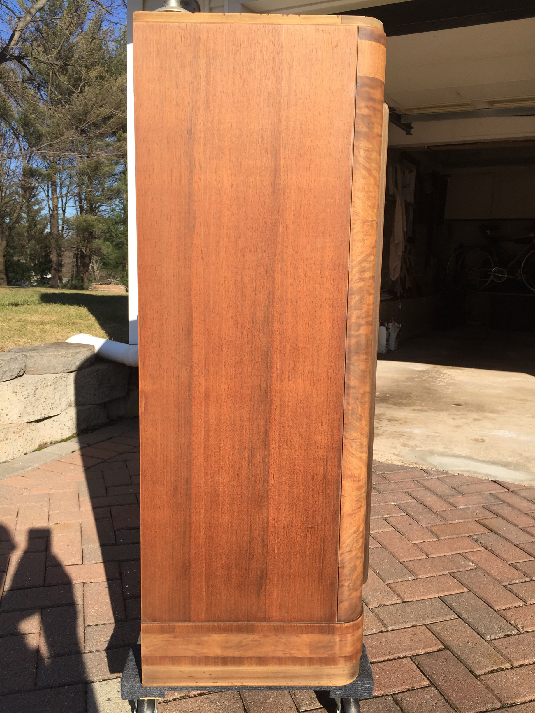

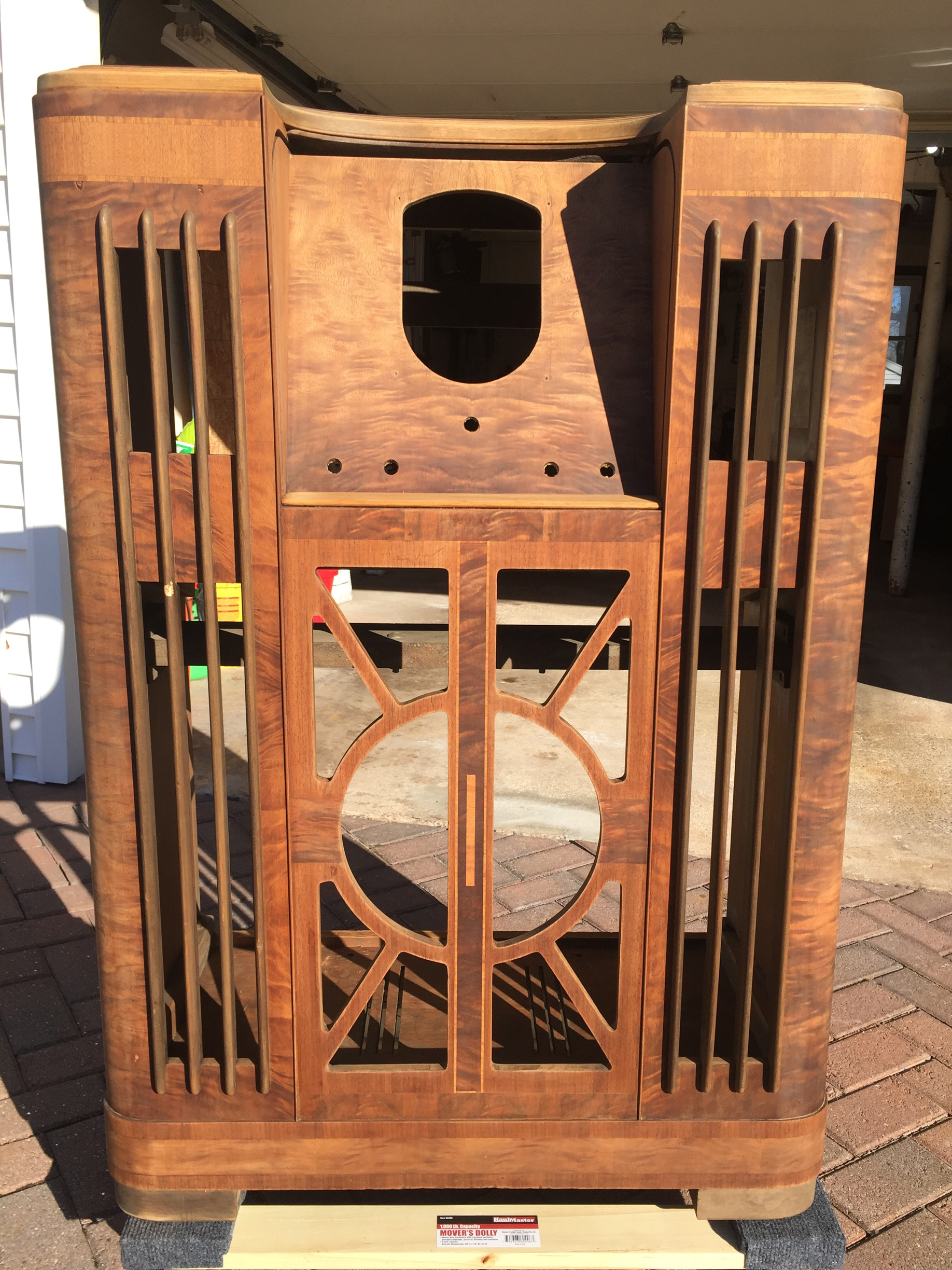

I am looking at refinishing my 38-690 cabinet. Appears to be done over with polyurethane with a few runs and rough finish. Looks like it was slathered on too thick.
I was curious if there is any photo finish on this radio, especially the front. From what I can tell it's veneer but sometimes it's easy to be wrong. I tried to strip a slightly hidden spot with lacquer thinner, and it appears to be veneer as there are grain pores visible.
I don't want to strip it and find out that I ruined the cabinet.
Also, what wood type is this cabinet? Seems light for walnut, but it has open grain so it's possible.

As far as I'm concerned there is no photofinish on this radio: strictly veneers and toning.

If you just have to use stain - and you don't have to, I would stick to using it just on the hardwood trim (poplar or ?) at the base and the edge of the top, not on the veneers.

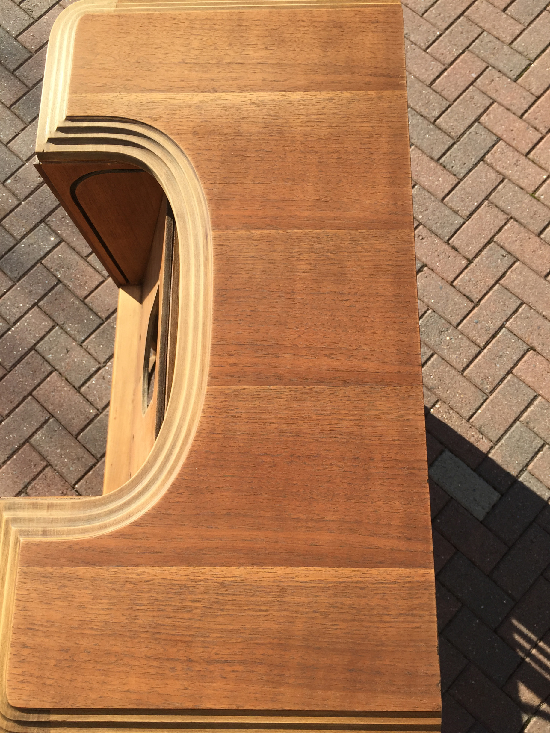

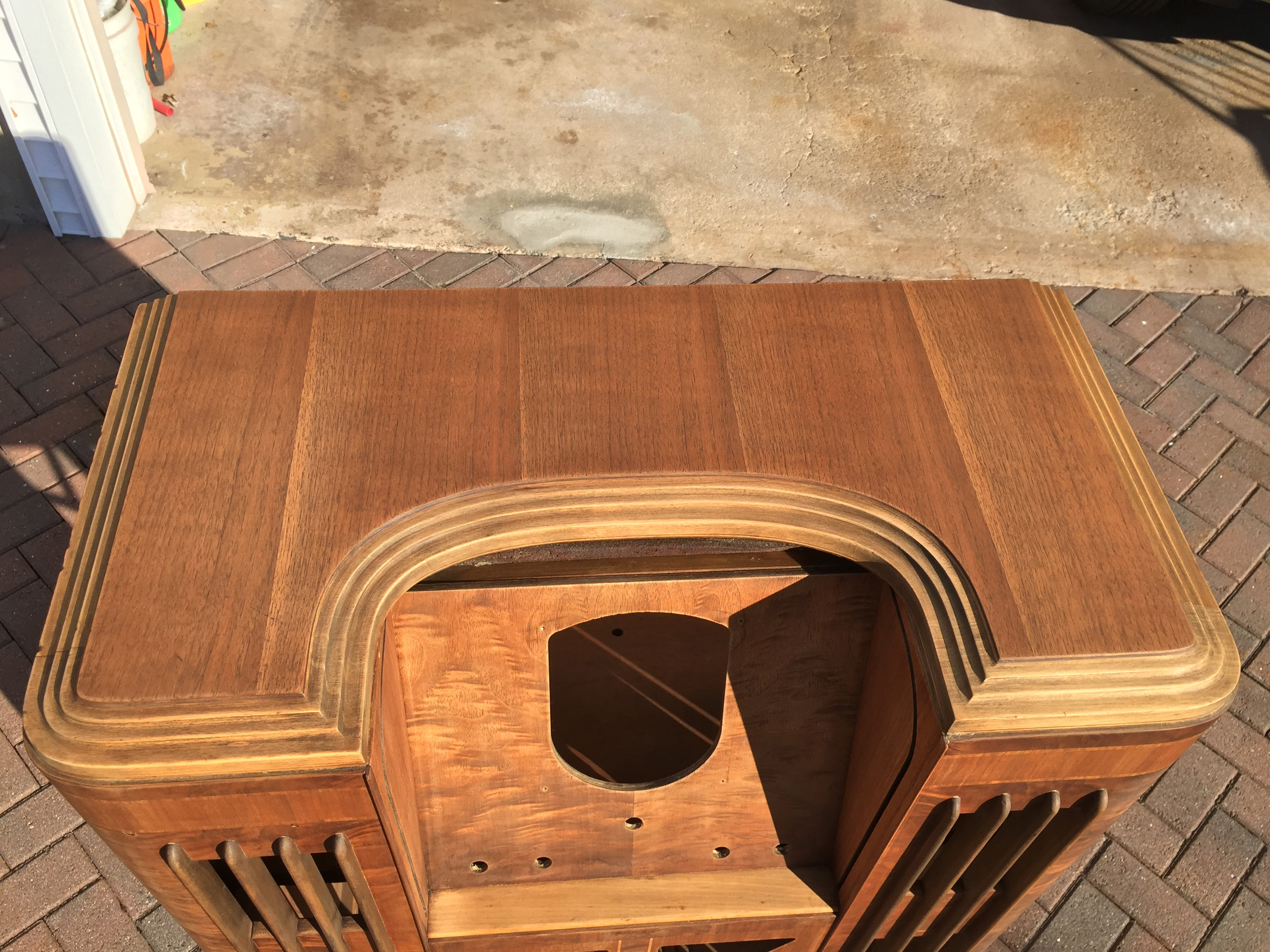

I was actually thinking about toners for the base (feet) which is not the best wood, grille bars, and the rim around the top. I agree that the dark veneer and pretty much the whole front should be left as is.
I will know more once I get to the Grain filler step. I believe that only the top, sides, and front panel around the dial will need this step. The dark veneers around the front are not that open of a grain.
