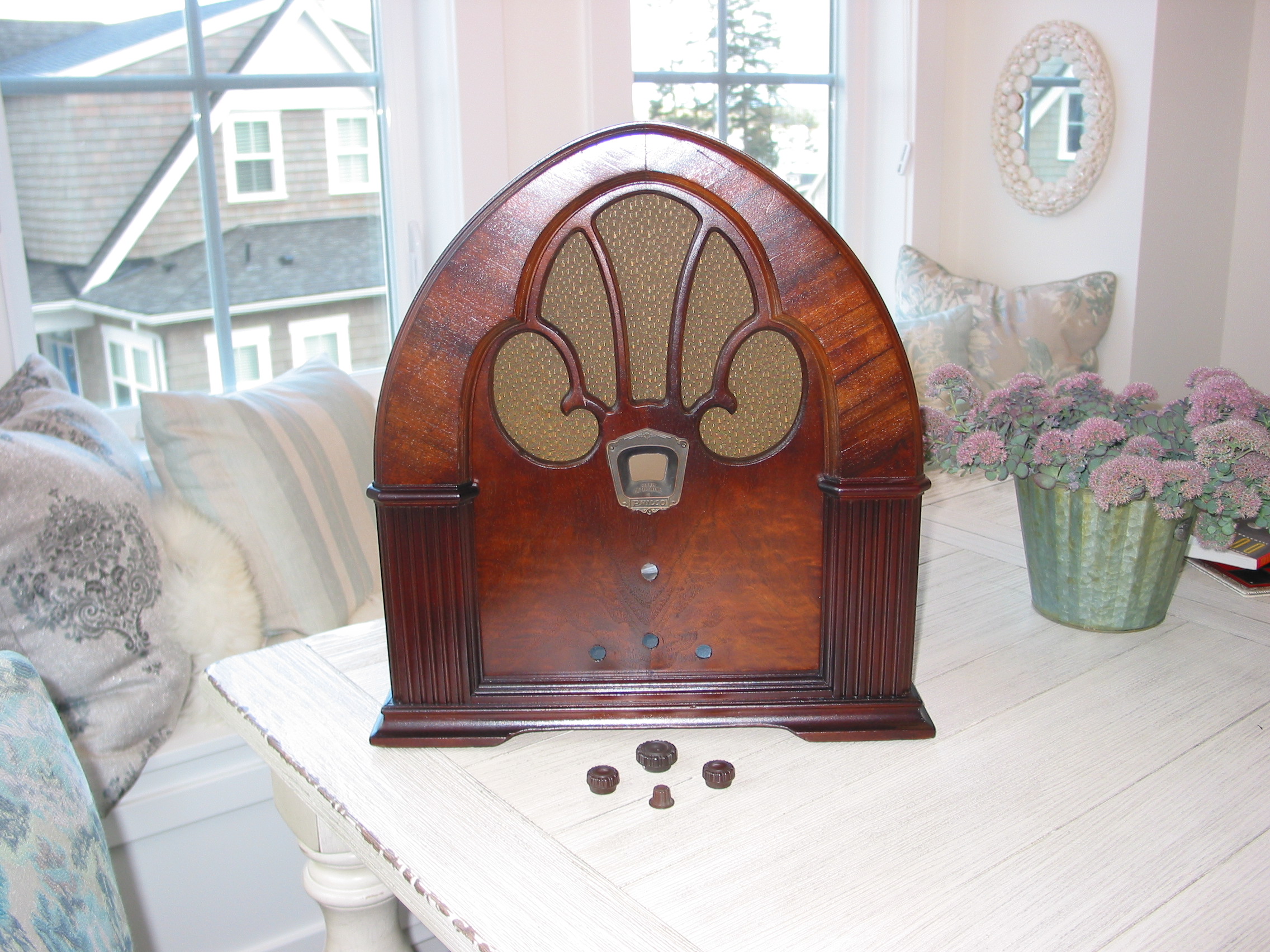

Hi all,
Maybe someone will give me some insight into what's going on with my 90. It's the chassis with one 47 tube. I've re-capped it and replaced most or all resistors. About half way thru re-capping I powered it up and had reception at a low volume. When complete I again had reception at a low volume for a couple of minutes then some crackles, then some more crackles, then dead. First I looked at the last thing I did which was restuff the two tobacco cans, #24 & #30. I didn't take them back apart, but proper capacitance was there on all. I checked and rechecked my wiring and the tubes. The primary in the first detector transformer #7 checked open, so I rewound that. Still dead. One day I went to pull the 47 output tube to listen for the click and at one point of the pin contact all of a sudden the sound came blasting through beautifully loud. Great! I think that I merely have a pin contact problem. Playing with the 47 pin contacts worked for a short while then it went dead again. Now, can't get anything again. At one point about the time it went dead again I accidently shorted across a compensating condenser, possibly #9 across the 1st IF primary. Something that I don't understand is why when I check across the coils of both IF transformers they come up open. They can't all four be open, I'm misunderstanding something. Does it have to do with the compensating condensers?
