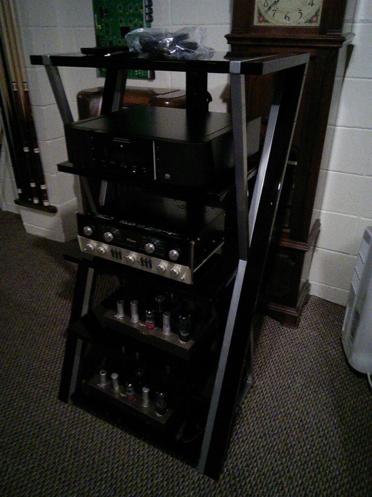

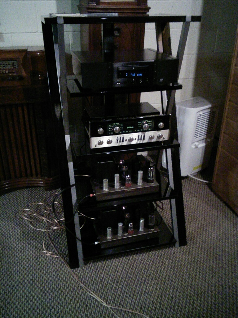

Well, here's the stereo.
Obviously it is no lobger just about the HF-22s, as I had to add aa source and a preamp. So I did. Will try to test tomorrow; I know the CD works (bought a used Marantz, same as the one I bought new, only it is 1K less). I hope the Mac (yes it is a C22) works, at least it was promised.
There. I hope I won't go for the 3rd one, it ain't cheap.
