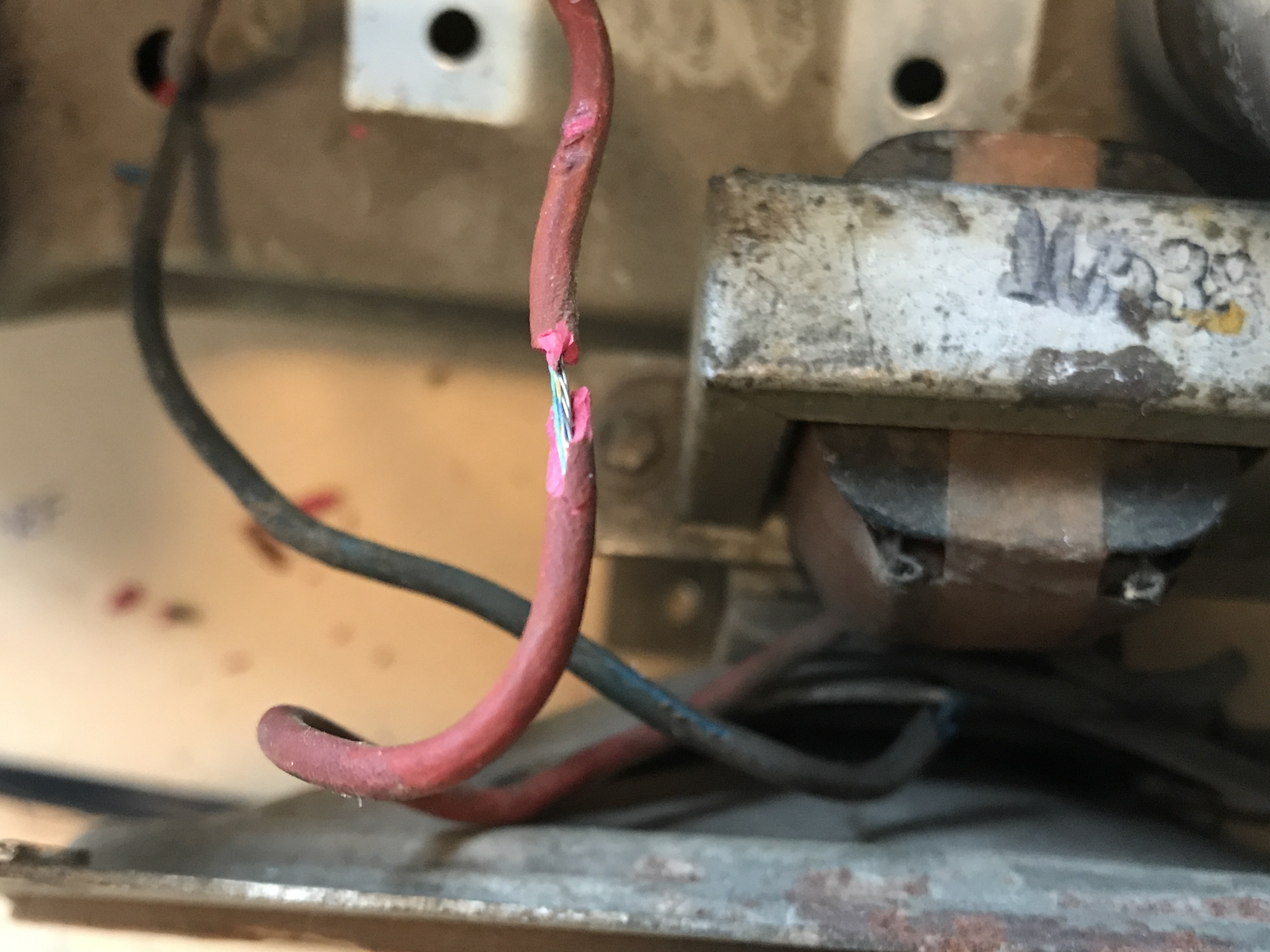

Okay...have one more question that again is a rookie wondering.  As I am looking more closely at the chassis and wiring, I’m noticing several wires are disintegrating from their age.  If I were to replace these, where would you guys recommend purchasing appropriate wire...and is soldering an appropriate process for the replacement?  Will attach a couple photos. Most worrisome is the red wire noted in these pics.

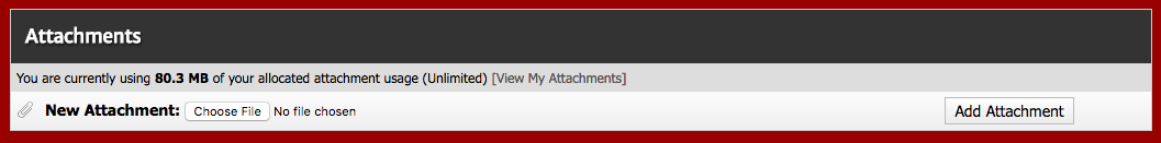

The simplest way to add pictures is with attacments.
Click 'Choose File' and select the image to attach.
Click 'Add Attachment'
Finally, click 'Insert Into Post'. You'll something like this show up in the text of your post:

Deteriorating rubber wire is a common problem. You can replace with new plastic wiring - RadioDaze is where I buy mine: http://www.radiodaze.com/22awg-solid/
Be careful to use the same length wire and run it exactly like the original (location matters).
Another option is to keep the original wiring but replace the insulation with similarly colored heat shrink tubing. Ron did this on his 41-226: http://philcoradio.com/phorum/showthread.php?tid=14923

Good idea to replace both of those wire as they carry the hv to the output tube.
OBTW not a bad idea measure the resistance between them to see if the output
transformer is good. Should see a few hundred ohms.
GL
Definitely replace those wires as they are starting to corrode, which will up the resistance and heat in the circuit.
Would loose any sleep over the heat generated at this point in the circuit.
Perhaps not so much heat would be generated, but that wire being corroded as it is would seem to me not so good, even if heat shrink was put over the top of it. You're just asking for it. That's strictly my opinion, mind you. Maybe it'll be aaaiiitte.

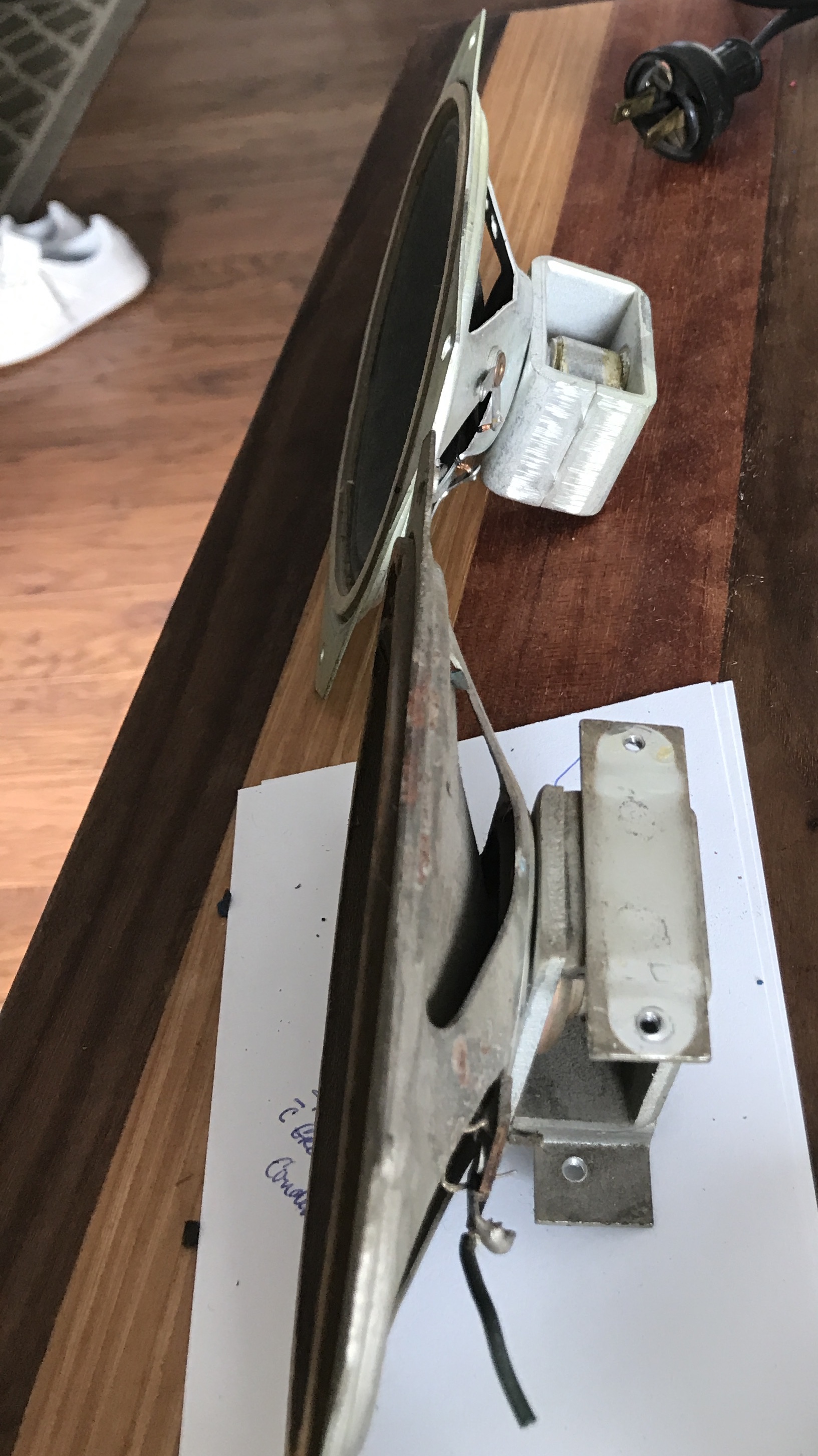

So here's my next hurdle.  I have some thoughts on the work around, but wanted some more experienced input.  Seems the NOS speaker isn't exactly a match.  Somehow need to attach it to the chassis and attach the transformer to it...welcome any and all thoughts before I proceed.  The old speaker is at the bottom of the photo with welded plates...
Maybe create similar plates out of aluminum (or other) stock? Then use JB Weld to attach to the replacement speaker.
I was about to say the same as Nathan did.
Will need a hefty amount of the epoxy to hold it to the chassis bracket as there's a large leverage. Same about the transformer. But it is doable.
