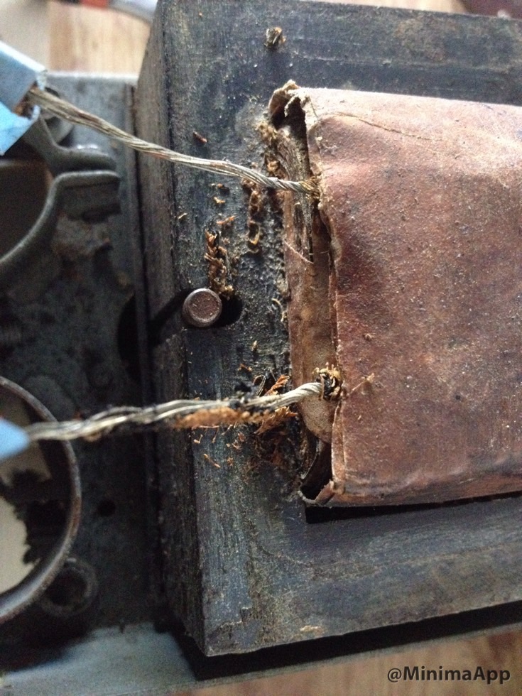

This is the "insulation" of the transformer, many wires are like this or are like glass when I bent them

<many wires are like this or are like glass when I bent them
Generally I don't go out of my way bend wires as they are brittle. On the later Philco models (1939-42) and a lot of other models rubber covered wire was used. The rubber coating turns to dust when looked at funny or touched. These set usually require a good bit of rewiring to get them back in good order.

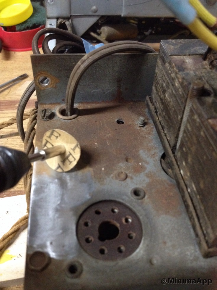

Today I will keep cleaning tunning assembly, I am going to paint chassis after derusting, hope this way will look close to zinc platting and preserve it for future restorers.

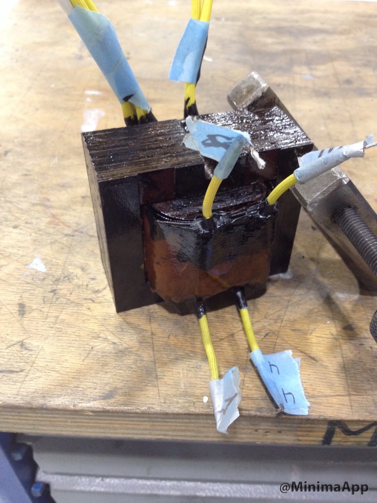

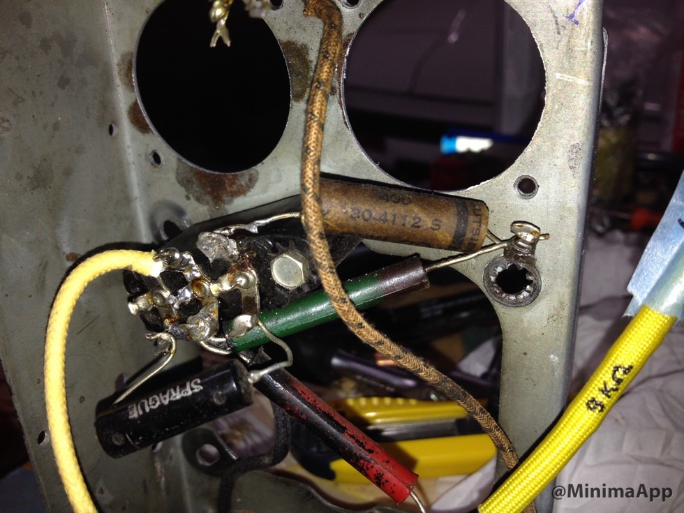

Today I removed the power transformer, I must re insulate all with Heat shrink and glass fiber jacket, the bakelite capacitor have a sprague that looks suspicious, maybe for simulate the twin bakelite? By the way Ron, Thanks for the link, now make sense the resistors Icon_smile
Transformer done, new insulation and a light coat of varnish to preserve it, also I applied liquid tape where the wires come out just in case, hope is correct to do this.

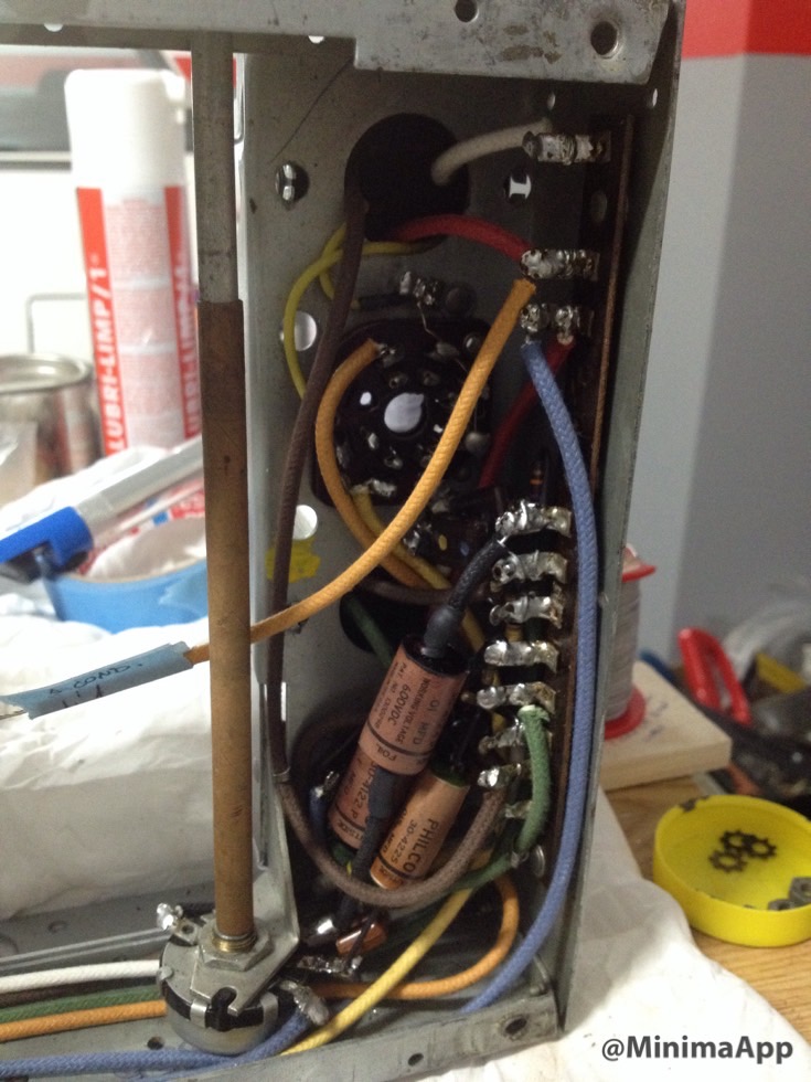

After a bussiness trip I got some time to work in the set, I changed all wires and caps ( I used custom made stickers for simulate old ones) I found the bakelite one empty, reference says it is a single cap, I restuffed it with high voltage one.
