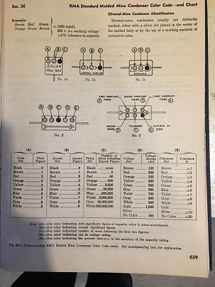

How do you read 3 dot rma code when middle dot is not colored ?
Since the body of the mica is brown does that make the center dot brown?
Danny
I would think so.
i ran into this same sitation but on six dot.
body was brn then i began to notice the paint color had been worn off with time on some others so i had to discard ones that i knew were damaged so to speak.
I had tan body six dot micas with a tan body, yet the layout of the dots did not integrate a "start" point, no arrow or nothing.
in cases where it was obvious, the dot being brown, there was not a dot of brown paint used , the body itself made up the dot color,, meaning a value of 1
Here is information on the mica codes...
