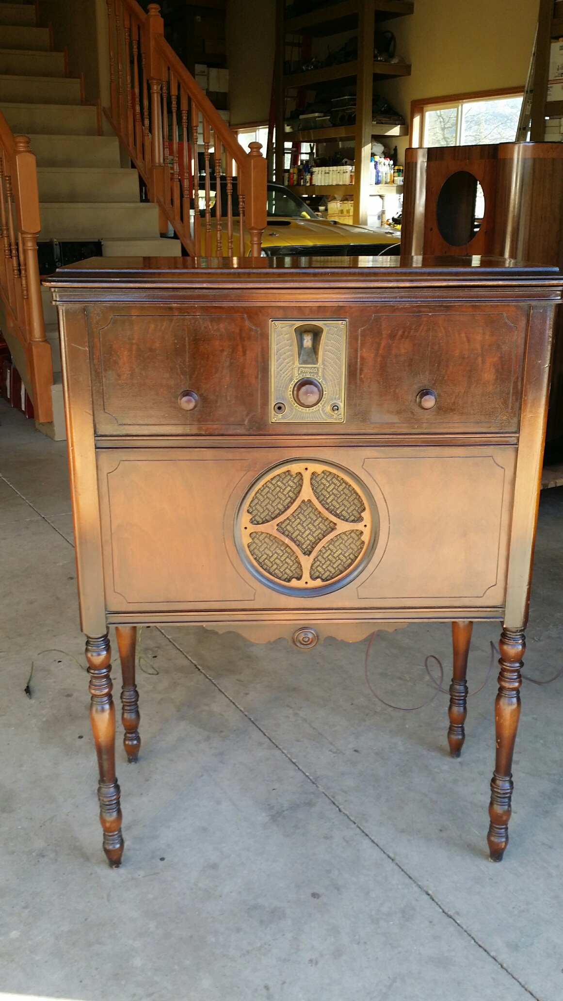

Here's another one on eBay, but he wants to sell with a group of consoles.  I messaged him asking for a pic of the back, but haven't had a response yet.
Does the coloring on the cabinet look more authentic than the one Willy is offering? Frankly I like it better, but he wants local pickup, and lives halfway across the country from me.

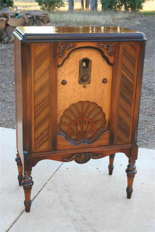

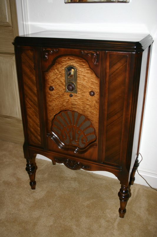

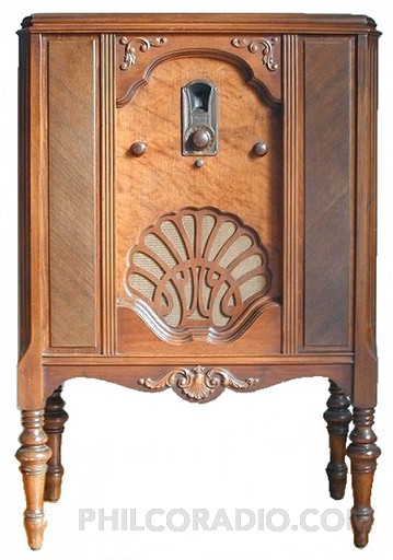

Fifties - Hi,
Here are some of those cabinets that I have done. I think that I got the colors close.
This is a 95 (yes, still in the bathroom)
Here is an 87
This one I sold.
Here is an 86 with original finish. Also sold
You can see that the solid legs/frame has highlights.
Those look nice, Russ!
