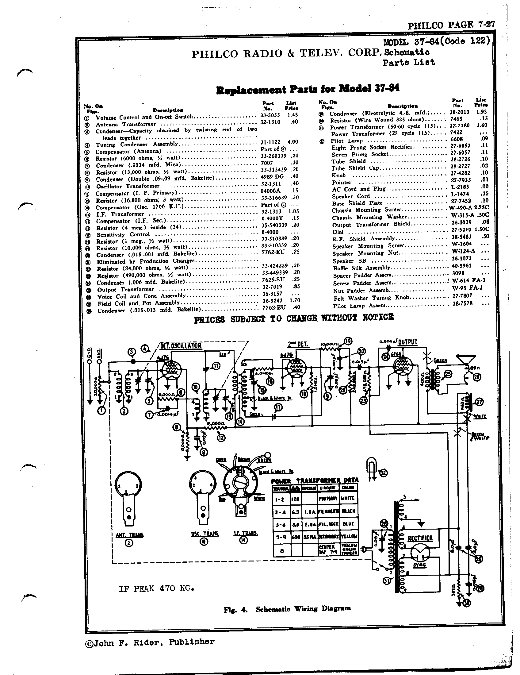

Here's the schematic:

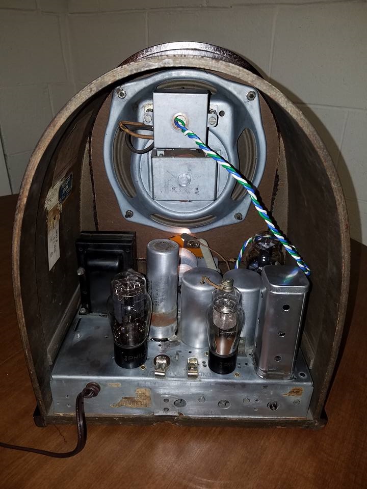

I rewound the primary of the OSC coil. 16 turns of 38 ga wire. Same direction (clockwise) as the original. When I used a bit of low heat from the heat gun to melt the wax over the original winding to remove it, one turn of wire fell off. Guess I found the break right away! Took off the old clear ring under the winding and replaced it with a strip of thin clear mylar. Now I will be the first to admit I am not very good at winding this tiny wire. There are gaps between the turns. It ain't pretty. Not sure if that matters much if the turns are touching or have a gap between?
When I gator clipped it back in, I get very faint reception when I clip my antenna wire to the ANT clip on the chassis. Pretty much what I was getting when I gator wired in the OSC coil from the model 89 I was trying.
With my newly rewound OSC coil from this set, if I move the antenna wire to the center tap of the volume control, it made no difference. This is I essence Pin 2 or the primary of the ANT coil.
Now if I put the antenna wire on Pin 3 of the ANT coil, or the secondary, I had steady wide open volume and received many stations up and down the dial. So, despite the gaps in the windings, I think my rewound OSC coil is working.
I can measure resistance with the ohm meter on both the primary & secondary of the ANT coil, so either the coil is shorting between the windings, or one of them is partially open. Or the volume control could be a problem...
The schematic shows it should have a 20K ohm volume pot, but this set has one (stamped Philco and looks factory correct) that measures 600K ohms. So I tried one I had on hand that measured 100K so see if it made a change. It didn't.
So I'm thinking I should just let the OSC coil as is, as it seems to be working, reinstall it and concentrate on the ANT coil? I'm guessing, as you thought, the outer winding on that is bad too.

Thanks once again, Terry. Here's the progress report:
I did the OSC test with a second radio. I had this 37-84 set to 620 AM on the dial, and the second radio set to around 1100 and could hear the OSC coming through the test radio. The station didn't come through but I knew I found the OSC, as when I turned the 38-84 off, I got normal static on the second radio. Repeated the test with another restored tube radio and got the same results. Now the rewound primary on the OSC coil still has gaps between the windings, but the right number of turns and wound in the right direction. I'm getting a lot of stations (with the test ANT coil...see below), just not the strong local one at 1470 but I suspect I may need to do an alignment to find it. So I'm kinda on the fence if I should try rewinding the coil to get the windings closer or leave it as is?
I unhooked the existing ANT coil wires (which measured 2.6 ohms on the primary and 5.7 ohms on the secondary) and gator wired in the antenna coil I have from a parted out model 89. That primary measures 16.5 ohms and the secondary 9 ohms.
With the model 89 ANT coil, the radio has good volume and control of volume. And received lots of stations. Then I disconnected the model 89 ANT coil and  gator wired the ANT coil from the radio back in, not touching the tuner or volume control. With the ANT coil from this radio I have very low volume. Yet neither winding reads open. Possibly it's green spots cutting down on the volume? Or could the higher resistance on the model 89 coil be boosting the volume? I suspect rewinding the primary of the ANT coil is next. I'm still using the volume control that was in the radio, and measures around 500K. I'm trying to find one that measures 20K as the schematic calls for. Not sure how much it will affect the performance, though.

Hi, I am just a little curious as to how sensitive and good of a performer this set is? I've never seen a set like this where the signal goes right from the 1st det/oscillator into the second detector with no IF amp in between. I do see where cap 17 looks like gives some kind of feedback to the tapped IF transformer so maybe that helps. No RF or IF amp has me wondering! Thanks
Yes this circuit is called a regenerative detector and when adjusted properly has quite a bit of gain, much better that a simple diode detector. It uses feedback to amplify the rf signal and convert it to audio. It also can be quite selective depending on how much feedback is used. Not to be confused with a super regenerative detector which is very different.
