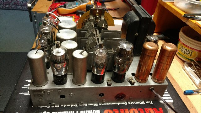

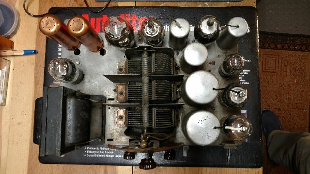

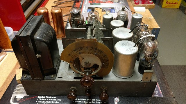

I recently acquired a Philco model 70, the serial number is A22192. How early is this in the production run? It does have the copper Mershon capacitors. Also, one of the 24A tubes was replaced with a 35, should I replace it with a 24A. The radio works great with lots of volume! Thanks.
Here are some pictures.
Nice clean chassis!

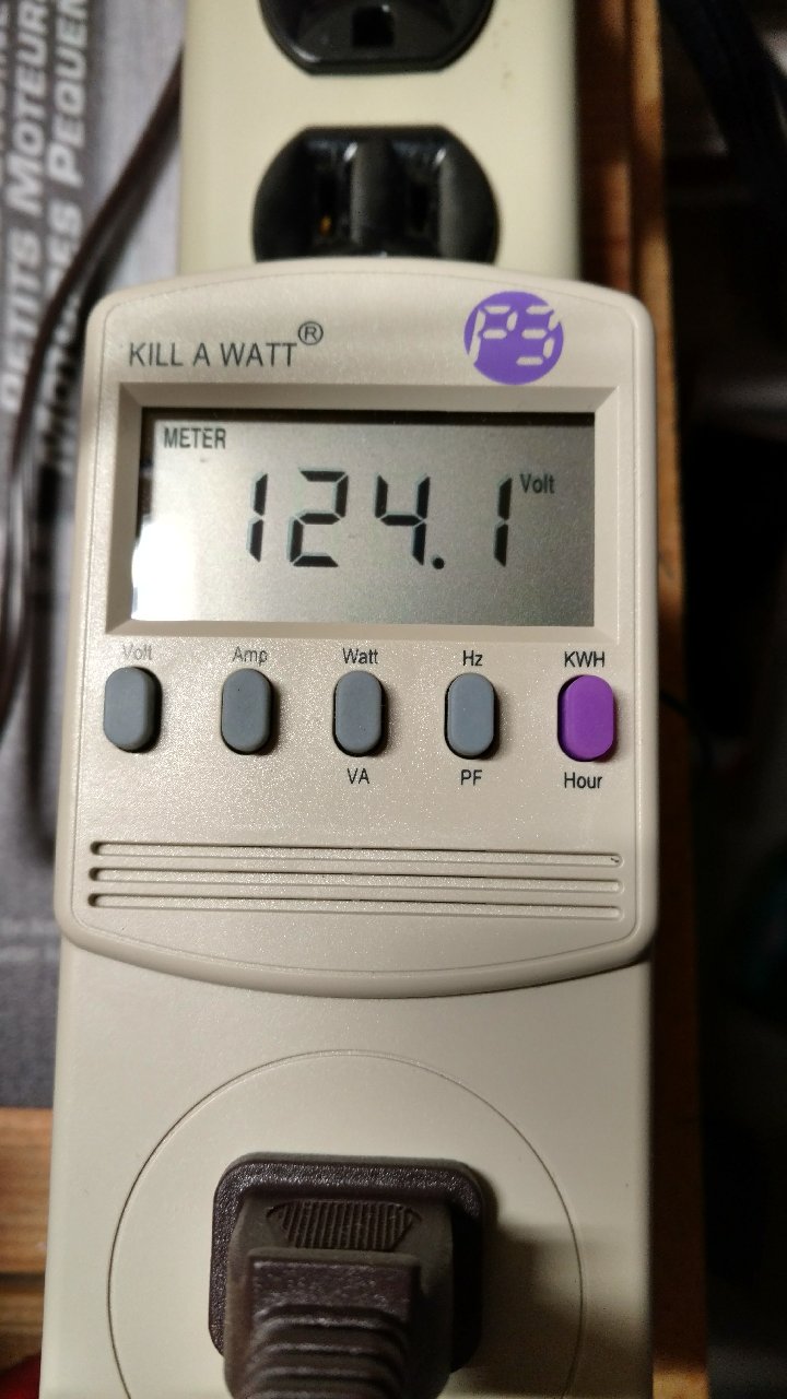

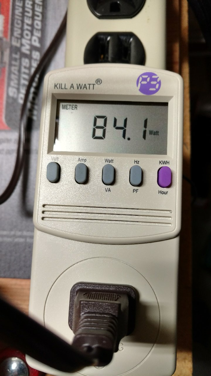

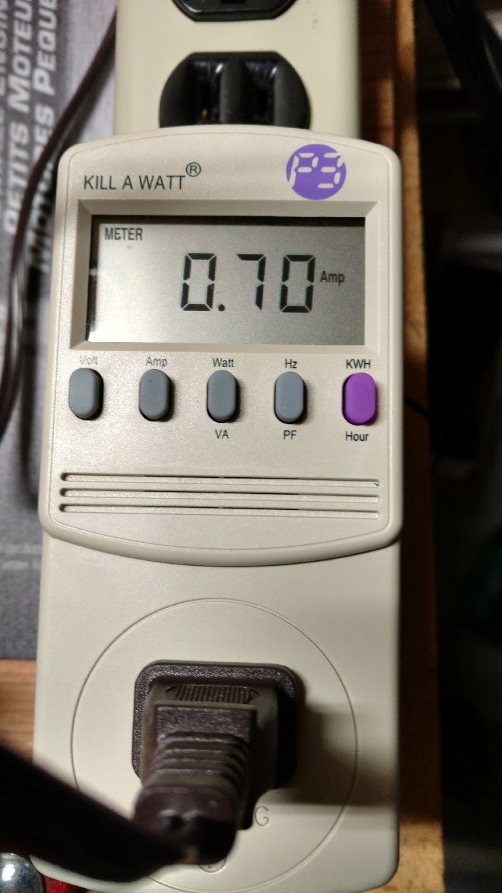

I just tried the 24A, no difference. It is the second detector. When working on a new radio, I usually use a Kill A Watt meter to give me some information, all appears fine.
