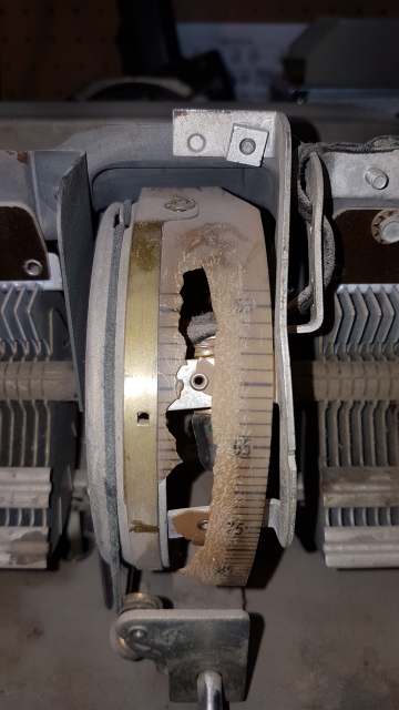

When I got this set the phenolic dial was smashed, see attached pic,   anyway I ordered a great reproduction from Radiodaze,  After I installed the new dial I do not see a light bar across the dial to pinpoint what frequency you are on,   Here is a link to a video on youtube to what I am talking about.  https://www.youtube.com/watch?v=MabzaMx9Lkc,   I went onto radiodaze site and they show a shadowmask for a philco 89 and 60B   but none for a 112B?  Has anyone ever made one themselves?  where do you buy the yellow Phenolic?   Now I wish I wouldn't have thrown away the busted up original dial!

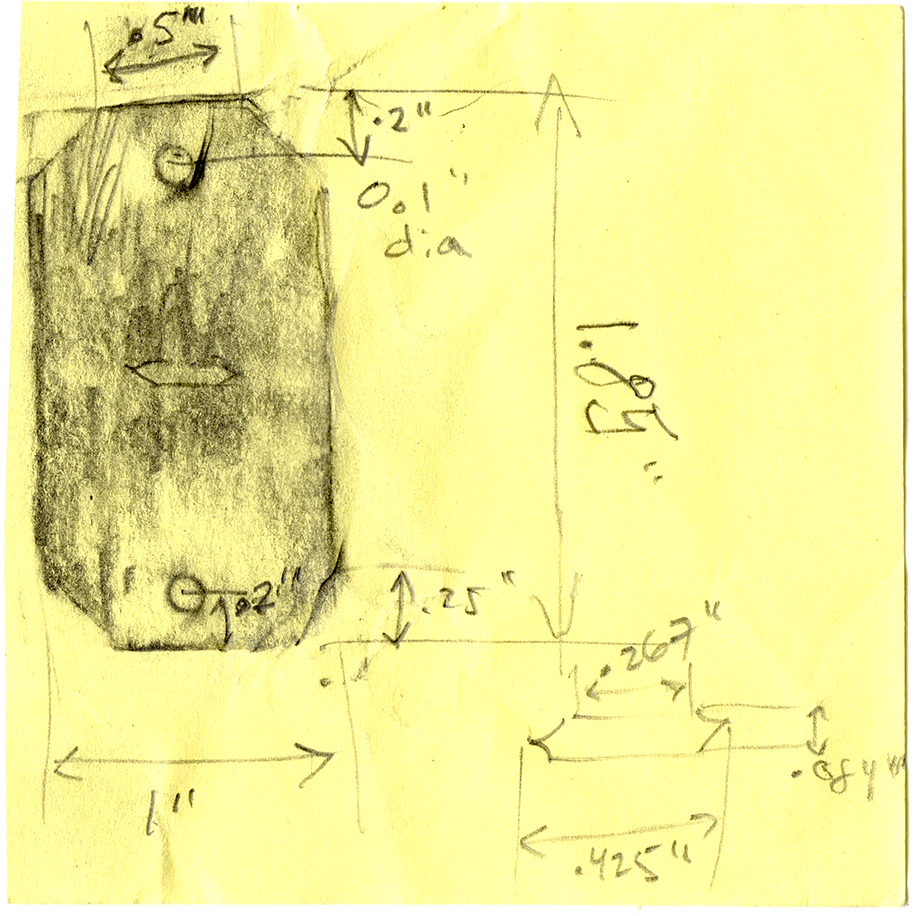

The mask is a simple enough. I actually planned to have my 112 chassis back out of the radio this weekend so I'll try to get a better picture and some measurements.

OK - so here are some detailed pictures of the mask and mount on mine:
https://flic.kr/s/aHsmhmi9au
Because the mask is curved I wrapped a piece of paper around it and made a pencil rubbing. I then took measurements with digital calipers:
I hope this helps and good luck!
Excellent Nathan! Thanks so much!   I have sent the pic of the exact dimensions to radiodaze for an reproduction.   Much appreciated Pal!
Great! Best case Radiodaze can make them available to all.
