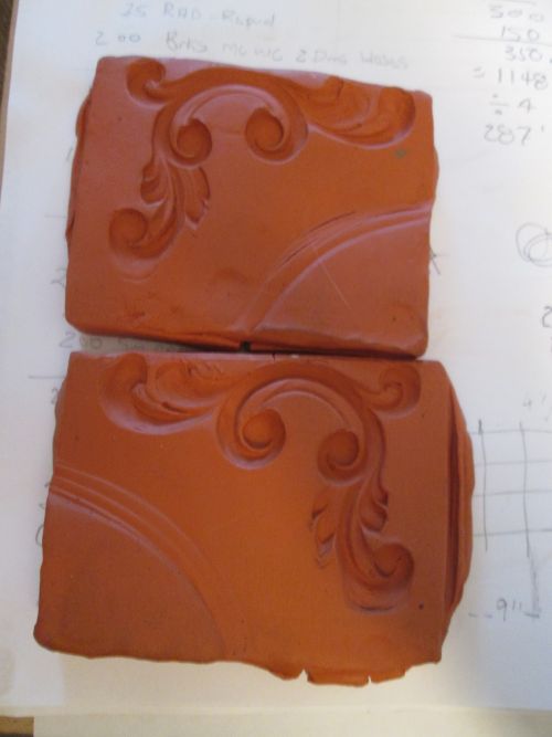

I found my Model 87 with the cabinet in pretty good condition, except for the two decorative carvings above and to the left and right of the tuner window.
One was broken and the other missing.  I'm looking to either obtain some, new or used.  Barring that, I think if I could get maybe a clay impression of them on another cabinet, I might be able to make some.  So I'm looking for options.  Any help would be appreciated.

Got some made with pretty good results.  Used Bondo Wood Filler in the clay impressions.  Not too shabby.

Well, got the carvings molded and lacquered, fixed some missing wood in the grille, and put in new grille cloth.  Thanks again Terry for making the impressions.  I'm going to make a spare pair and keep the clay molds, just in case.  Only had one small veneer patch on one side to do.  In the homestretch with the chassis.  Will need to make a new chassis cover for the bottom,  apparently didnt survive two house moves.  Things are lookin up!

That cabinet looks awesome, the moldings are excellent and the carpet achieves an harmonious ambience with the receiver. VERY nice! Icon_thumbup How are the repros attached as compared to the originals? were they pegged, screwed or glued?

Managed to use Gorilla wood glue to attach them.  Seems to work very well.
