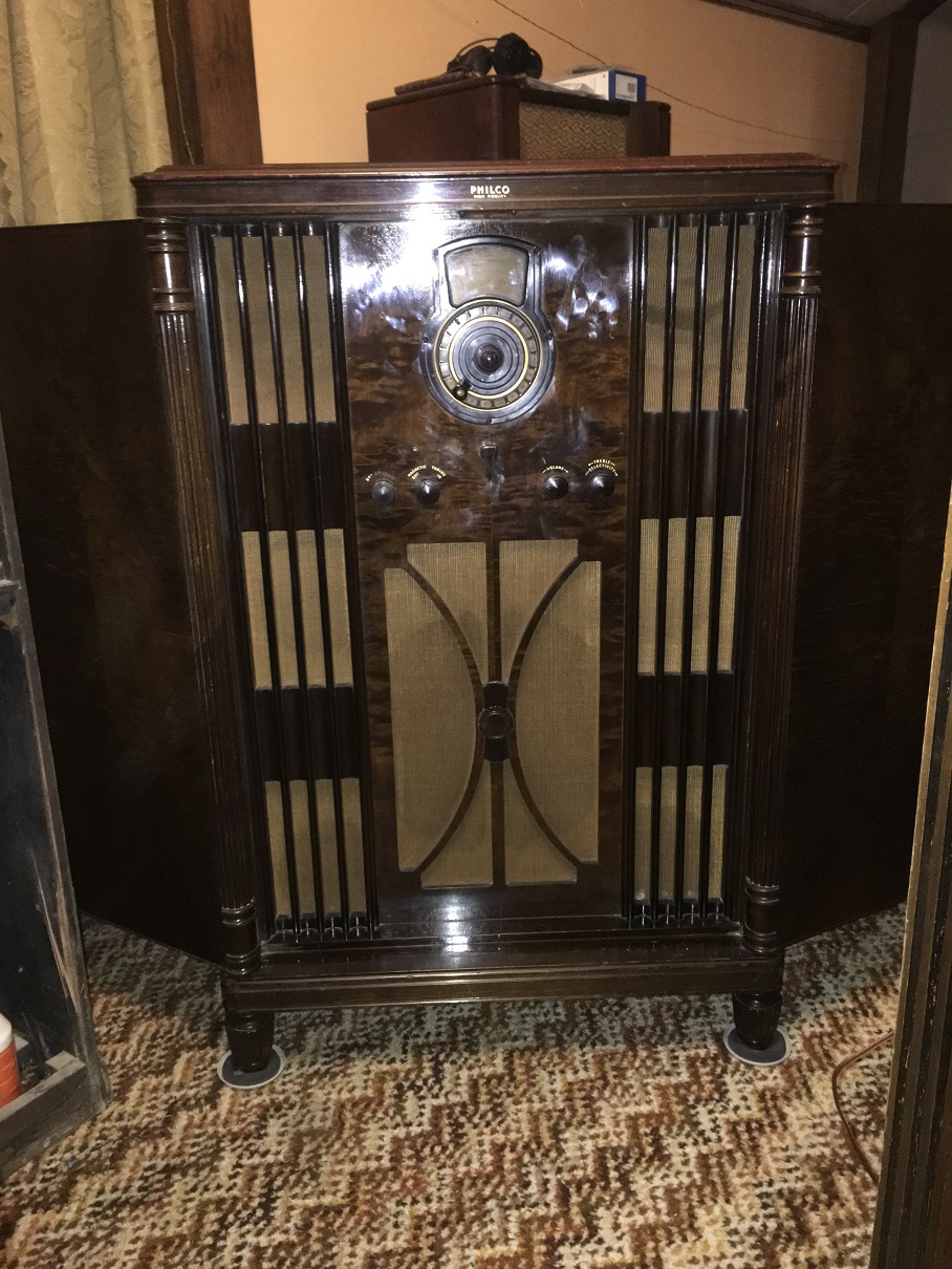

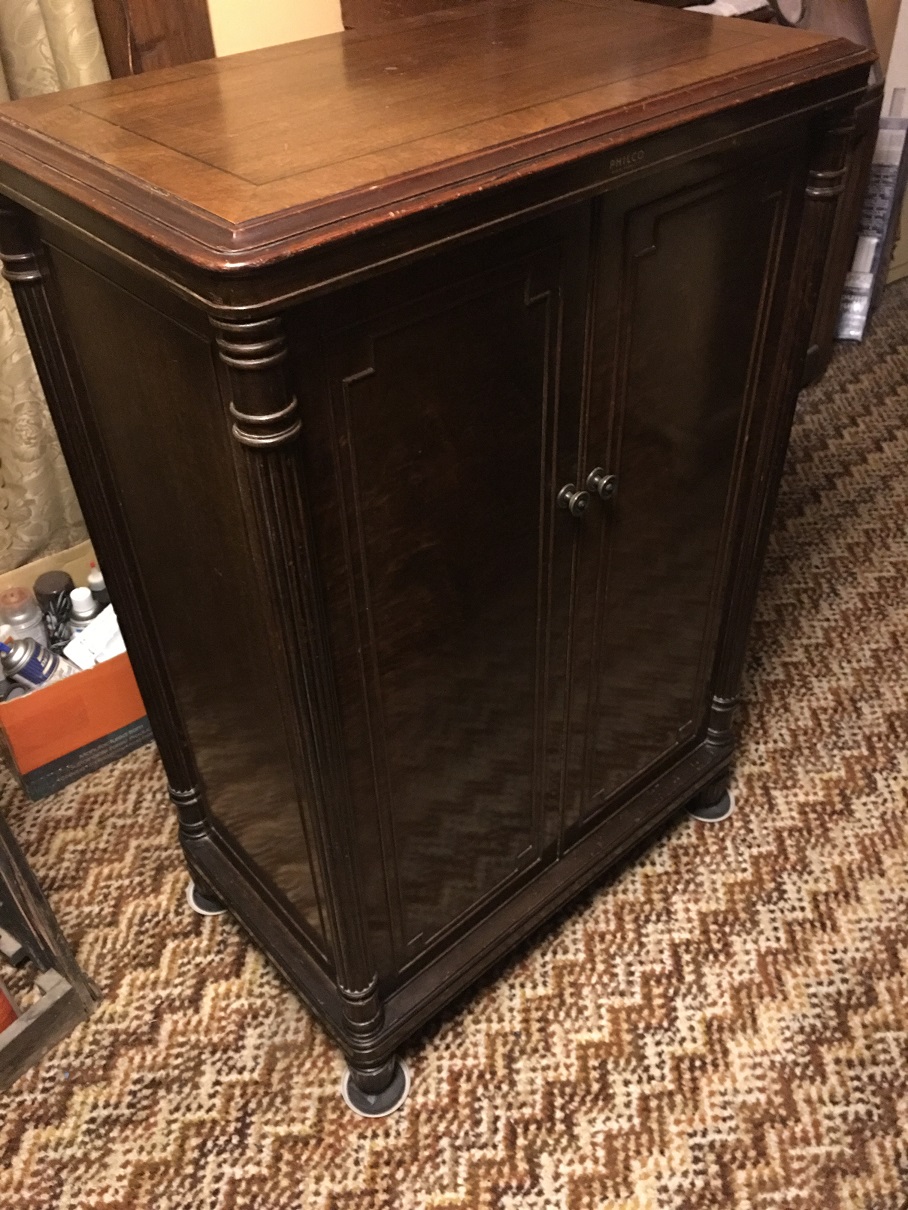

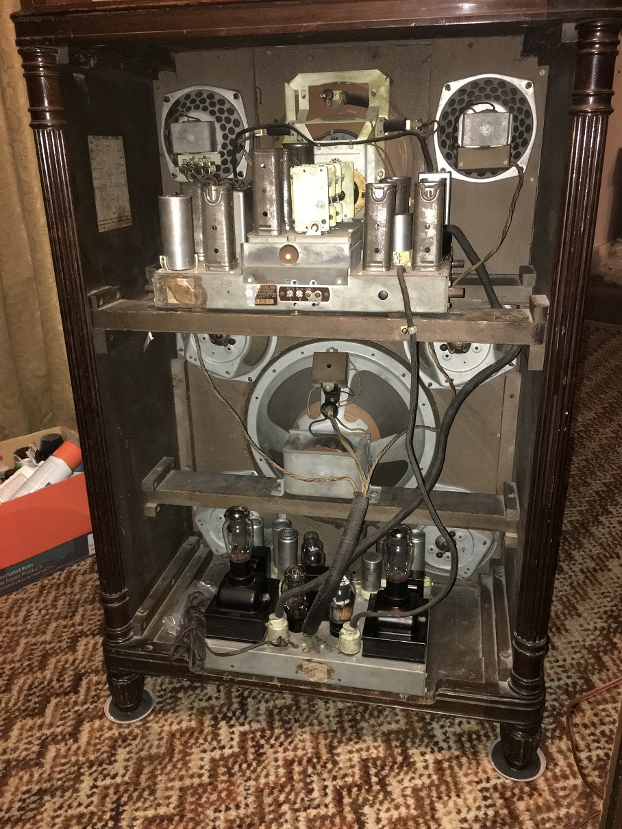

Hi Mike, not planning to power it up until all capacitors are replaced---both chassis are untouched underneath but not sure why the receiver chassis plate is missing. I got it cleaned up for now--just ordered all the rubber tuner & chassis support grommets and checking to see how many caps I will need to order. Looking forward to starting the restoration of the radio. Ken

Hard to find anything in that good of condition. What a great project and beautiful radio!!! ENJOY!!!
Yeas, very clean and nice.

If I had one I'd leave the doors open.

Looks like a beauty, no room in my inn for anything that large.
