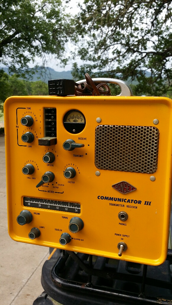

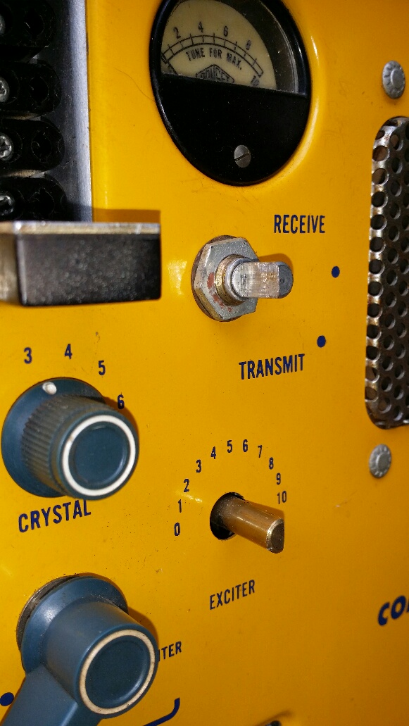

All,, Silly me didn't take any notes on how to get the Front panel back on.. Does it go on with the controls fastened with nuts already? or go on with nuts removed then put front on and secure with nuts..
Did I make any since? Hard to explain..
Skip
I can take a picture of one. Will that help? Yellow or grey?
Mine is Gray..
Skip
Well, the yellow one was easiest to find - - AND the answer looks like  - - both, but only two are to the front cover it's self.
Full size pics sent to your mail.
P.S. I see that this is a slightly different model, but still might help.
Yes, That helped a lot..
Thanks
