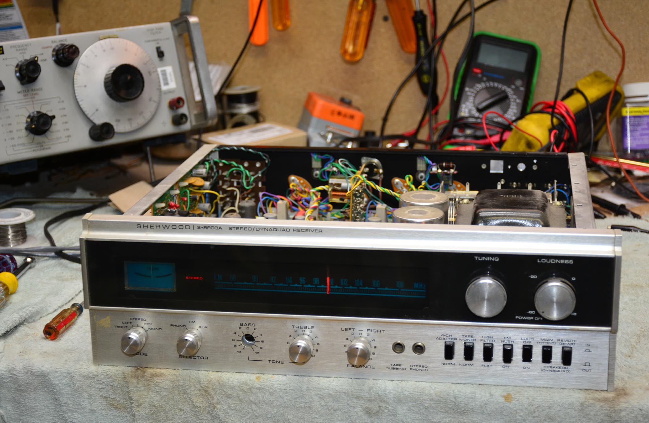

I'm working on a Sherwood S8900A that I bought cheap in the 1980's. It was cheap because the FM hardly worked. Lots of static when tuning, unreliable stereo when I did get a station dialed in. That was ok at the time since all I wanted was the amplifier for use at the office. I haven't used it in years. This thread caused me to dig it out of the equipment archives to see what I could do with it. The bass control is missing. I think I remember something falling on it and physically breaking the control so I bypassed it with fixed resistors at a most used bass level. I obviously must have changed one of the filter caps at one point though I don't remember doing it.
The static occurred when the tuning dial was turned so I suspected a bad ground or cross plate contamination. A solid blast of contact cleaner cleaned up the tuning cap and the static was gone and has worked great since. I found the alignment WAY off so i suspect someone tried to correct the problems by twisting slugs, gave up and traded it in. That's when I bought it. It is now working great with excellent sensitivity, great stereo and good sound. I've ordered caps to replace the filter caps (I will re-stuff them) and e-caps for the rest of the circuitry, just to be proactive. But I need help!
I cannot get the dial to track properly. Using the slug in the oscillator coil, I can zero in on the low end of the dial. Using the cap, I can set the high end. So, the two frequencies I use the most are dead on at 88.5 and 106.9. The middle of the dial is about 500KHz off. For 100.5, I have to tune to 100. It bugs me and no matter how much I diddle with the coil and trimmer, I cannot improve it. Does anyone have suggestions? Or, is there an instructional paper or video out there that I have not been able to find? Thanks for any help you give!

I've decided to blitz the thing. I'm mostly finished, just need to do the tone board which is mostly tantalum's. I'll wait with that until I get a new bass control cuz things kind of needs to be disassembled, knobs and all. It's playing again until then. I can't hear any difference but really didn't expect to.
Sensitivity is really good on this receiver. Stereo sounds great. Quite pleased. I don't really know what I'll do with it or where I'll use it, but it's kind of fun to get it going again.
Back to the original question - dial tracking. Any ideas/experience out there? I've gently played with tuning cap plate spacing but can't really say I've improved things. Not quite sure where or which direction to go with that. I just put it back to original.
Do you have the factory service manual? If not, you can get it from hifiengine.com, or I can send you a copy.
I would suggest resetting the high and low oscillator adjustments to close to where they were, and then try adjusting each one a little at a time until you get the band spread out to your liking. You may never be able to get the dial to track exactly with the scale but...sometimes, "close enough" has to be good enough due to aging of components, etc.

Yes, I have the complete manual with alignment instructions from hifiengine. didn't help with this. I may just have to shoot for a reasonable average and be happy. I was able to get the EH Scott 16A and the HH Scott 350D to track very close. I learned a lot from those, but it it didn't help with this one. I was hoping someone had a magic bend for the tuning cap that would help, but I guess not. This unit sounds better than I remember. But then, I have much better speakers on it now.

After a few hours of adjusting, bending plates on the cap, bending them back when that didn't work, tweaking some more, bending some more, and on and on, I finally got the thing to track reasonably. Most of the dial is now no more than about 100K off, with much of it much closer or right on. The only exception is the very lowest end of the dial where there is a jazz station I listen to at 88.5. It's at 88.7. Close enough! No more bending. No more tweaking. It has been a frustrating experience, but the unit sounds great. So, I guess it was worth it. Maybe it will replace the Scott 16A as the shop radio. Then again, I would miss the glow. The sensitivity is far better than the 16A. Not sure it should be so maybe I'll work a bit more on the 16A. Every time I play with the alignment on these FM units, I learn some more so maybe I can do a better job!
I wouldn't worry about any slight mistracking. After all, these weren't laboratory grade instruments.
