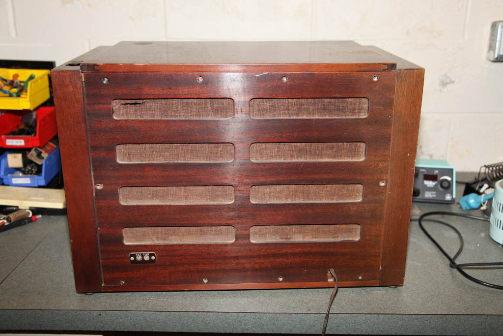

Tropic 53-960 restoration

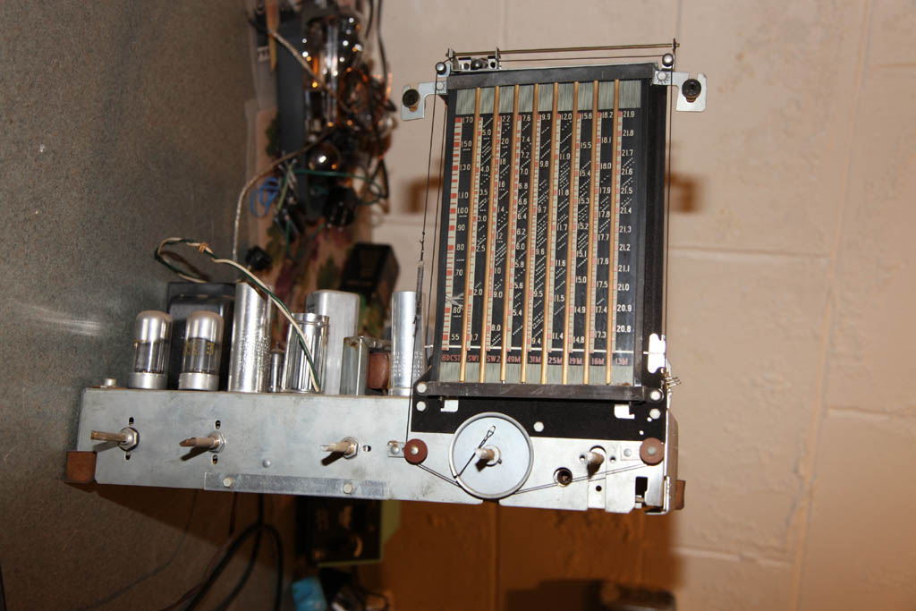

I bought it almost exactly 2 years ago, April 2016.
Eventually I thought of it...and put it on the bench.

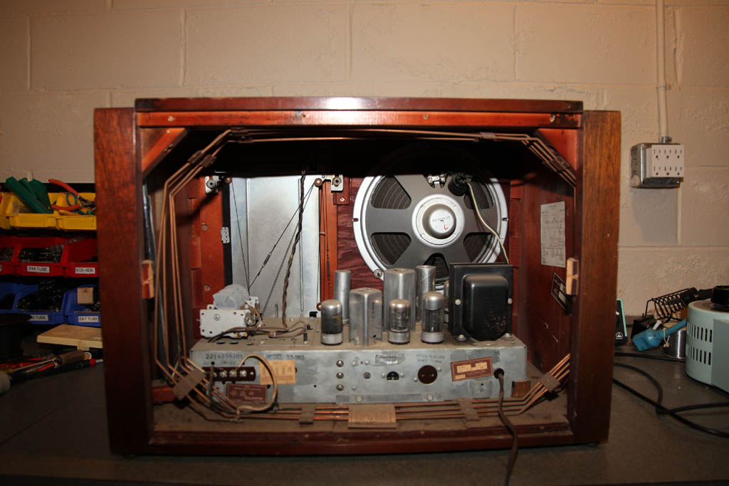

The radio is not in the worst of shape, in fact it is in pretty decent one, structurally good. The dial has a crack but Ron gave me a good one so I'm ok in this department.
Pulling out was easy after the loop antenna removal. For about 2 minutes I could not understand why it wasn't coming out, then realized I did not remove the knobs.
That's what one Guinness can to even a fairly experienced person.

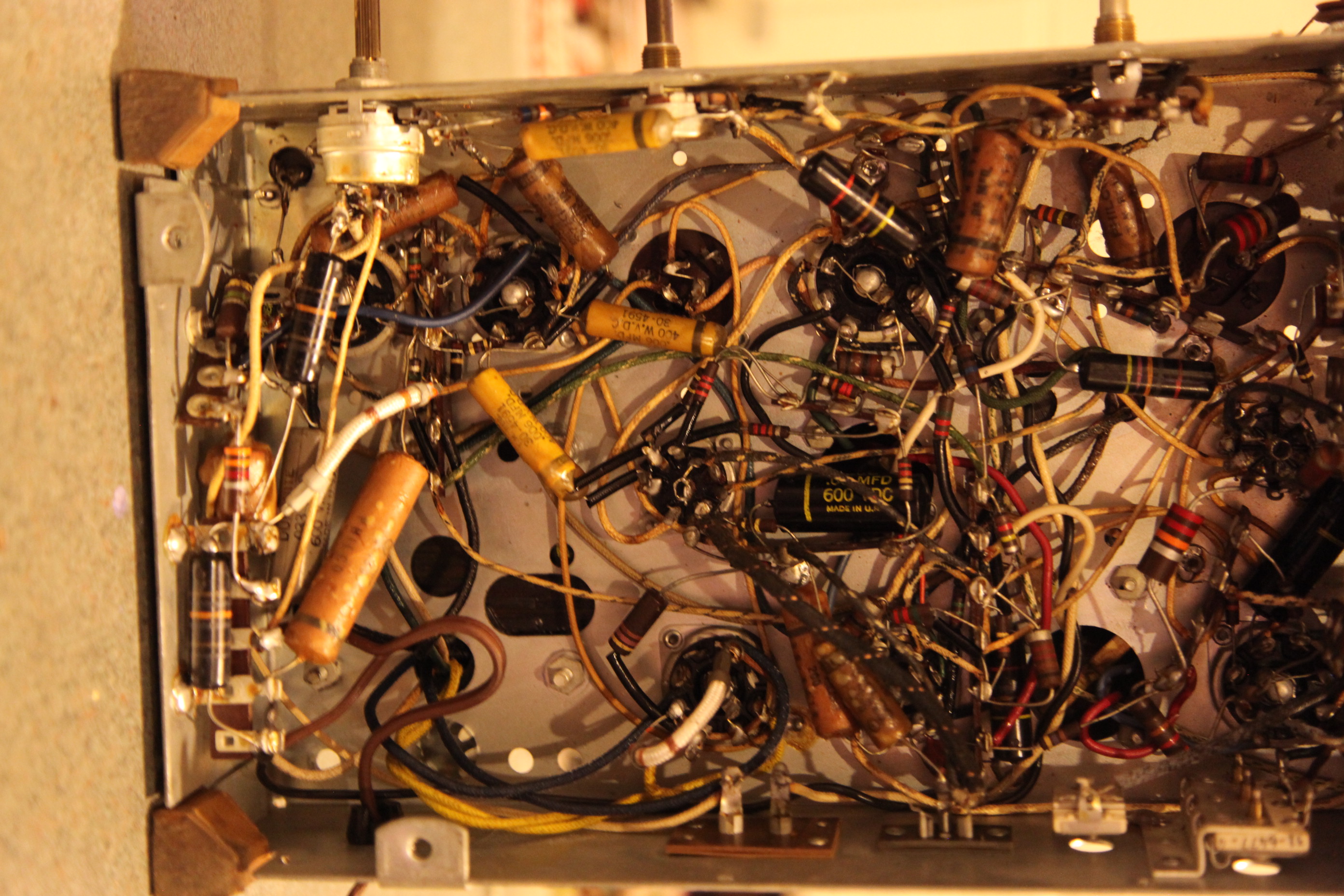

Initial photos.
As can be seen, some caps are those "black beauties / bumblebees", and I wonder - are those original or were those results of a repair(s)?
Well, I will start on the recap tomorrow.
My 53-960 initially had all paper caps save for a few Bumblebee/Black Beauty caps here and there, including the AC line bypass caps.

Here is a pic of my 53-960 I restored last year.
This is what it looked like underneath before I started on it.
Mike, Ron,
Thanks. So it appears the Black Beauties are original.
It would appear so.

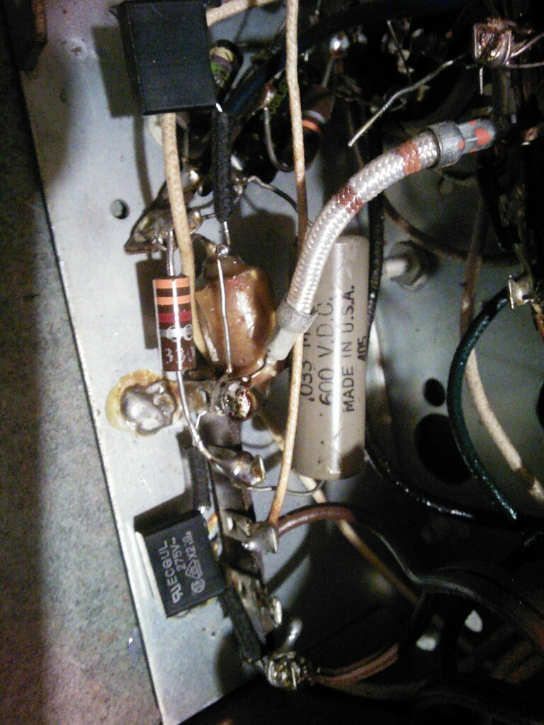

Noticed this what appears to be a coil and a gray large cap that aren't on the diagram. P!us some other parts.
Traced it to this:
Methinks it is an added phono input. The parts (a black Cornell Dubilier cap and such) tell me the mod is also 50s or early 60s.
Upon checking the two caps (grey 0.033uT and a black beauty 0.005uF) they are right on the money.
So the change is probably 60s. Leaving them in. Then again, I don't intend to use phono input.

Those aftermarket phono jacks are often troublesome, with few exceptions the people that put them in were weekend mechanic types who knew barely enough where to connect them. I usually remove them since I really have no use for the jack, or the crappy soldering they used to install them, I have enough radios that came with them from the factory with the proper wire dress and shielding if I want to play records, or tapes, through a old radio.
Probably a good idea.
I have undone all of that mod. I'm not even sure what it was. The center pin of the connector connected to one of the output tube's anode via a resistor and then some caps and inductor followed. I fgured I won't need it so why adulterate the schematic.
