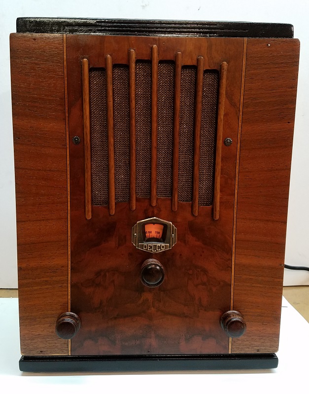

I picked up a small tombstone Delco radio at the last WARCI meet earlier this month rather inexpensively. It's a 1935 model R3202:

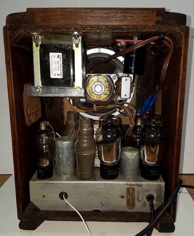

The problem I've encountered is an open primary on the detector coil. Number 6 on the schematic. It is not a straight forward coil with two distinct windings, but rather has a wire running up through the tube, out a hole in the side, around a couple of turns, back through the hole, down to the other end. In other words, it would be very difficult (for me anyhow) to rewind properly. The secondary measures 11 ohms, but I have no idea what the primary should be.

Success! Got it working again. Thanks, Terry. Much appreciated. The radio was a bit of a surprise, to me at least. There are no electrolytics, and the ground wire doesn't go directly to chassis ground, but goes to a .25 mfd cap first...the largest value cap in the set. Odd too that for a 32 volt farm radio they'd have two 6D6's and two 48's. Seems like a lot for a little one band 6 tube set!  But it turned out decent. It was a $20 purchase and was in filthy shape when I got it. Full of mud and mouse nests. Mickey had quite a feast on the cloth wires too!
