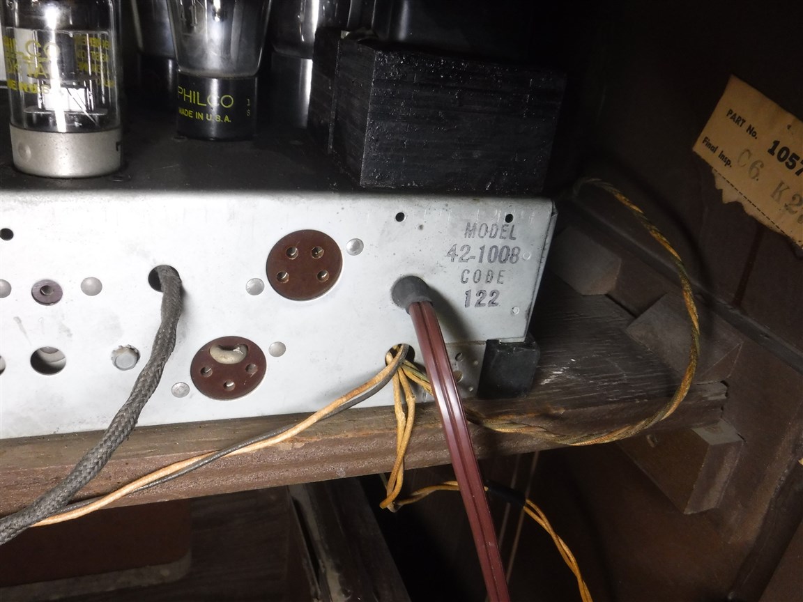

Bol not working ,will be sending it to Antique sound in CT. for a rebuild. He refurbs the BOL,radio all ok. Dead silent without ant. connected volume wide open. Amazing!!!
Heres a fuzzy pic of results.
