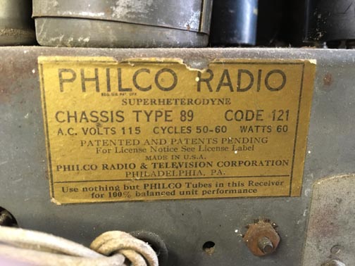

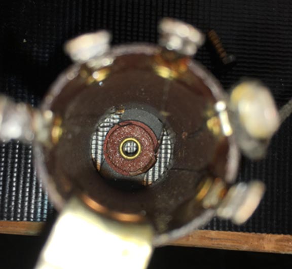

I have started on a philco model 89 code 121  It has a 36 tube for the oscillator circuit.  The first coil checked  (Input to the RF amp ) has an open primary, photo attached.  What is the best way to approach this?  It appears that I will have to cut The coil out from the cylinder, rewind it and glue it back in.

Had to rewind the primary of L2.  It wasn’t pretty but it works.
Nasty winding that much fragile wire on such a small spool.
