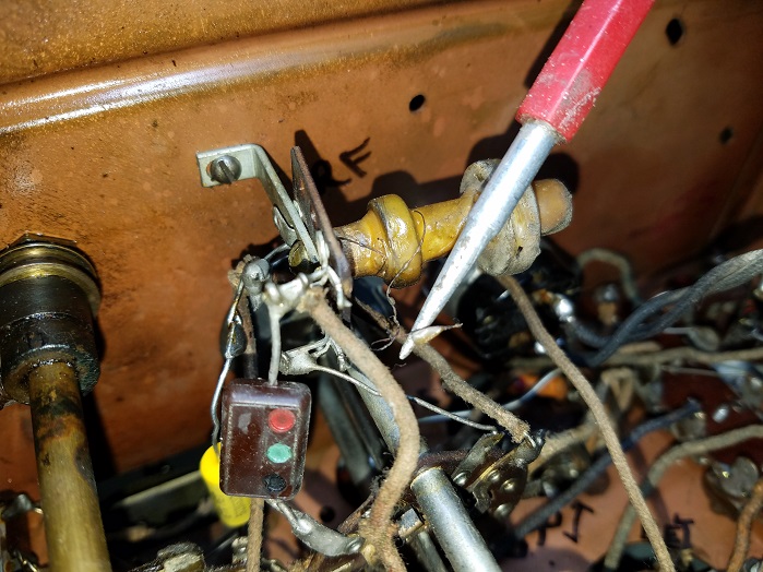

And Tony, you were right on the money. Look what I found on the RF coil:
There are actually two separate broken wires on the coil. This one is just the most visible. It may be hard to find the other stubs where these wires came off of. Will have to take the coil out tonight and get out the magnifying glass. I suppose I could just use one of the universal RF coils from AES, too?

I think your coil pictured is #14 the RF choke. These are notorious for being broken or eaten by mice. They will cause similar issues like you described. B+ is supplied to the RF amp plate through it. It’s very likely you have no plate voltage. Someone might have a better idea how critical it is, but with multiple taps I suspect it’s important.

Before I did anything with the RF coil, all the set would do is squeal in the distant position. After removing the RF coil, I found out just how bad it was. Multiple strands of wire hanging off of the secondary winding. Not good
No matter what combination of wires I tried, I could not get continuity through that winding. As a result, I had nothing to go on as far as reconnecting the broken ends. It would've been a shot in the dark. So I went with one of the universal replacement RF coils from Antique Electronic Supply instead.
With that new RF coil wired in, I can now find a distinct change in signal strength from local to distant. It's quite a bit louder when I switch to the distant position. So I feel confident that at least that part is working. When I remove the antenna wire I have clipped on the A terminal, it gets much quieter, so it appears the antenna coil is working as it should too. The set isn't as sensitive to receiving distant stations yet, but I suspect I need a longer antenna wire than what I'm using. That, and perhaps a better alignment might help. I'd have to think if the RF and the ANT coils are now working, the DET coil would have to be as well?
