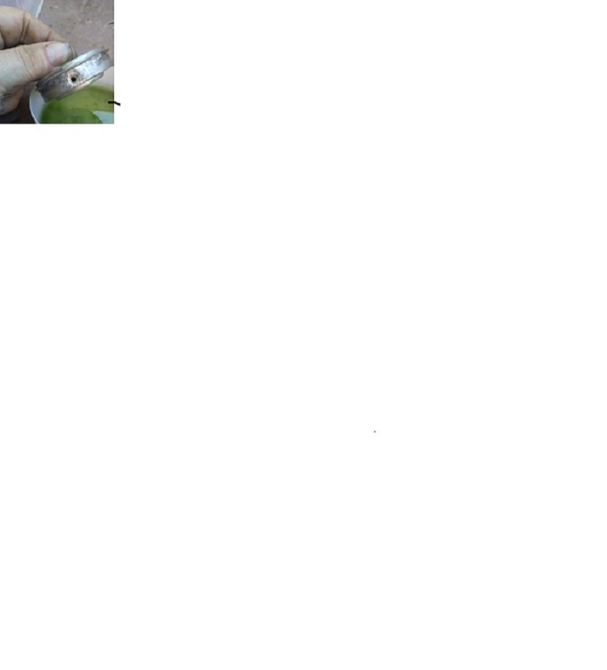

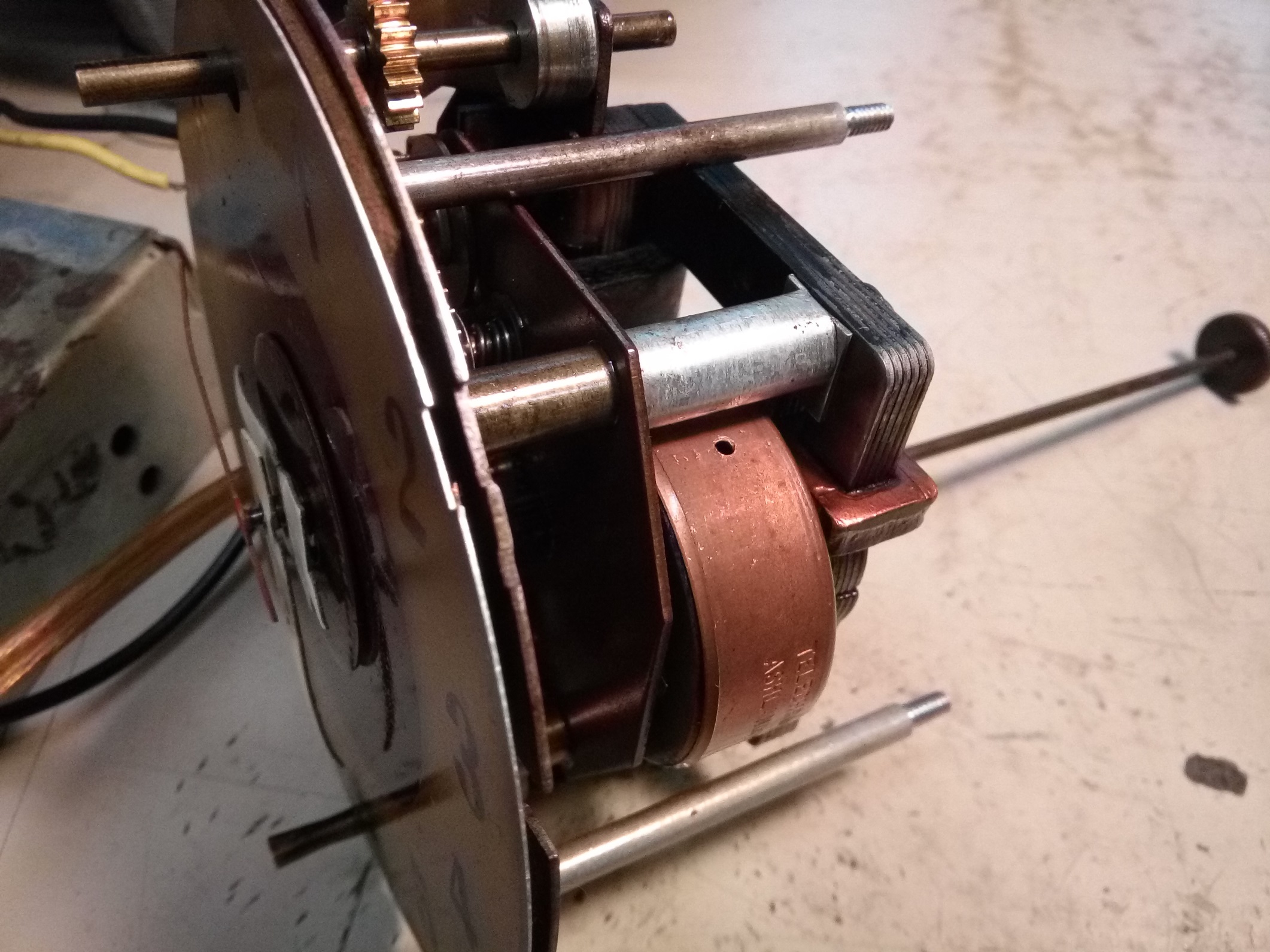

Against the suggested practice of torching the metal housing apart, i thought up using my smallest drill bit to **BY THUMB AND FINGER** rotate the bit to gently penetrate the "top" of this case.
dipping in and out feeling around with my tools you run directly into a gear about 3/16'' where my hole is now.
so... dont do a hole dead center top. make the hole favoring either side of center and you will *not* risk hitting a gear.
i guess the advantage of being centered is you instantly get to drop in lubrication atop a gear just below the hole, its up to you.,, but to me the torch method in a vice to pry open the whole assembly makes me think that it would make it very easy to damage the whole assembly. this seems to be the least intrusive way to revive the gearbox and time accuracy.
apparently the case is 100% copper!  i was in there in less than 5min.

other info states a lithium type/looking grease may have been used inside the gear box... CONFIRMED,,, the color of my grease was purple when i flushed it out with thinner injected by a needle syringe used to fill printer ink cartridges.
I injected a boat ton till full of transmission fluid. > dont do this!
the physical weight of that amount of fluid slowed the gear box down to a crawl,, or... the conductivity of the fluid slowed down the magnetic field the engineering required to spin the center gear shaft.  I guess this original grease might have been thinly applied or to a degree , somewhat non conductive.... dono... but i had to reflush with thinner and spray carb cleaner again using the syringe.
i dry tested and it was noisey but really fast moving so i know now that it was ok to add "a lot less" trans fluid lubrication.
its ran for over 48hrs and the minute hand is dead on with all my other digi and analog clocks so i guess its all good.
