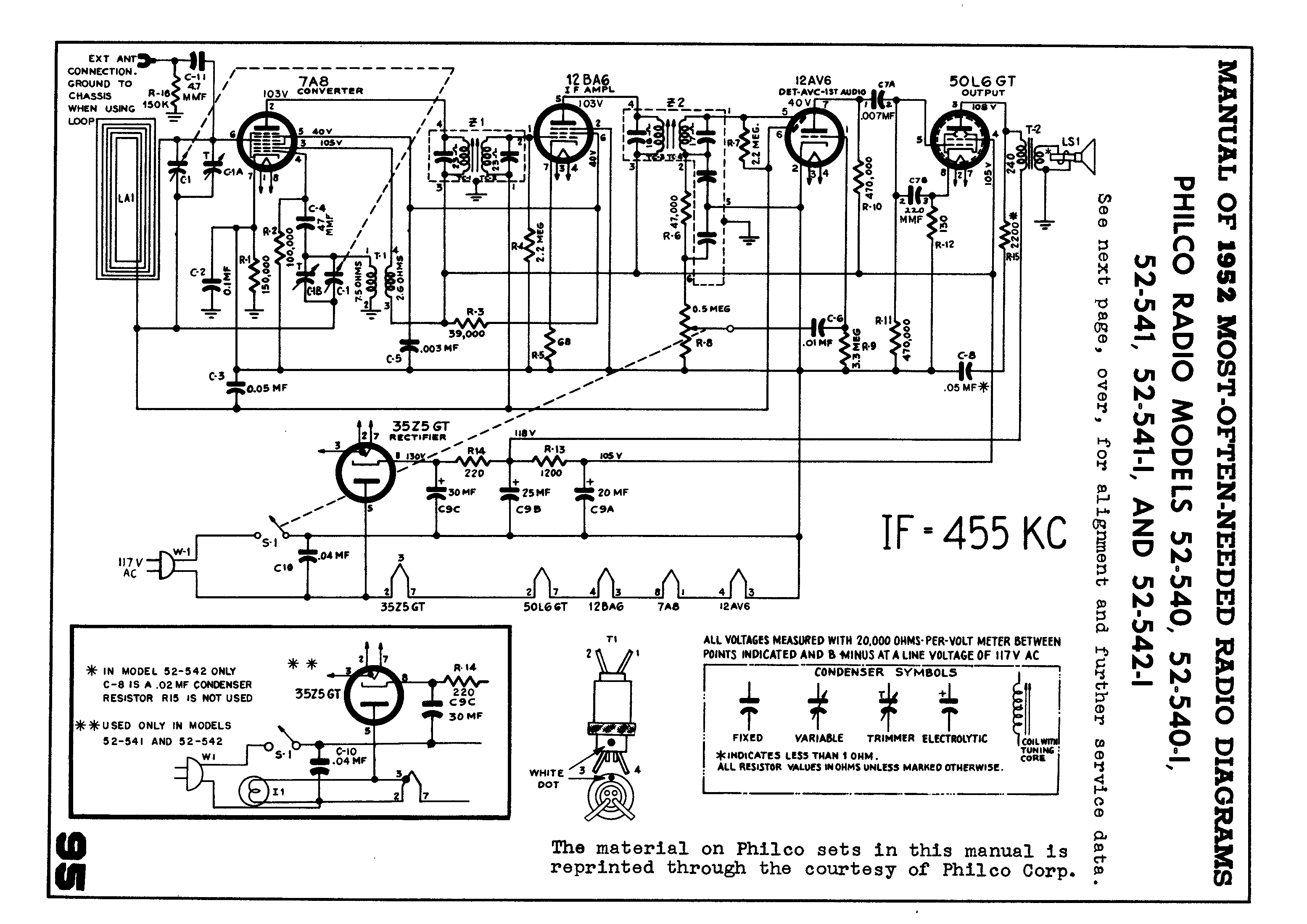

The radio being AC/DC set, the lamp and tubes not glowing means there might be a tube with open filament. Check the tubes. Also if there are loctals, their pins oxidize - need to be scratched.

Here's the schematic pages from Nostalgia Air, which includes the parts list:
http://www.nostalgiaair.org/pagesbymodel...013741.pdf
