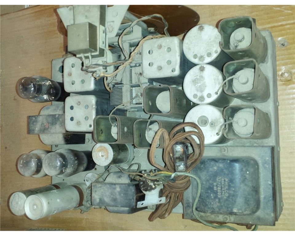

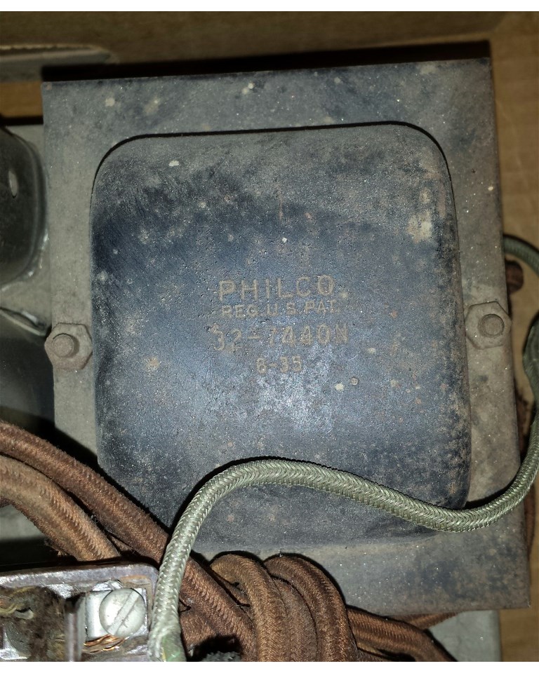

I believe this to be a 650 chassis, which I'd like to confirm or correct if necessary. I've heard others call it a 36-650. Does the "36" refer to year of manufacture?
Also, is the "8-35" on the transformer a date code?
Thank you again, Greg

The year prefix (37-XXX, 38-XXX, etc.) wasn't used until the 1937 model year. So a 650 is only that (not a 37-650).
The 37-XXX models were also the first to have the
much maligned separate RF chassis / 'unit construction'.

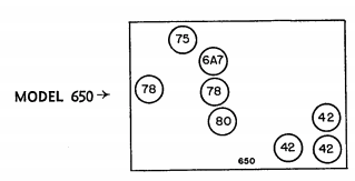

Anyway, based on this info:
http://www.philcorepairbench.com/socket-layouts/
I don't think that's a 650 chassis.
Maybe 660?

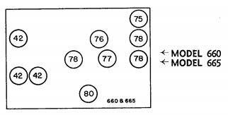

Do the tubes in the chassis match those in the socket layout diagram above?
Does the number of bands on the dial comport with the description of other 660 chassis models in the Gallery?
http://philcoradio.com/gallery2/1936a/#Model_660L
Does the component placement and part numbers line up with 660 service info?

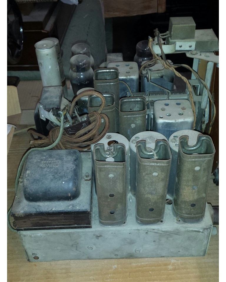

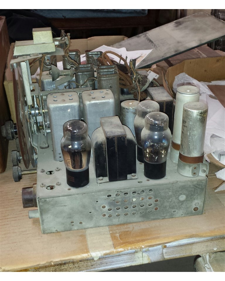

It looks similar to my untrained eye but I'm not certain if the tubes marked 76, 77, 78 & 80 match up with those in your diagram?
Image(s)
(This post was last modified: 07-05-2018, 05:41 PM by
GregL .)
Posts: 1,909
Threads: 216
Joined: May 2015
City: Seattle
State, Province, Country: WA

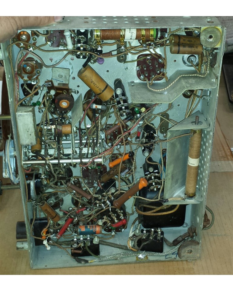

It might be helpful if you could provide a photo of the underside of the chassis.
Another great data point would be the part number printed on the dial.
As far as I can tell that particular power transformer is consistent with model 660 - and I couldn't find any other model that uses it.

Could this be the dial part number? 27-5115
Can't be anything other than a 660...or it could be a 665 (same tube lineup, very little differences between the two).

Here is the underside.
Image(s)
Amazingly clean. Unusually clean. Wow. I almost never see 1930s Philco chassis that are this clean underneath.

Offhand...no. Same number of tubes, same tube types, same band coverage.
Any competent repairman will compare the service data between the two, comparing this also against your chassis, and making a final determination.

OK, so the 665 is probably just a revision of the 660.
Am I correct in dating this chassis as a 1935?

I gave the 665 info a quick look and I did see that it has the correct alignment for the bcb. On the 660 there's a misprint and a note correcting the misprint.
