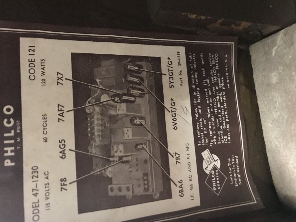

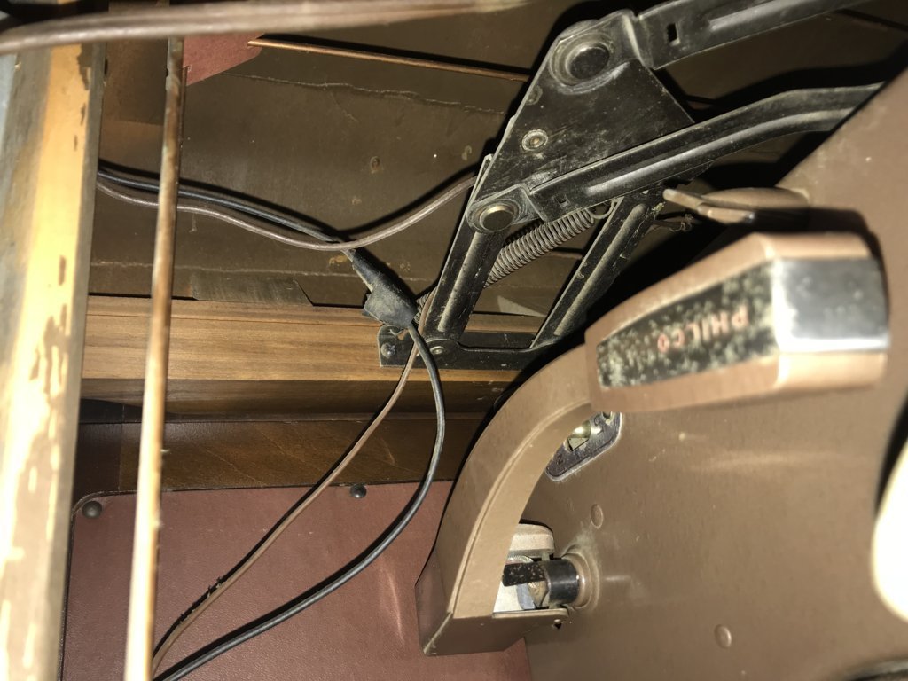

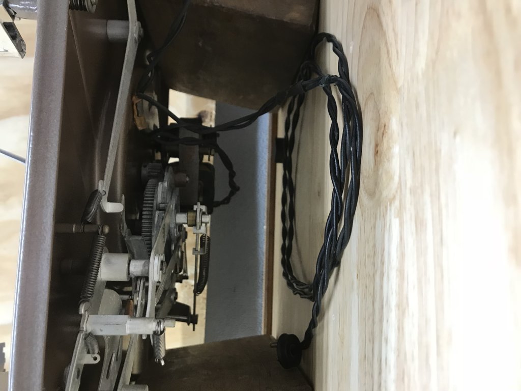

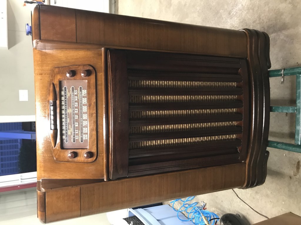

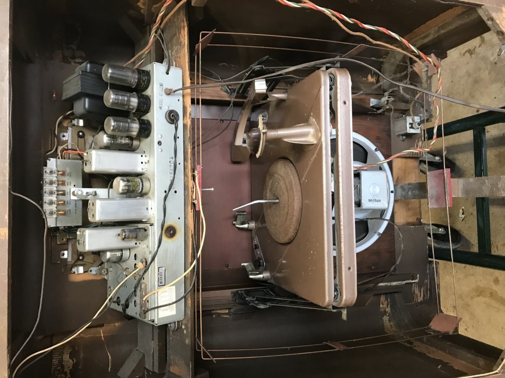

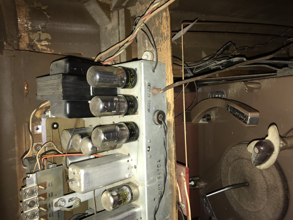

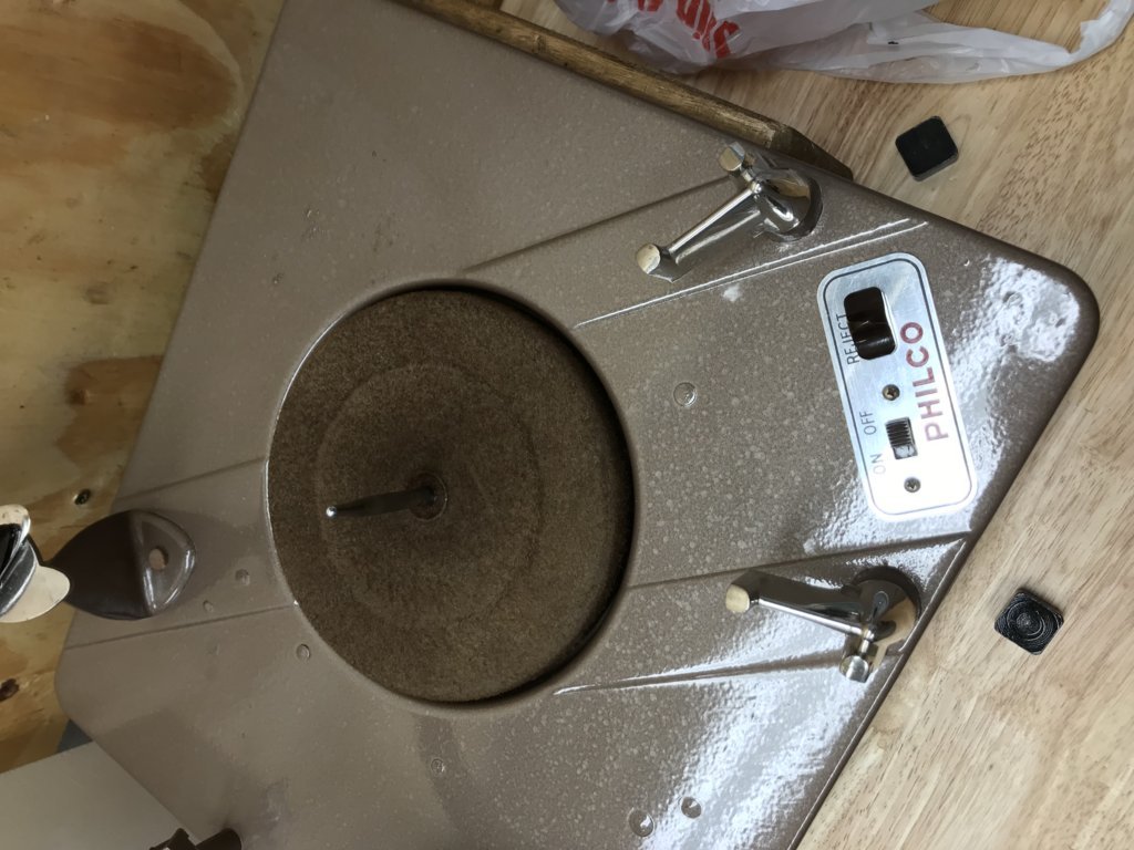

As they say on other forums I've been on, "without pictures it didn't happen", so I guess I post some pictures. So I plunged in this week and disassembled the 47-1230 and found someone has been in it before and didn't do such a hot job. First I noticed the original back is long gone and someone had the wiring stuck in the grooves with thumb tacks. The main chassis was missing two mounting screws and the other two were loose. Does anyone know where I can get those screws? They look to be some cross between a lag screw and a machine screw.

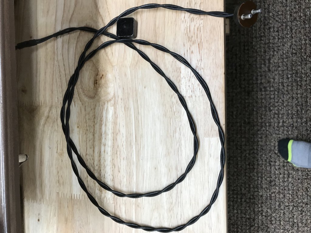

I took the chassis, speaker and phonograph down to my work shop and started looking at the chassis first. I checked for any bare wires or possible dead shorts and then removed the rotten power cord and rigged up a temporary cord. I plugged in the speaker and plugged  in the power cord and waited to see if anything was going to smoke. Everything seemed ok, so I switched it on. A few of the tubes came on and a few didn't. I could get a few pops or cracks out of the speaker when I moved the tuner and had the volume up, so I think this is viable. I disconnected the power and using the link Terry supplied I got the schematic and proceeded to look the circuitry over and compared it to the schematic.
Someone has definitely been into it as a couple of items were not per the schematic and some not to snuff wiring has been added. I then went to work identifying all of the caps and resistors and placed an order for all of them and plan to replace pretty much all of it and according to the schematic.

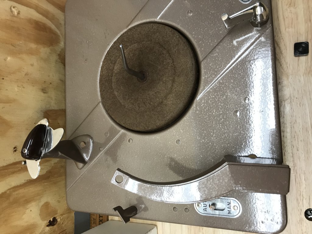

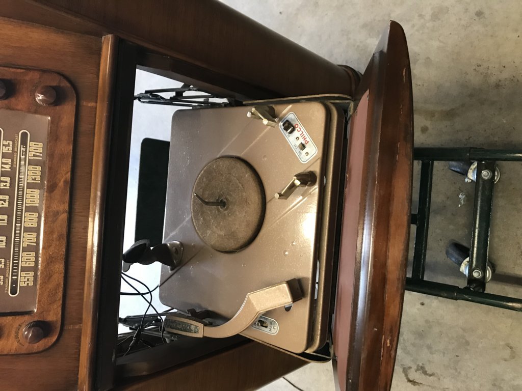

Today, while I am waiting for the parts, I disassembled the phonograph completely, cleaned, lubricated and polished everything and reassembled it. I cleaned and tested the motor while it was out and it was good. When I got it all back together and hooked it up to power tonight everything worked beautifully. Now I just need to convert the head as the original was pretty much in pieces. I'm going to look at "The Voice of Music' tonight to see about converting it.
The phonograph turned out great for a 71 year old set and with only a few tiny bits of paint bubbling (rust) and some pits on the chrome, I'm very happy with it. Even the wiring cleaned up nice. I don't want it new, I want it functional and nice for a 71 year old antique. Anyway, here are the photos I promised. I took a ton of them, but won't bore you with all of them, just some. I have no idea why they are sideways. Icon_sad

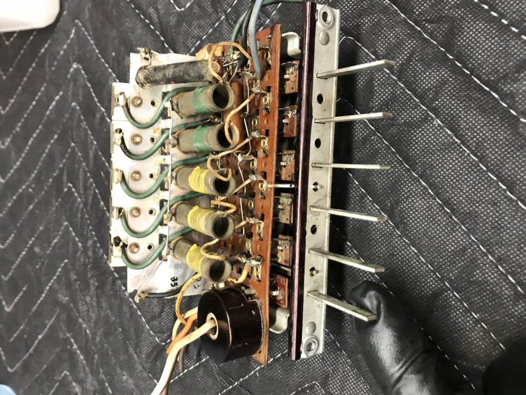

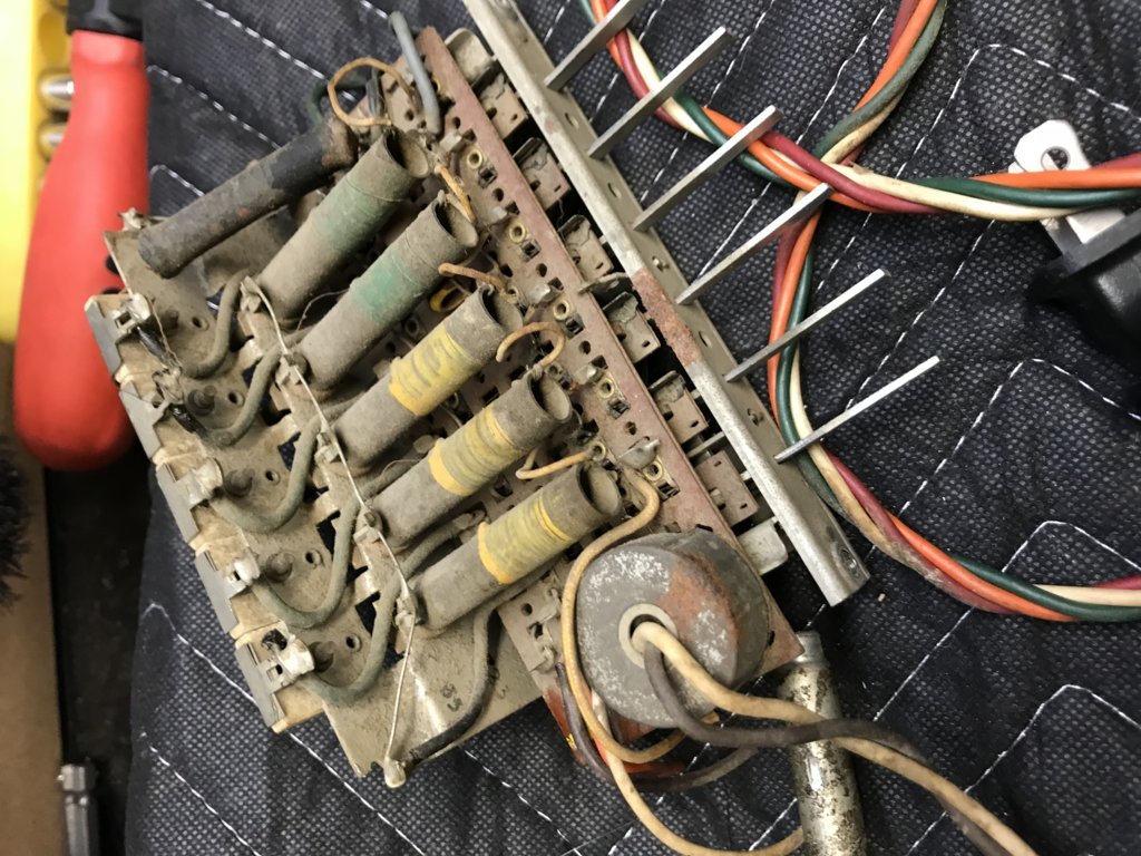

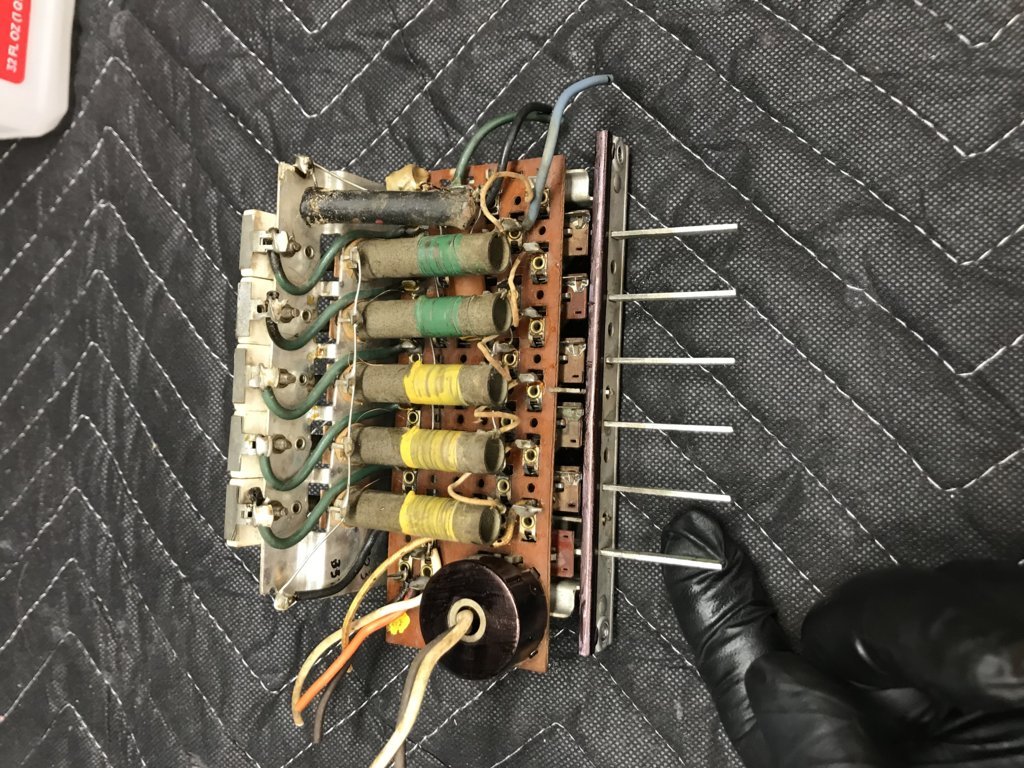

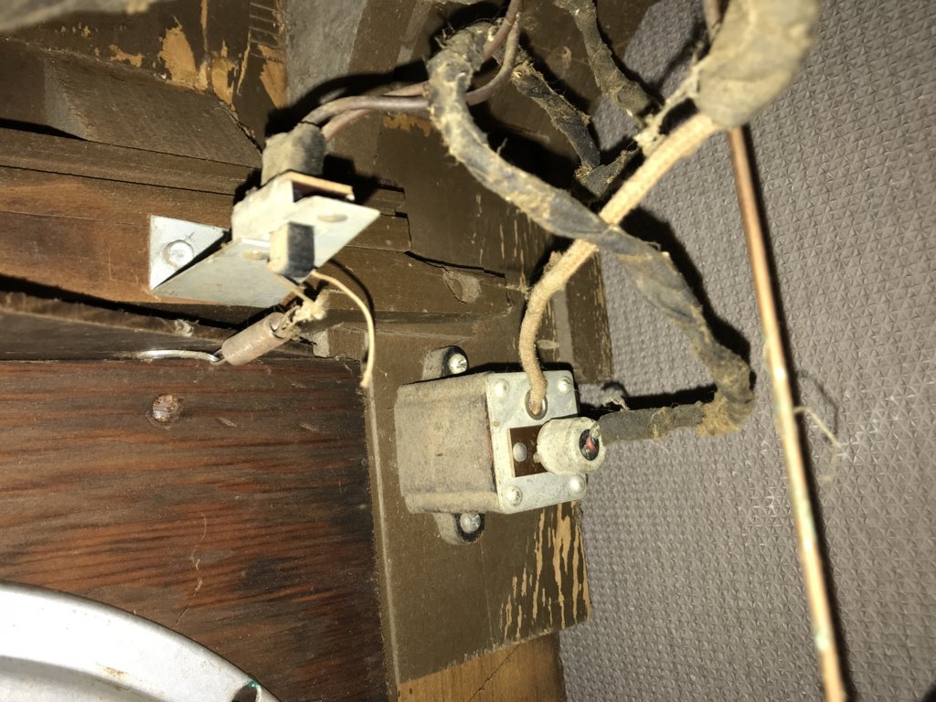

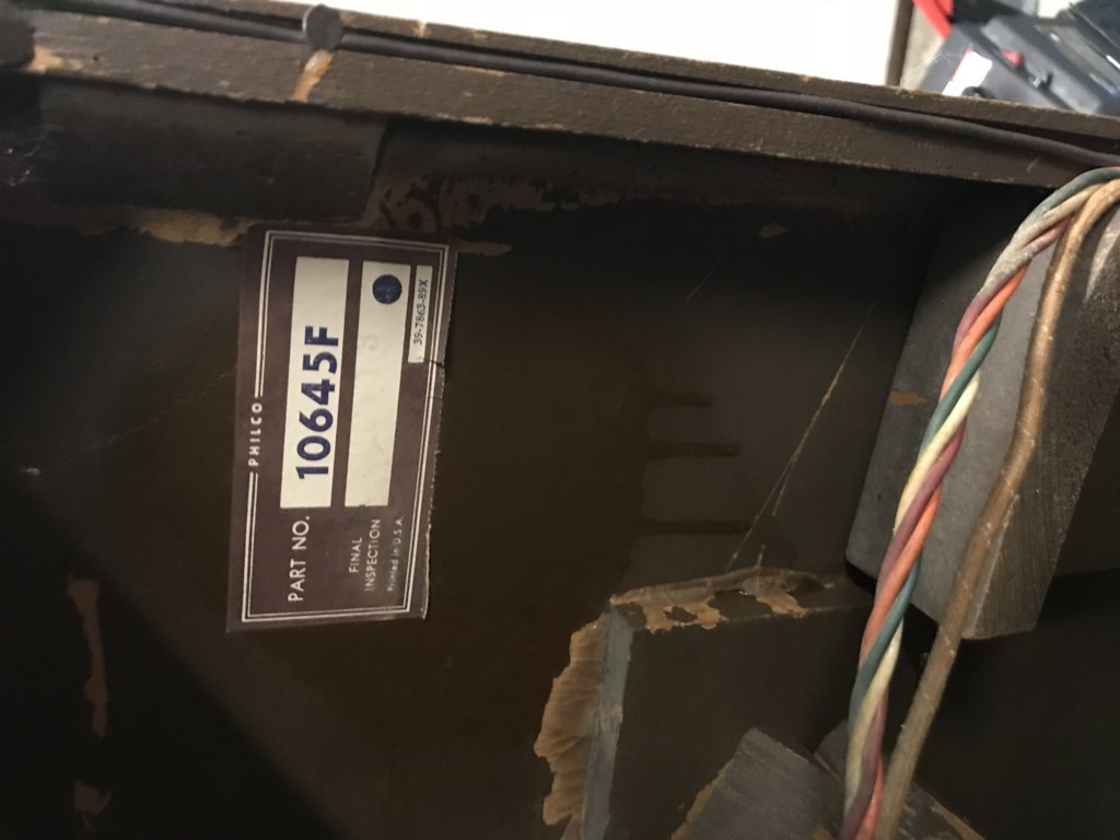

Also, I noticed when I powered it up, one of the panel lights is burned out. I want to just go ahead and replace both panel lights and the door light. I know several were not on and once I cleaned them all up I saw some separated/broken filaments. Here are a few more pics of what I discovered when I took it apart.

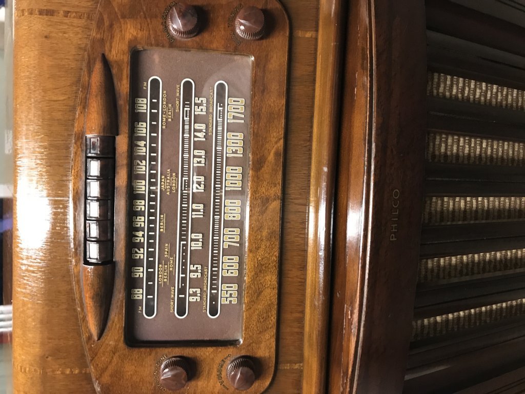

Here is the phonograph all freshly restored to its former glory. I need to still convert the head assembly, thus it is not on it. I added a weight to the arm for testing purposes and it worked beautifully. Icon_angel Next up is the main chassis once all my pieces come in. And a shot as it currently sits. Icon_confused

Oh, I did get the push button section cleaned up today and the mechanical's working well. Before I started none of the button arms/switches would stay engaged except the phono. Looks and works good now, at least mechanically. Electrically will is yet unknown. I also cleaned up the speaker today and that turned out pretty nice as well.

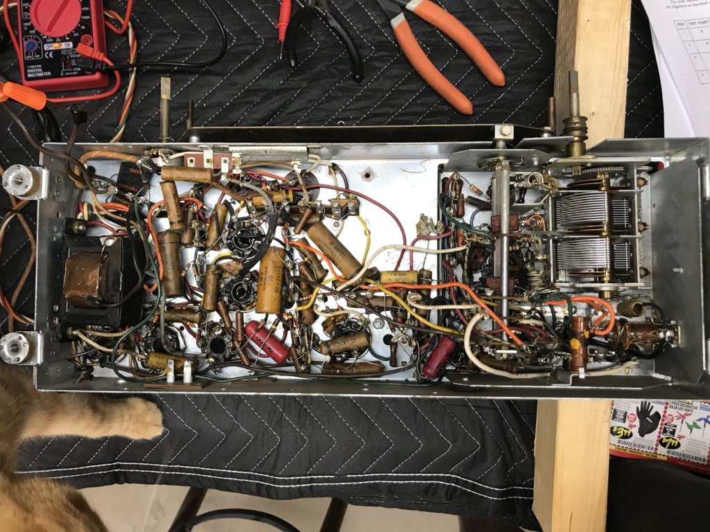

So I've been working feverishly over the last week and a half or so restoring the main chassis. I got replacement caps and resistors from the folks up in Canada and also some parts from Radiodaze. Tonight I ordered new tubes from Bob in Ohio. Right now I have successfully replaced every cap and resistor in section 1,2 & 3. I'm starting section 4 tonight. I decided to just replace everything vs. testing each piece, that way I know everything is new in there. I make sure to test the new part before and after installing it, so I think it should be fine. Probably by the time the tubes get here I'll be ready to start testing and checking under power. I'll post some pictures of the finished chassis once I get it completed.
