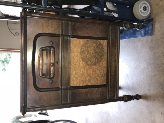

As mentioned last night in my Philco 47-1230 restoration thread, i happened upon this 1929 R-32 Victor radio. I saw it sitting over in a corner with stuff sitting on top. They were asking $200 but since it was the last day of the sale I got it for $75. Once the Philco is completed in a few weeks I'm going to tackle the Victor. I'm very stoked about this one since it was made the same year as the famous Stock Market crash. It might have belonged to a wealthy person that lost everything and committed suicide, or maybe a wealthy fellow who had his money buried and could afford to buy it. Anyway other than an attempt from someone to put a new power cord in it it looks all original and complete, less the back. Below are some photos I took yesterday before I wiped the outside down with Murphy's oil soap. It's actually very nice for its age.

Very nice! I finished restoring my mom and dad’s 40-180 and have now decided to tackle my old Victor RE 45 that has been sitting in our family room for years not working.
You may want to clean the cabinet with Go-Jo without pumice. It’s amazing!!
The chassis of your Victor looks exactly like mine. The cabinets are similar, except mine has doors on the front and an Electrola (Phonograph) on top.

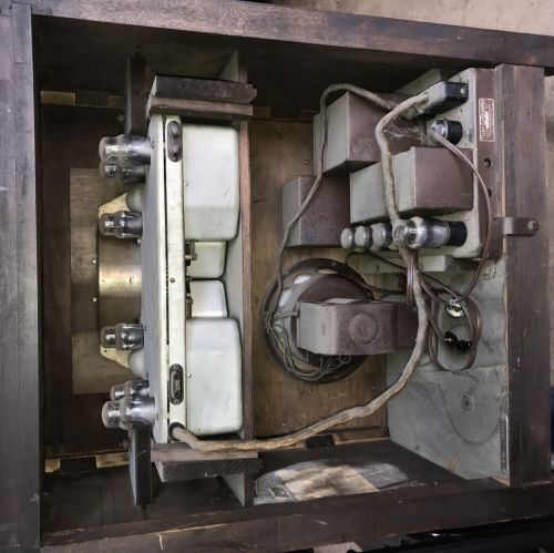

Don’t know if you’ve worked on a radio this old, but the filter capacitors reside in one of the cans on top the power and amp chassis. Get a pot, put cooking oil in it, heat with a hot plate till the tar melts and pull the old capacitors out. Interesting!!

The filter capacitors were paper by the way, not electrolytic, modern plastic film capacitors can be used as substitutes, also motor capacitors of the correct ratings. Afterward they are pretty much good for life, as long as you get replacements of a reputable brand.

You don't want to use electrolytic caps in the power supply in these early AC sets. They where designed using large foil/paper caps. Small electrolytic caps can't handle the ripple current and will short after several months of operation. Use mylars instead. Also stick pretty close to the original capacitance value. By adding more it will cause the power supply output voltage to rise. Most are rated @ 630v which is fine.
A few yrs ago I was servicing a Philco 87. Replaced all of the faulty parts and used some 4.7mf@450v electrolytics in series to replace the 2mf or so caps in the p/s. All was well and the set was my go to set for abt 4 months till I was listening to it and the volume started to drop. Dropped down to nil. Took a quick look in the back and the 80 tube was lit a bright red (not good). Upon disassembly the input cap was a dead short. Replaced w/mylars has been fine since.

You are right about the caps. Get the Solens from ARS.
Went ahead and got the Solens from ARS and replaced the electrolytic. Also got the new tube. Turned the radio on this evening and it plays quite well!!! Hope to put both chassis back in the cabinet tomorrow.

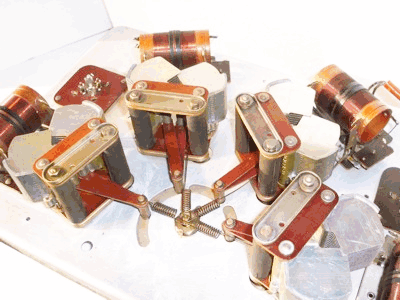

With reference to the Micro-Synchronous Tuning, I have always thought it was an effective way to allow the set to track properly and have good sensitivity and selectivity.
