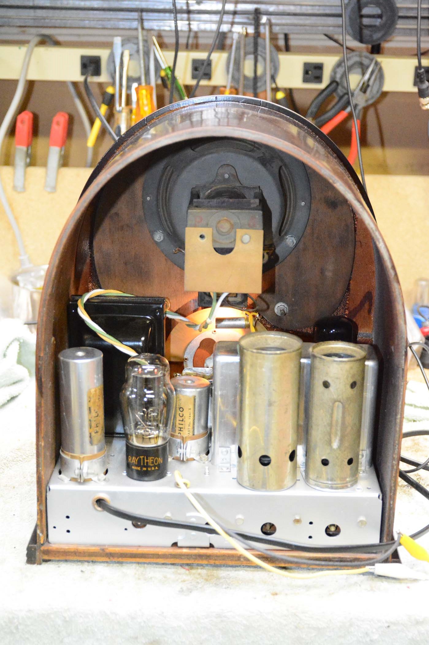

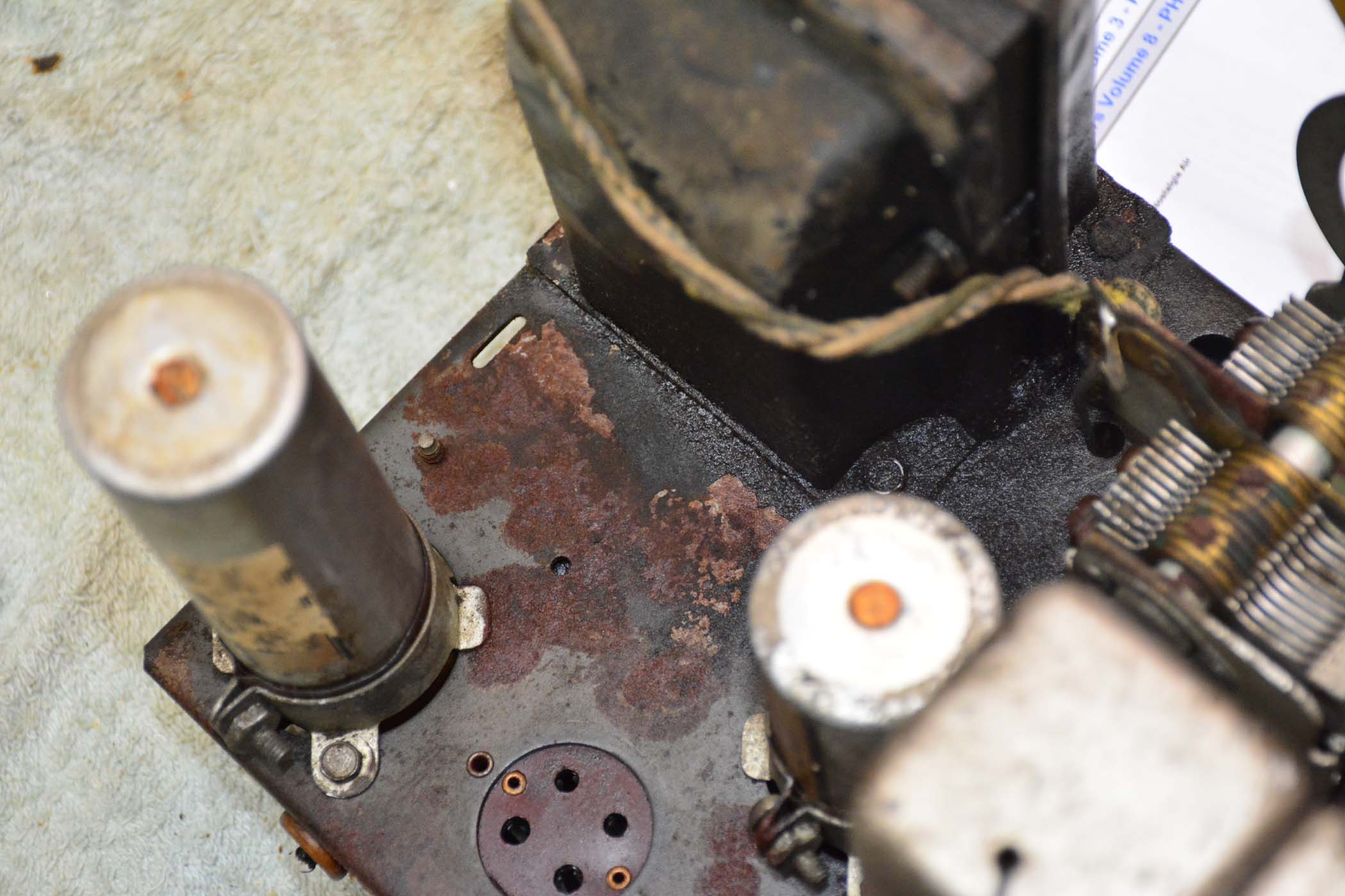

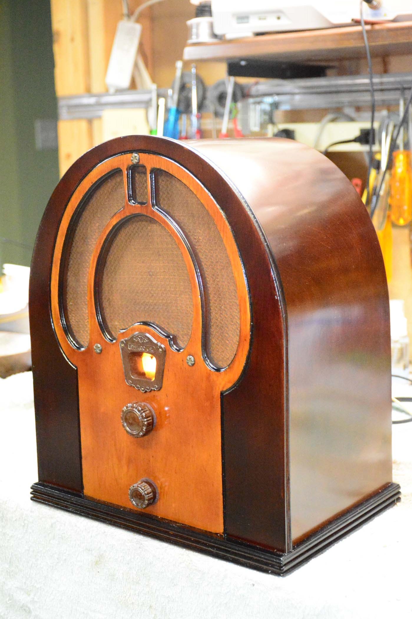

Another one saved. Picked this one up (delivered to me) for $10. Probably not even worth that. The glue holding the front panel to the curved side structure was completely broken so the cabinet had to be disassembled and re-constructed. I've done very little with toners in the past so this was a learning experience. Not a perfect job, but just ok. Interesting that areas of the sides had absorbed more stain or whatever they used originally causing a bit of a blotchy situation. I re-stuffed the caps but replaced all of the dog bones with modern resistors. Didn't think the radio warranted the work of trying to salvage the dog bones. As you can see, there was a lot of rust so I opted to take the easy route and paint.
I did the mods that Ron recommended by adding a gimmic and re-wiring the cathode circuit. The radio works ok but needs a good antenna. When aligned per the instructions, I find the sensitivity at the low end of the dial to be much lower than the high end. The instructions say to adjust the antenna trimmer at 1400 kc. Sensitivity at the low end increases greatly if I readjust the trimmer with the dial set at 600. I compromised and set the trimmer for best signal in the center of the dial. Is this typical or is there a problem somewhere? Does the gimmic cap affect this? Ron, your experience please! This radio had the attachment on the 1st detector tube socket for a shield. I could find no photos of an 80 with that shield. I put one on anyway.
I miss AGC on this radio!

I am impressed I generally have not had sets with chassis that clean. Very nice job got rid the rust and the case looks nice as well. I hope you play it even though it may not be a super sounding set.
I would have it in my collection anytime.

Thanks guys. A painted chassis certainly is not like original but it looks good to the average person. This set is not a collectors item, so it's the average person that I'm appealing to in my minimal collection.

Hey, this thing doesn't perform all that badly! It picks up most of the stations that my Scott 16A does. Have to adjust the volume for each station, but they are all there. Using the same long wire antenna (200 feet long) with a tiny bit of isolation (1K ohm) for each radio. Also have the Scott 16 hooked up to the same antenna. Fairly impressive for a 4 tube radio.
