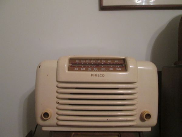

Was gifted a
Philco 48-145 set on the way to Kutztown. Got a chance to play with it and it's a surprising good player. Someone had recapped it so all there was to was hook up some batteries to it. Yes it's a 1 1/2v farm set. Low current design 200ma for the filaments and abt 6ma for the HV. At 6ma (abt what a 6 transistor uses) the B batteries should last a long time maybe + 30hrs. Not sure how long the A batteries will go. Good sensitivity and w/it's 6"spkr sound great. No hum and ac line interference.
Got some parts coming to build a battery box so they can be fitted into the back of the radio.

I usually run those sorts of sets off an AC power supply, I have two vintage Electro brand ones from the 1940s-50s with the battery sockets, but you could probably build a better one with modern parts and some salvaged transformers, such as a razor outlet transformer for the B supply, and a low voltage one for the A. I'm not familiar with this model of Philco but I have a Canadian model AC/DC version, it's a parts set, but I think it has an extra RF amplifier stage, the battery version either has that or an extra IF amplifier tube. In general I have been pretty impressed with most farm battery radios, many still work quite well even though they have not been recapped, they were obviously made for their market, which was people in semi remote locations off the power grid.
