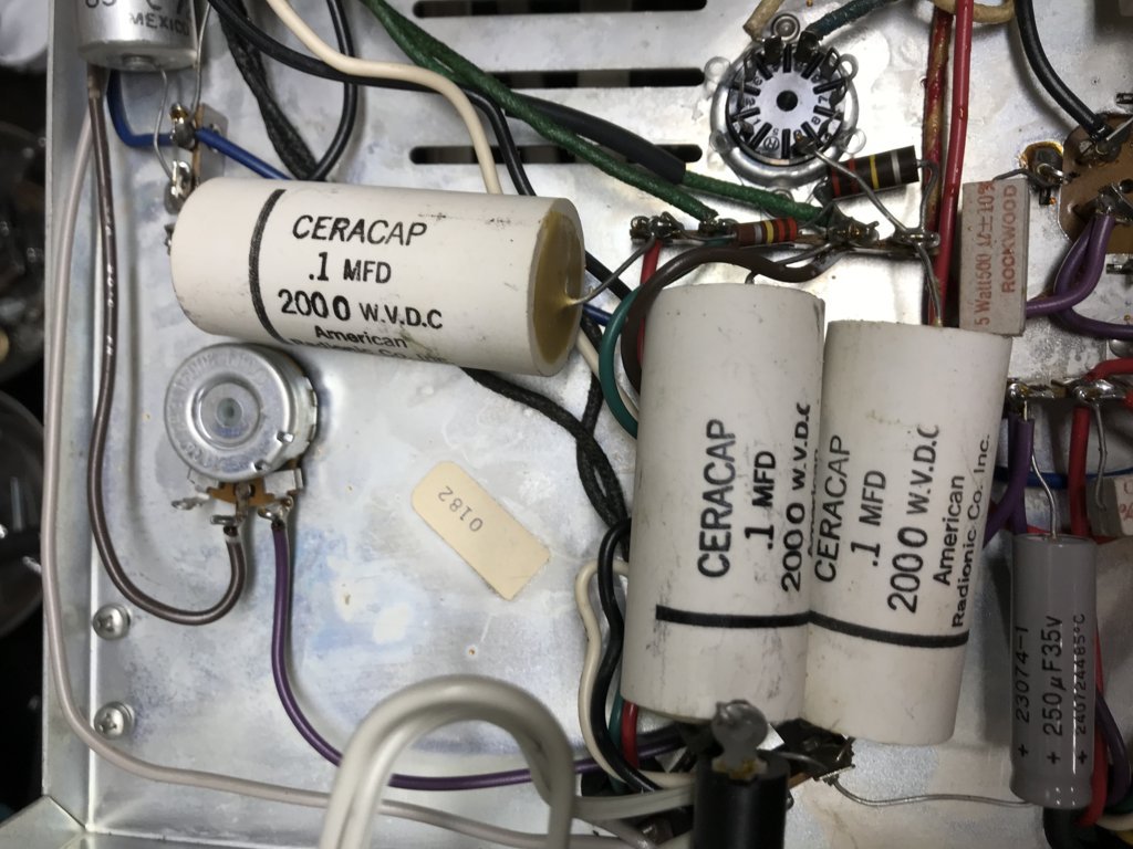

Hey guys, I'm going to recap my Eico 460 oscilloscope, and I cannot find a suitable replacement for these three .1mfd 2000 volt capacitors. Any idea of where I can get them or another way to accomplish the same thing?

Just Radios has some 0.1uF 2000v caps for $4.49 ea. See: https://www.justradios.com/cart.html and do a "Find 2000v" in your browser. its buried in the listing. You will get 2 hits on "2000v" a 1uF and a 0.1uF.
I would guess Mouser would have some as well but I did not look.

Unless they are leaking why replace? Confirmation of leaking is the in-ability to center the trace vertical/horizontal. Replacement may not have the rise time, could effect the top operating frequency.
