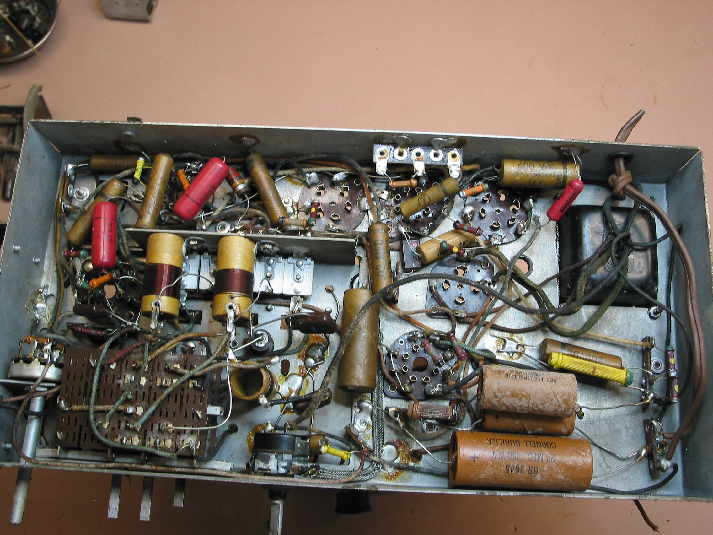

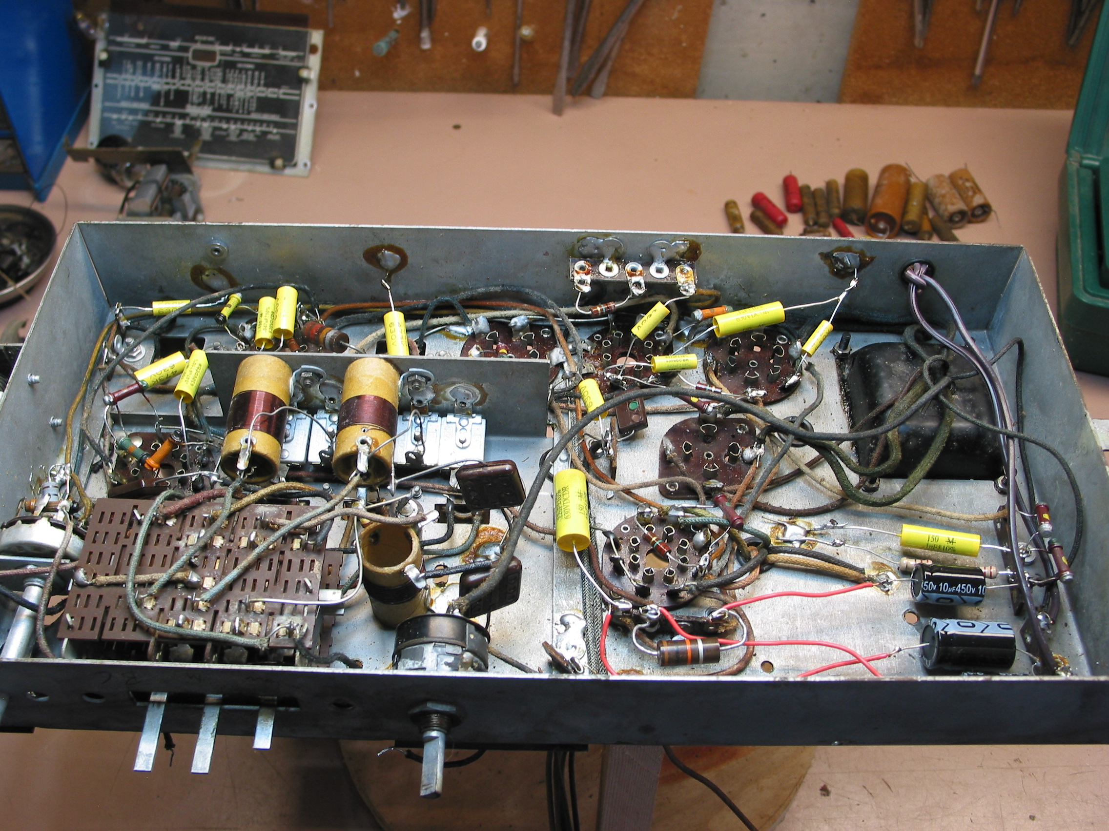

You have 2 coils to the left their is a tube socket bottom picture a red colored cap close to a orange body dog bone. Top picture red cap has been replaced by a nice new yellow cap looks like the wire from the yellow cap could be touching the wire from the orange dog bone???

three brown Caps in right corner,,,only 2 new electrolytic,,,1 yellow cap,,,but 1 brown cap missing on second tie terminal strip,,,,hope that helps

I'm sorry the after pic didn't show the third electrlytic in bottom right corner, so nothing seems wrong there, it's two 10 mf and a 22 in place of two 8's and a 16.

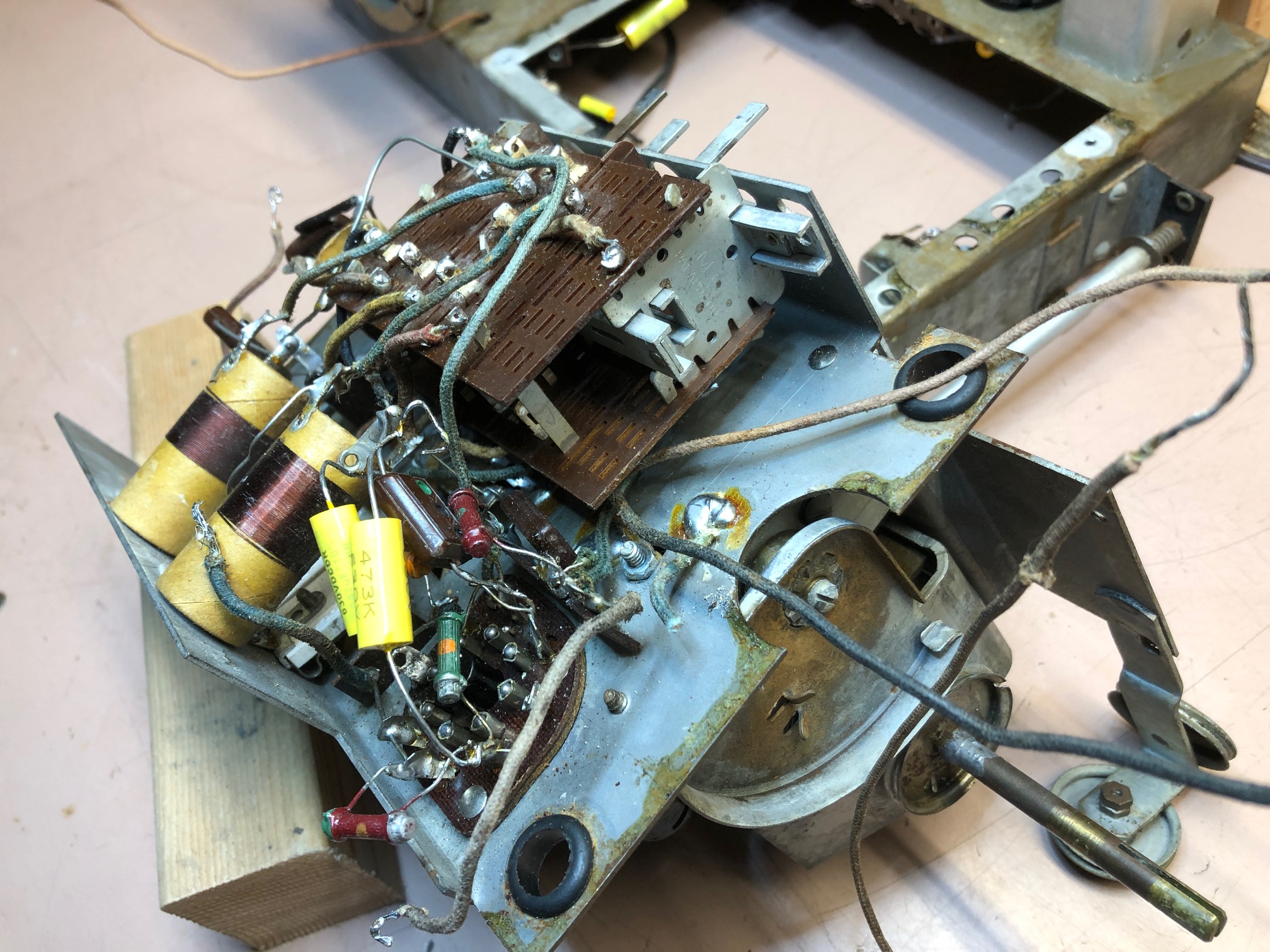

Couple of odd things, I can connect the sig gen to the antenna wire and get a faint signal through overwhelmed by the hum/buzz. The antenna var. cap is grounded on both sides. So the antenna wire has continuity with the chassis. Seems to ground somewhere in the push button band switch mechanism. Looked around in there but it's tight and involved disconnecting a lot, still don't understand that switch well. I keep thinking that somethings grounded that shouldn't be.

In the tuning cap, antenna side, there is continuity between rotor and stator. The wire attached to the stator comes from the push button band switch mechanism, the other side of the mechanism is the antenna long wire. There's a ground somewhere in the band switch mechanism. Come to think of it, there are some coils attached to that mechanism. I better look at those. I thought that I had seen continuity between rotor and stator before? Are you sure that's simply wrong? I can get an AF signal all the way through from the antenna wire and an AF all the way through the audio sections, but no signal is going through the tuner, no variance by the tuner when inputting an AF signal with the sig. gen.

The bottom left corner some of the wires look like they have been moved just a little could be with old insulation something is touching. The blue wire going around towards a brown wire near one of the 2 coils there is a spot on the brown wire with no insulation that the blue wire could be making contact.
Man, I still haven't figured this thing out. The long wire antenna is somehow grounded. It has continuity with the chassis. This is absolutely indicative of a problem, right?
The long wire antenna attaches to the underside of the band switch. There are terminals on the switch that are purposely grounded. Really hard to disassemble or get an eyeball in there to trace the circuit. It seems futile because I'm looking at things that I didn't touch, and the radio received fine before my re-capping. I've poked and prodded connections, checked coils, retraced the schematic, sketches and photos and I'm finding nothing.

The schematic for this has a lot of symbol for the band switch that makes things a bit obscure for me but I've looked at some others that show an antenna clearly going to ground. So I guess that's fine. Other radios that I have seems to have a cap keeping the antenna wire from being grounded, none of the other radios show continuity between the antenna wire and chassis.
So back to staring at this thing. I've checked the coils but I guess I'll give them another look. When I send an RF signal into the antenna wire it comes out the speaker but really low, it's not getting amplified?
