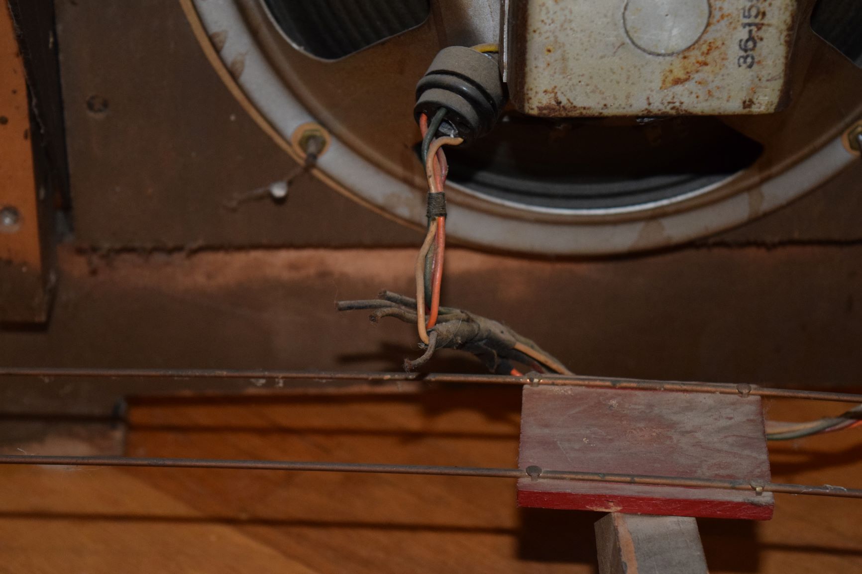

First, what is up with these speaker wires? I plan to tear this mess apart and do a much cleaner job of putting the wires together with some heatshrink for better protection, but is this a factory thing, or what? The bare ends of the wires are clearly not good, and probably dangerous.

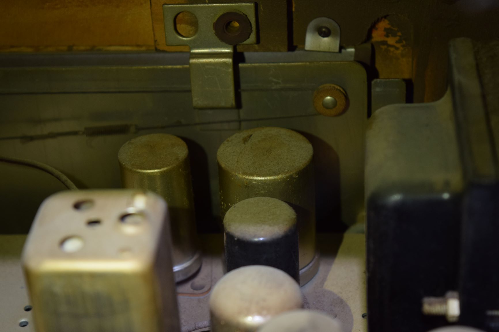

Second - here are the can caps. On the left is the 20mf cap, and the right is the 25 and 10 mf multicap. Looking at this, I feel might be hard-pressed to really fit new caps inside these cans, especially the multicap in that not too big can. I'd like to do the new guts thing and preserve the caps, but I'm not so determined that I feel it is a necessity. If I was to do this, what caps should I get that would fit in the cans and have the correct temperature rating?

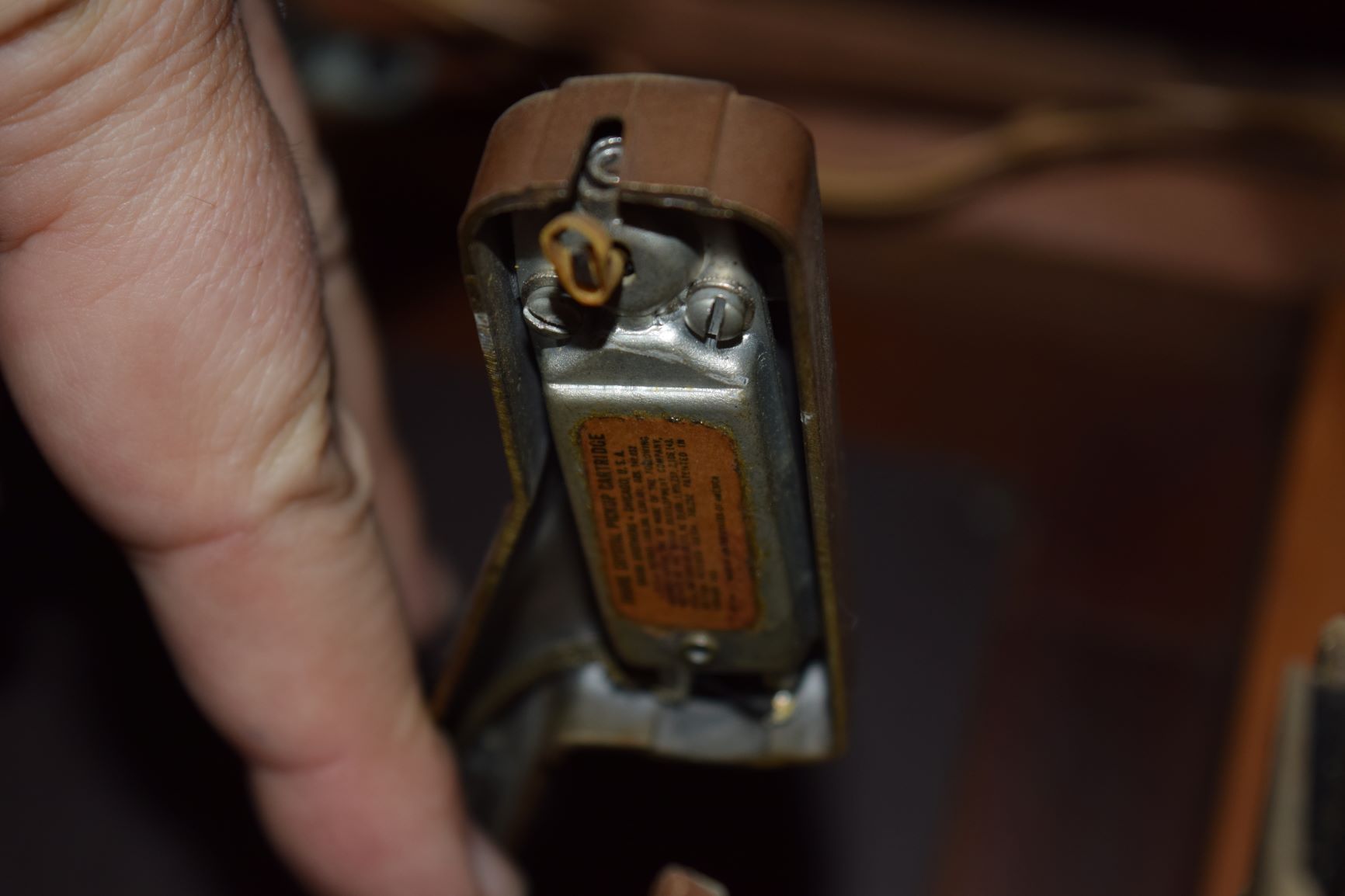

Third - here is the cartridge. As I said, it is a crystal cartridge that is shot. The rest of the player operates beautifully, though I think a little cleaning and lube would be a good idea. What can I replace this cartridge with? Is there a modern ceramic that will fit and has the right 3.0 stylus? I seem to recall a post somewhere about an Astatic jukebox cartridge that works.

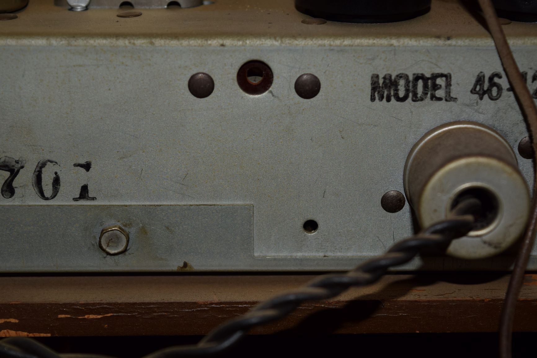

And last, just for grins - what the heck is this hole for?
I would just replace them. Two of them have HV on them (connected to the field coil) and the other two are more or less at ground potential. Radiodaze sell a good selection of colored wire.
Don't think it will be a problem. Modern caps are fairly small 10 and 22mfd aren't giant. Look for 105 deg. If you want have a look at Hayseed https://hayseedhamfest.com/pages/quote They can manufacture a new twist lock caps.
Generally The crystal cart have a pretty high output like 2-3v where the ceramic are abt a volt. It maybe be difficult to get full volume. I don't fool w/phonos much.
Methinks the diagram sez it's a test point to measure the avc volt when doing the rf and if alignment.

I don't know why it didn't occur to me to simply replace the speaker wires - of course that makes perfect sense.
I'll ponder the caps - I'm not sure if it really matters if I keep the original cans or not. It's cool to keep 'em, but does it really matter? I had a hard time imagining caps fitting in them because I'm used to the really big axial caps in Fender amps. Those Spragues take up a fair amount of real estate.

I'm playing with a couple of different cartridges for the turntable. I have a Pfanstiel 51-3, and one of those common as dirt ceramic cartridges that are on EVERY modern turntable-like-object.
The load resister for the current cartridge is 150k ohms. I probably need to change that out to a different value for a ceramic cartridge, but I'm not sure what. The volume control is the next item in the circuit, and that is a 2 meg.
Thoughts? I could always just put everything together and sub in a 2 meg pot for the load resister and adjust that until it sounds good, and then put in the closest value I can find.
