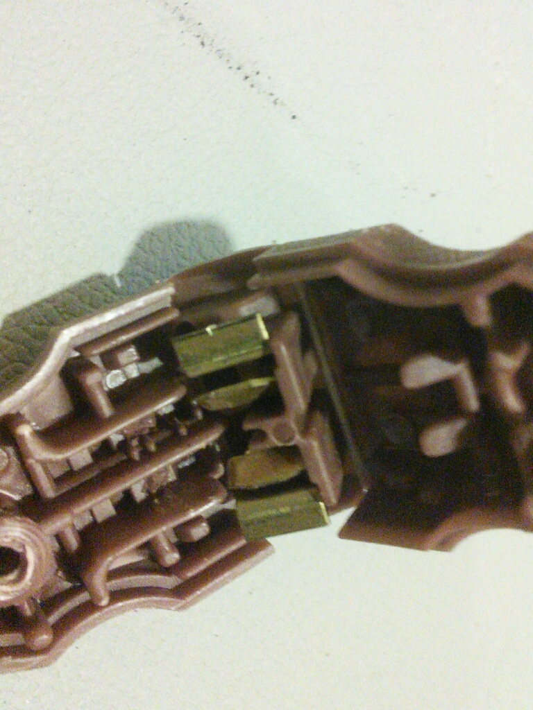

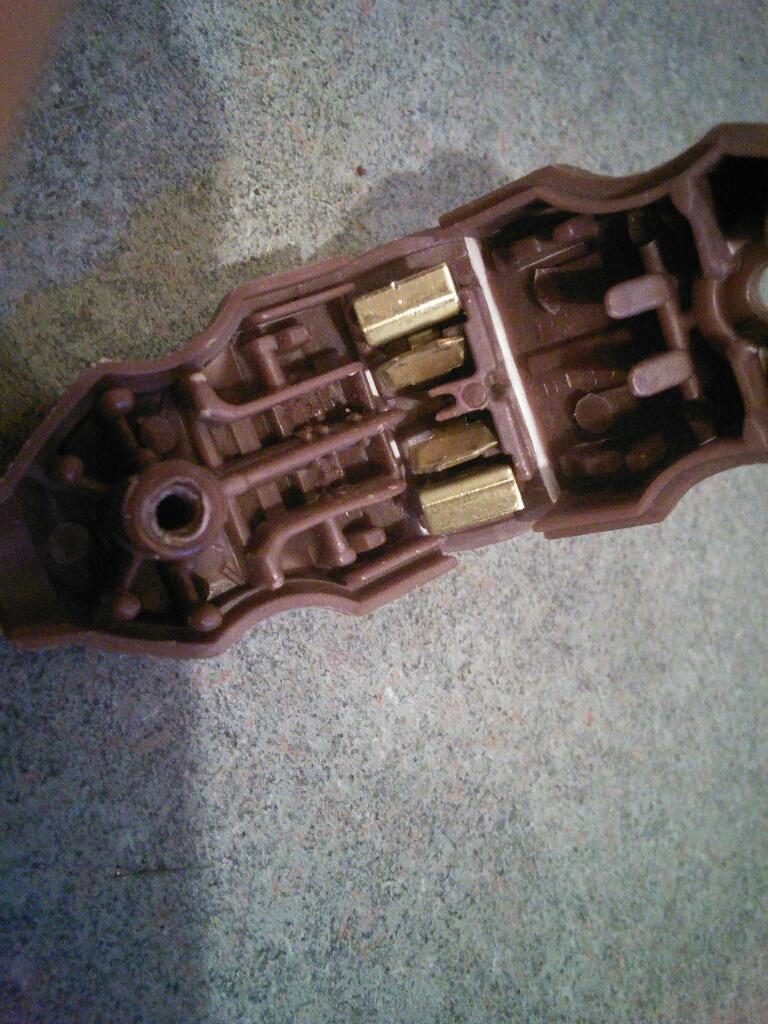

I realized it has a screw. I opened it. What I'm not sure of is how the wire gets secured.
Anyone knows these? (Even if it is not a Z plug).
The old wire all had disintegrated, so want to be able to reuse the plug.

I think the ends of the wire (possibly stripped) are clamped, one in each of the center channels, by the brass blades. The blades may even be designed to cut the insulation. You can see, at the bottom of the channels, where the plastic is slightly distorted from clamping the original wires.
