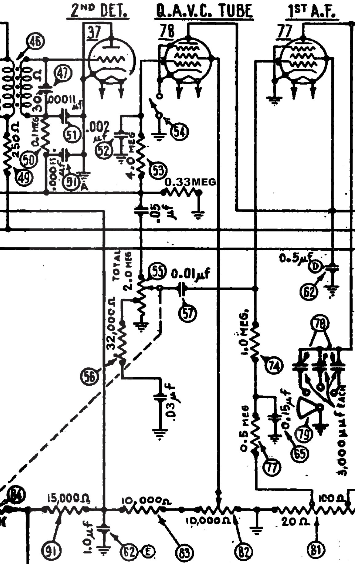

There were at least three different tone control circuits used in the early (5-band) model 16.
First version:

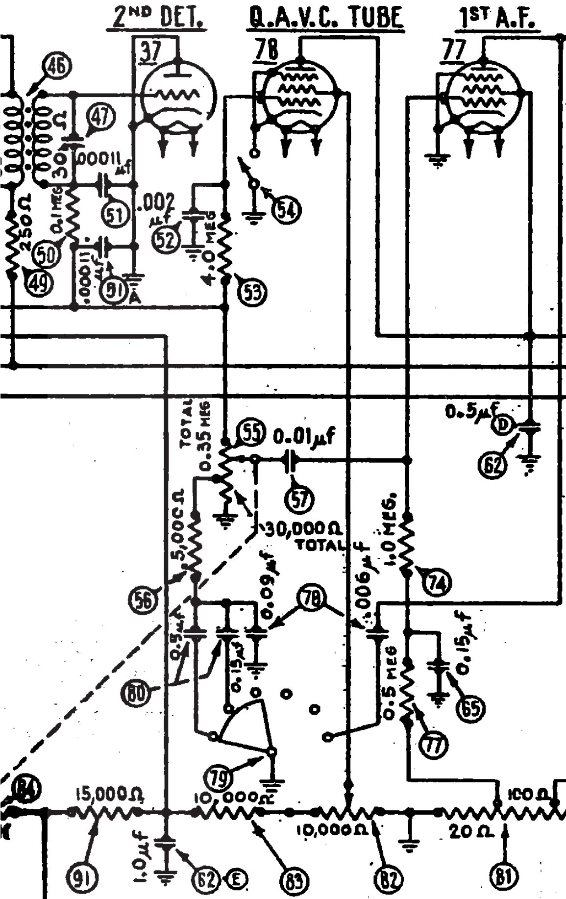

This version was apparently not used very long, and was replaced with this second version:

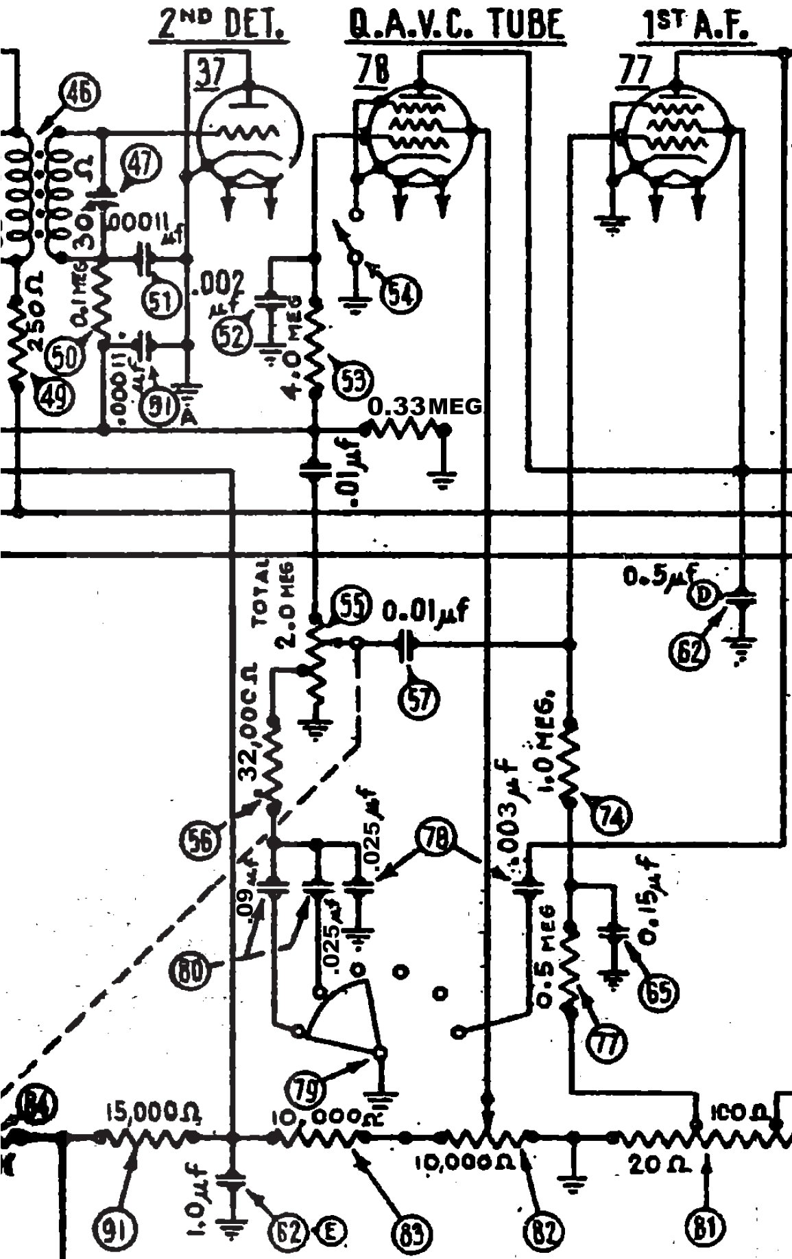

This one is commonly found in 5-band 16 sets, and adds a dual .025 uF bakelite block while removing the 0.5 and 0.15 uF metal can caps.
Late in production of the 5-band 16, the circuit was changed to this third version, using three .033 uF caps inside the control and eliminating the .006 uF cap between tone control and plate of the 1st AF tube:
This last version was carried over into production of the 4-band 16 (codes 125, 126, 127).
There may have been another variation in between the "second version" and "third version" posted above; I don't remember right now.

My tone control (30-4069) is represented in the second picture using the .09 and.003 caps and the dual .025 external bakelite block. I replaced the caps with exact uf#s and 2 of the 3 positions sound the same.. I didnt see a modification page in my package
