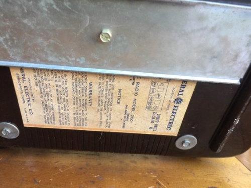

This may be unrelated to my problem with reception. Many of these style GE's have a metal piece secured to the bottom of the set by one chassis screw. There is not one on mine, so what did this piece do other than create a bigger hazard if chassis was hot?
Would it have anything to do with reception?
see this one...
https://www.etsy.com/listing/603275248/v...osQAvD_BwE
Just thinking.............................I could not get the particular image to show in the post scroll through the pics for this set.

Just posting to see if anyone knows about the large metal piece on the bottom of the case? I updated my last post so perhaps it is a mystery or perhaps it just is fading down the list a bit.

I can not get the picture of the bottom to show.

Maybe the plate is being used as a ground plane for the ant. Since it has a connection for a external ant. Just a guess!!! Would not be hard to try.

Interesting. My model 100 didn't have such a metal plate.

This is the only set in my limited time in this hobby I have seen with this plate.
