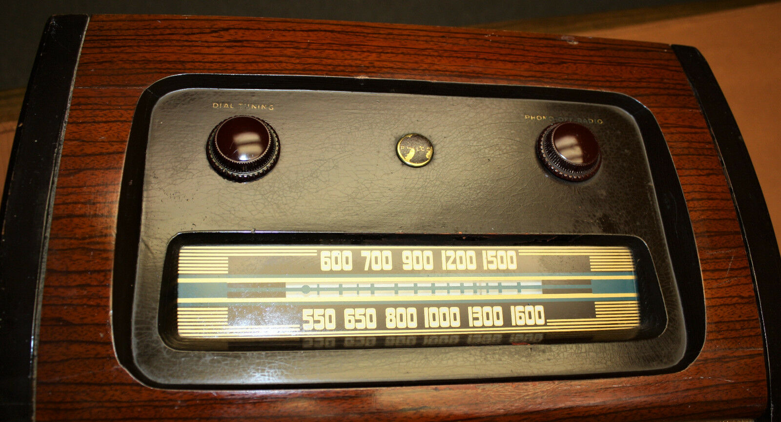

I had a 48-1201 but it was identical appearance wise to the 1946's. I had heard some of the 1948's had a metal disc replacing the decal above the dial, but I had never seen one, until just this past week when one turned up on 'the bay. I borrowed a pic from it to show what the disc looks like.
