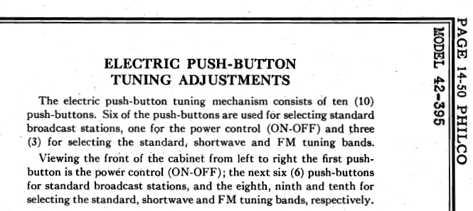

Found this today....How in the heck do you turn this thing off?
the volume knob does not "click" into any sort of OFF postition.

One of the buttons could be power switch.
Mike probably correct, my 345 T uses a pushbutton on/off.
Try the far left button, should be it unless the switch is damaged and someone by-passed it or defective.
Have fixed a few of the push button style off/on switches. The contacts burn up. Ron has a description of how to rebuild the original or I've replaced the old w/a new latching switch. Either way your looking @ killing a Saturday afternoon. Not sure if the '40 models used this set up but the '41 and '42 did. You might want to have a look at the cord to see if it has an inline switch and the internal switch is jumper.

More details on the buttons, per Rider's.
I was just too lazy yesterday to get to the basement where my 42-195 is, and I haven't turned it on for maybe a few months, but I vaguely remember one of the end buttons being the power switch. All these radios are very similar in their construct.
Yep. Its the button on the left.

The 1940 models did not use a pushbutton power switch, and I don't think that the 1941 sets did either, but most of the 1942 models did, including my 42-327. I'm not sure if it's that the contacts burn out so much as the switch just physically wears out with use, and since it was sort of a unique design compared to 95% of the other sets out there, many owners bypassed the switch in various ways, some worse then others. Before you ask about the escutcheon, unfortunately it's a ten pushbutton model, so there is no direct replacement, but yours does not look too bad for an original, so if it rubs on the pushbuttons I would just adjust the slot accordingly.

Arran,  at least some of the 41 models used the push button.  My 41-295 made in 1940 had a push button switch that was replaced with a rotary  stuck in the push button hole.  I was able to repair the old switch.

My tech guy will be getting it in a couple weeks, to do a full electrical restore. But yes, the button on the far left turns it off. I'm not going to be playing it any more until it's restored. Pretty good buzz going on right now.
