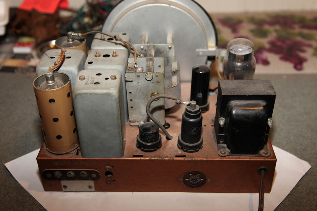

So today I put it on the bench and looked inside.

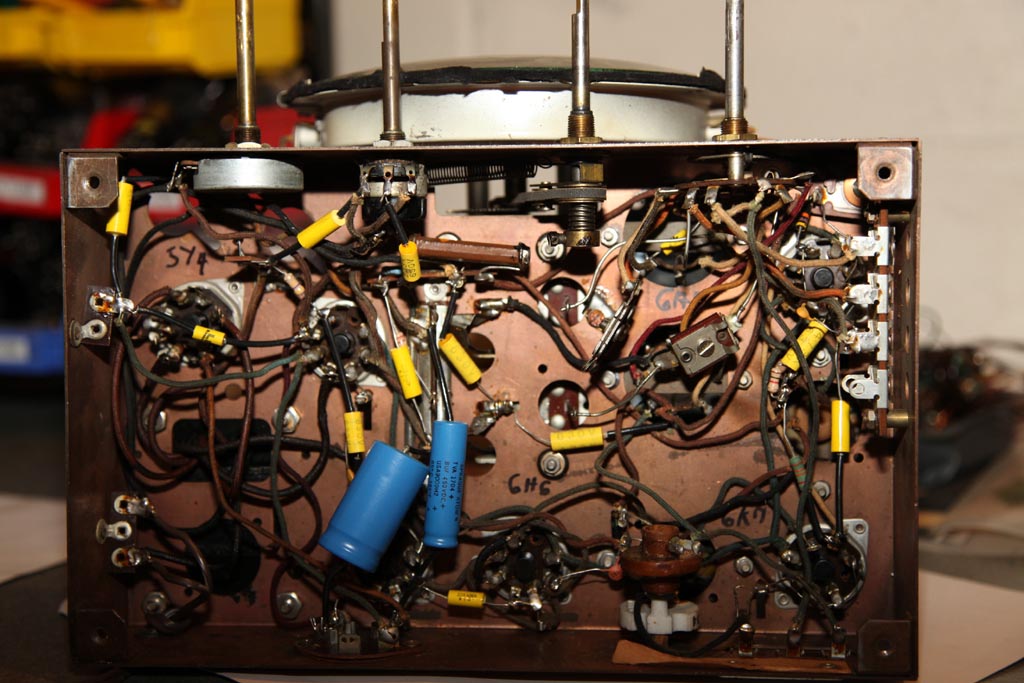

The radio has been previously restored.
I cannot say anything bad, the soldering is good and the parts are good too.
But no re-stuffing, and the electrolytics were not salvaged, even if only for looks which is what I would prefer.

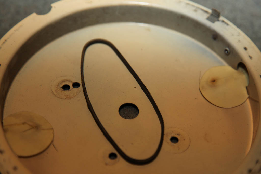

The reason I opened it up is the tuning mechanism does not rotate; according to the seller it froze.
Well, upon opening I realized it did not freeze: it is exact same problem I had this winter with my dad's Westinghouse I restored 7 years ago: the belt simply assumed a narrow oval shape.
Now that I opened it up, I will clean the tuning cap, the glass, order and replace the belt and should it work, give it an alignment.

Today the belt came, got installed and the mechanism seems to function fine.Tomorrow I will try to test the tubes and to power up.

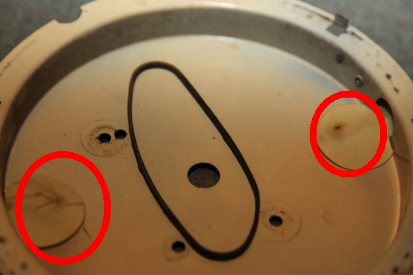

You might want to replace those translucent dial light shields, they keep the black dial from getting scorch marks. You can make a new pair from a window blind slat or a milk jug. Since you have the originals you can use them as a template.
Mark Oppat makes the ones he sells from window blind slats.
John
Possible, but they are in one piece and look OK.
Actually the whole thing is surprisingly clean (the previous restoration likely did not touch the tuning assembly).

Next time you have a rubber belt that's stretched, try this. Put the belt in boiling water for 30 seconds or so. It will return to its original shape and be useable again.
I read this over on audiokarma and it works!
How long it will last, I don't know.
Ed,
Possible it might work. As you said, not clear for how long. Spending $8 to make sure I won't have to do the full disassembly (which is what is required to change the belt) again in the nearest 8 years is a small price to pay.
This is not a stretched rubber belt; it is rubber-impregnated belt that froze into an oval shape due to long period of disuse.

Quote:Possible, but they are in one piece and look OK.
In the picture it looked like they might have been scorched or cracked, but pictures can be deceiving and that might be dirt I was seeing.
John
They are a bit. But I have just powered it up and the illumination looks just fine.
