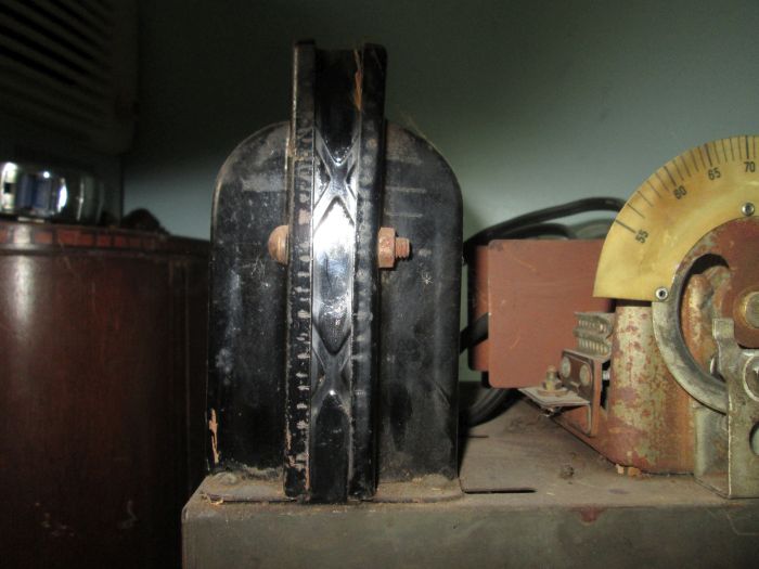

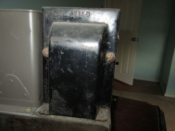

Will a model 84(part# 5266) transformer work in a model 52 (part #32-7180)  thanks,carl
No wrong heater voltage.
I also suspect it is a smaller transformer.
Any substitutes you can suggest???? Thanks carl

ron,it is an American model, from the Hartford ct area.are there any under chassis photos available.i will forward a photo of mine. thanks,carl
The issue you have is that you need a transformer that has a 2.5v filament winding to power most of the tubes on this chassis. By late '32 and onward manufactures were using up their older 2.5v tube and started in on using the new 6.3v tubes. These were more compatible with auto applications and other battery powered uses.
The transformers w/a 2.5v winding are still available but are some what limited and expensive. Some folks will retube the chassis w/6v tubes and use a 6v transformer but on your set there isn't a simple replacement for the 47 tube. It would require a socket change to a 6 pin socket and a 42 tube.
As for substitutes, if you can obtain a known good one, a power transformer from a model 50 or 51 will work as a substitute.
